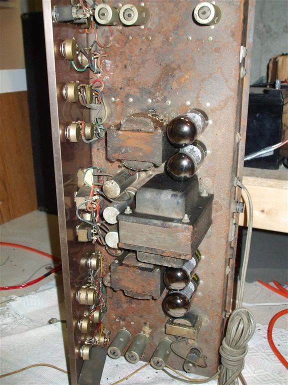

Attached are a few pics of my poor old amp.

Looks like a fun project. The power transformer looks usable, and the choke looks good, but those output transformers look pretty dicey (and small). They're easily replaceable though. Nothing wrong with 12AX7's.
You'll need to determine the power supply voltages so you can find a suitable schematic. Remove all the tubes and map the transformer output voltages. At the very least you will find 1 high voltage winding (3-400 volts) and one or two 6.3 volt windings for the tube heaters. Those will be easy to find by following the wires from the tube socket heater pins. Check the datasheet tube pinouts.

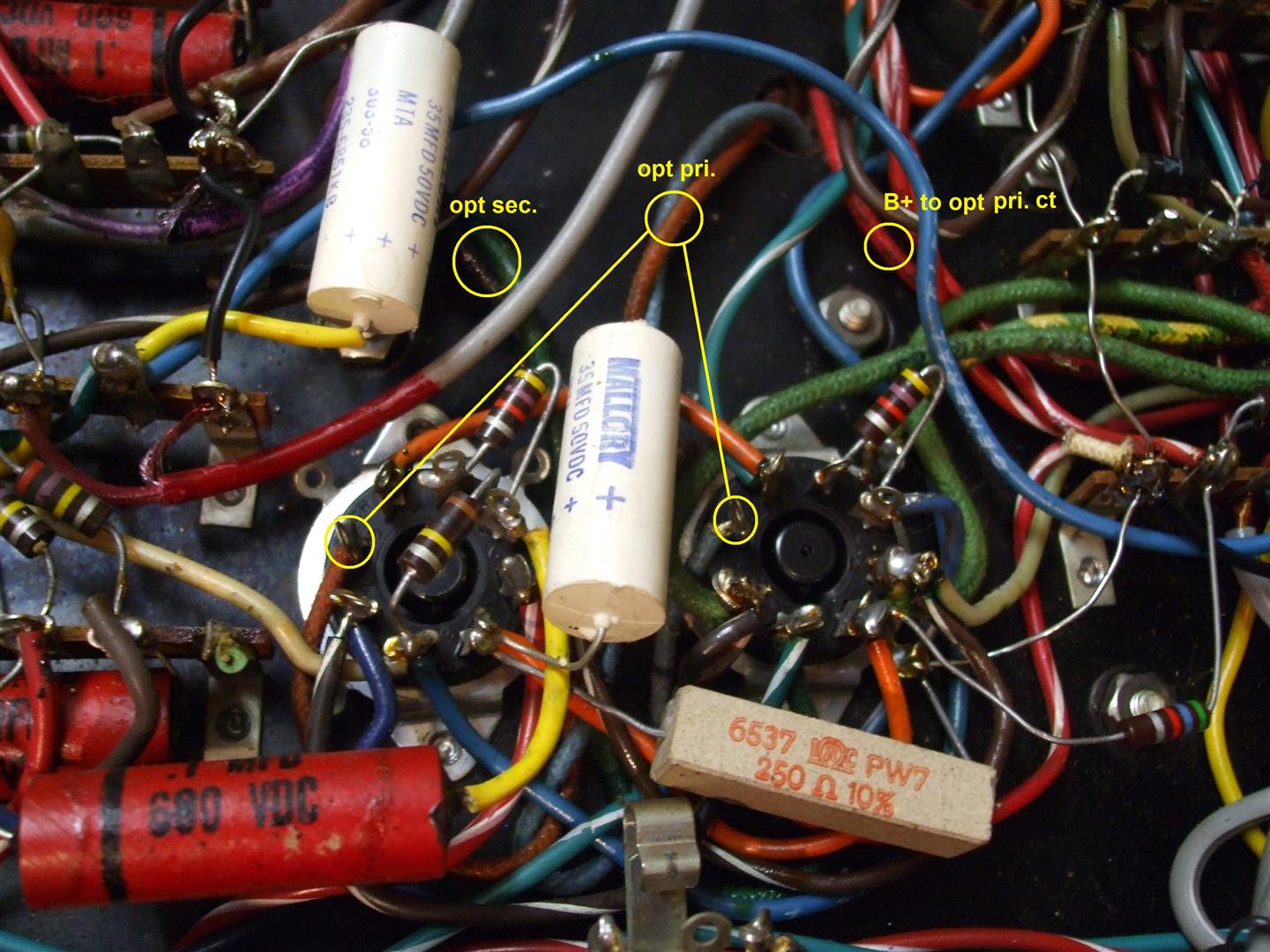

Oh I forgot to ask. The choke? Are you refering to the small transformer near the bottom of the image of the top of the chassis? It has 4 wires. It's connected to the reverb circuit I believe. At least one of it's wires it connected directly to one of the wires to/from the spring box. Another to HV B+. It almost looks as if it modulates the B+ supply to/from a driver tube with the signal from the spring box.
EDIT - What's happening to my posts? They are there then they're not? There was a post before this one but it vanished. 😵
EDIT - OK it's back. And here's another pic of the output sockets. I labeled the output transformer as 'opt', the primary as 'pri', the secondary as 'sec', and center tap as 'ct'.

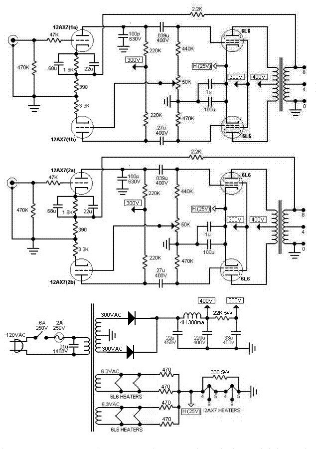

It looks like that design is using the 12AX7 heaters as cathode loads for the 6L6, it is unusual to do it that way these days, with all the different 6L6 variants who knows where the bias will end up at.

It wasn't so much the cathode load. I sort of follow that. It's the pins themselfs. 4, 5, and 9. In that schematic they are all tied together. lol. One has to assume there's heaters off 4 and 5 but 9 should be left disconnected. They just drew it wrong is all.
Actually, that's just the way heaters are drawn on schematics. The inverted V ( /\ ) represents the actual heater filaments, so they are actually all connected to the pin numbers shown, not shorted together. For some 12v tubes (like 12AX7), they provide a "center tap" on the filament so you can use 2x 6.3 v to power it. If you disregard the center tap (pin 9) you will need 12.6 volts, instead of 6.3.
That was my take as well, the two 12ax7's are then in series needing 25v across them which appears to be provided by the 6l6 cathode bias, or is the cathode bias

The output transformers only have 5 wires. 3 in, 2 out. In that close-up of the bottom of the chassis I circled them. They are not ultra linear.

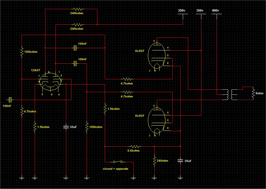

Attached is what I think I've correctly copied from the 6800. Ignore the voltages for now. I just threw in some valuse. I haven't measured it yet.

Hmmm... you may have some of the connections not quite right as the 12ax7 pin 7 grid is getting a signal only from its own plate. I suspect you have the plates switched. If you change those around then you have a paraphase splitter which though not in vogue in current hi-fi circles has been used to good effect an many console amps so you may not need to change much at all other than updating some components.
I am getting a little confused with the cathodes there but it may be that they are taking feedback from the cathode of one of the output tubes to the cathode of one of the input tubes. You might want to change that and use feedback from the secondary of the output transformer instead to help compensate for transformer limitations so long as you are not trying for tremendous bass response which could overload things trying to correct for bass limitations.
hmm... that can't be feedback from the output cathodes as they are sharing a cathode resistor.
