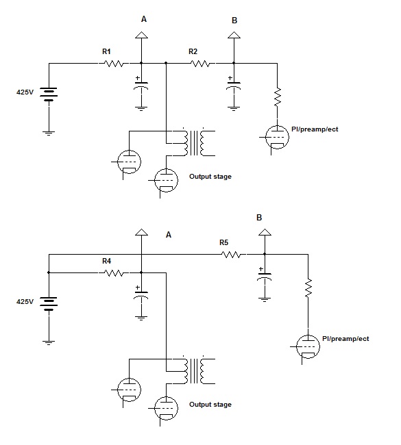

I have another question. It's common to see a power supply with voltages tapped at poins along a string of series resistors R1 and R2.
In the top schematic:
The power stage draws current at point A, this also causes a voltage drop at point B. If B is powering the preamp/PI then wouldn't that cause unwanted voltage sag in the audio and drive signals?
In the bottom schematic:
The preamp sources it's voltage directly from B+. Other then some sag in the power transformer, wouldn't this create a more stable voltage to the preamp/PI?
I already know it would. I'm just wondering why so many amplifier designs use the top schematic with the series resistors.
attachment.php
The series of RC networks (RCRC in your schematic) drops the voltage for subsequent tubes, with a gain in reduced ripple.
Each additional RC stage filters the DC and cuts the amount of AC ripple remaining from rectification.
Pre-amp stages are more sensitive to this ripple and tend to amplify it (as a general rule, there are some tube topologies that have good PSRR {power supply rejection ratio} and are not as subject to this.).

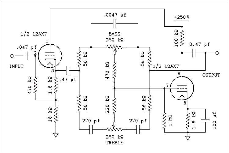

Maybe Figure 14 here will help with gain problems.
Yes I am. When I start pushing the amp hard I can hear the bass begin garble things up. I noted this position on the volume knob. I dropped the cathode resistor to a 160ohm an played the same song at the same volume position and there was little to no distortion. The cathode capacitor doesn't have any effect at low volume but as the amp is turned up it has a greater effect of reducing distortion then without it. Another 35uf in parallel with the first had about the same effect as lowering the resistor but it seemed that deap bass suffered as a result. Tone wise, at high volume, it sounds better with 160ohm/35uf then with 270/70uf. Make sense?
Thanks for the tone schematics! That's exactly what I'm trying to accomplish. Figure 14 -They used a cathode follower like a buffer to drive the tone stack then a voltage amp to get the gain back up? Looks good. But there's one problem. All those components! 😱 It's just asking to make noise. I think I'll build one and try it though. It's easy to do with this 2-channel sand box I have here. I can make a change to one channel and immediately compare it to the other channel. 😀
I needs me some a them there capasa-taters with a side a zisters.

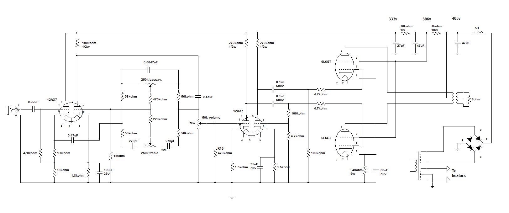

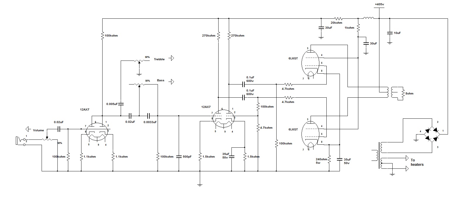

I built this tone circuit from the link Ian sent me. I built the first triode cathode follower and ran that straight into my PI. Much less noise compared to the 12ax7 parallel preamp I had which I did try as a single triode which sounded the same either way. Once I listened awhile, and was convinced this cathode follower was working, I added the tone stack and the second half of the 12ax7. Well, welcome back noise! And more so then I had before. The input to the second triode hears any interference from every component, lead, wire, and pot in the tone circuit. I'm going to try moving the volume pot over to the second triode's output. At least that should stop the idle noise and bring up the s/n ratio. I know the PI and output stages are silent.
attachment.php

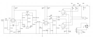

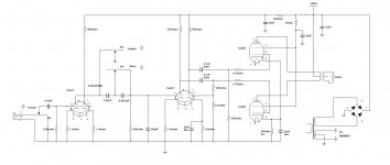

Q1: Which filament option is best and why? Size/Weight/Cost not a factor.
1-Filament power from main power transformer. AC
2-Filament power from main power transformer. Rectified and filtered DC
2-Separate filament transformer. AC
3-Separate filament transformer. Rectified and filtered DC
Q2: Is a cathode follower inverting?
Q3: In my schematic... Adjusting the volume changes the PIs grid path to ground. Does this effect tone or quality?
Q4: Am I running way to much current on my first stage cathode follower?
How the schematic look otherwise? It sounds good and gets pretty loud before distortion sets in but it feel like there's alot more volume left after the onset of distortion. The mid-bass is the first thing to distort. High end and bass drums seems ok. Lowering the 6L6 cathode resistor from 240 to 100ohms helps but it seems like that's effecting the high end at normal volume levels. If I keep it at 240ohms but raise the capacitor from 68uf to 100uf it seems to give me the best of both worlds.
And yes, I still have to try feedback. Could this help? I drive it right into pin-8 of the first 12ax7 correct? I can't imagine why I'd want feedback running through the tone stage so it should enter after the first triode. I still have to try lowering the plate resistors to the PI but I'm worried this might reduce the gain.
