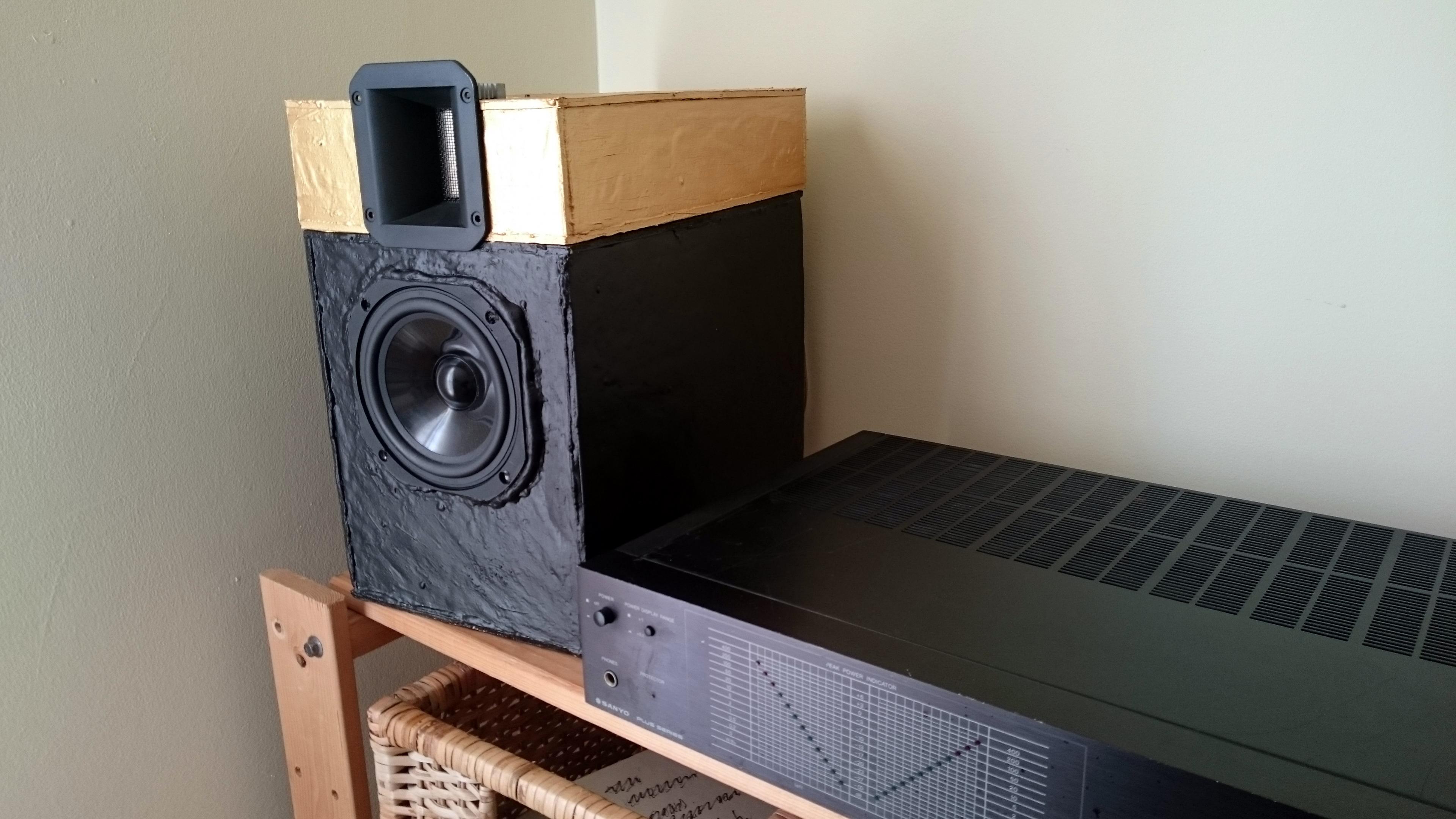

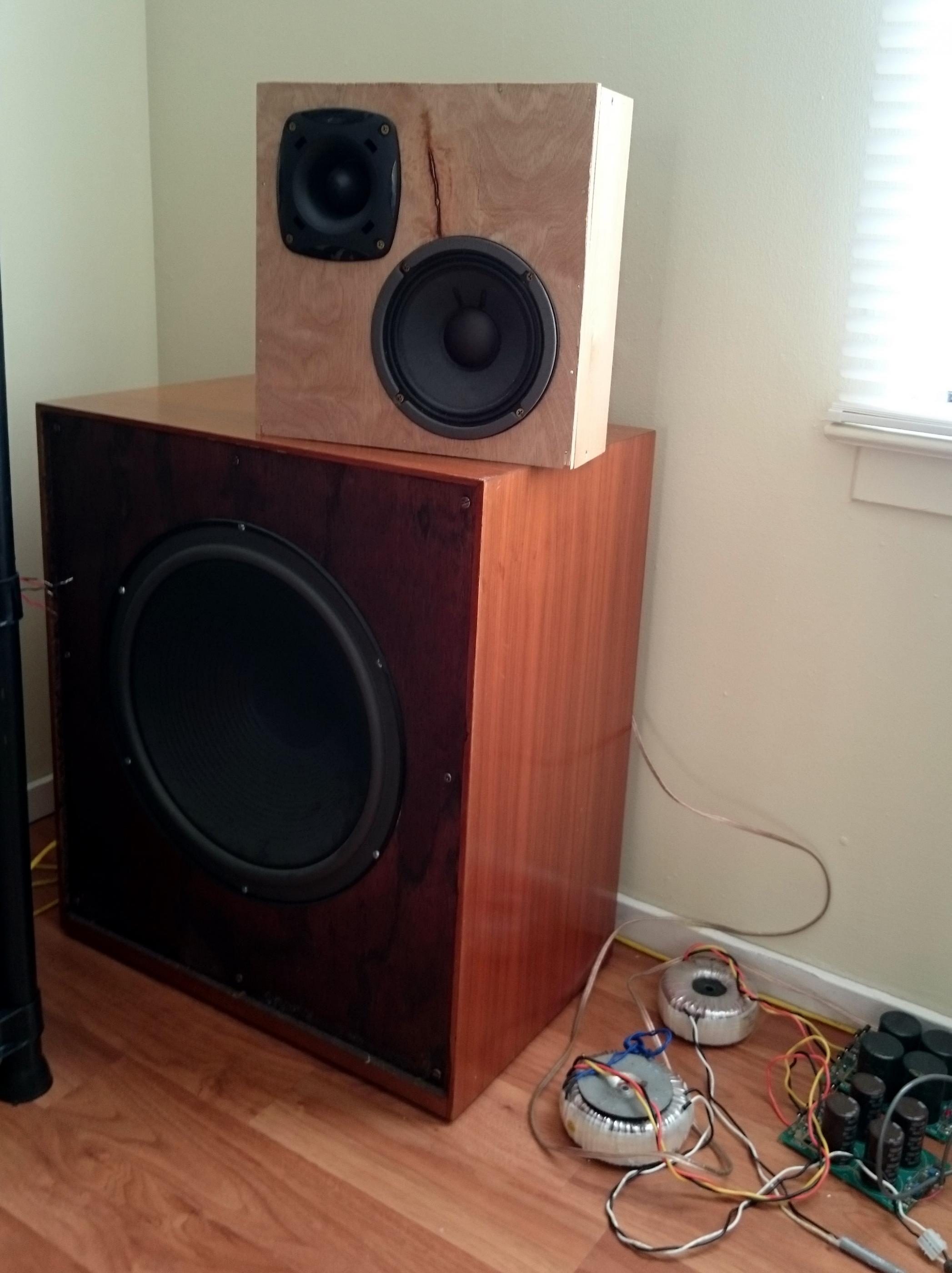

That's how i use it in three systems...
Interesting! any detail?
no, not really, its right now sitting on top of 15" closed box woofer, active B1 crossover at ~160Hz (used to be minidsp), biamp with chip amps, no passive parts except one cap for tweeter, nothing for mid! May put L-pad on tweeter, but it sounds great right now.
So all in all, one cap...!

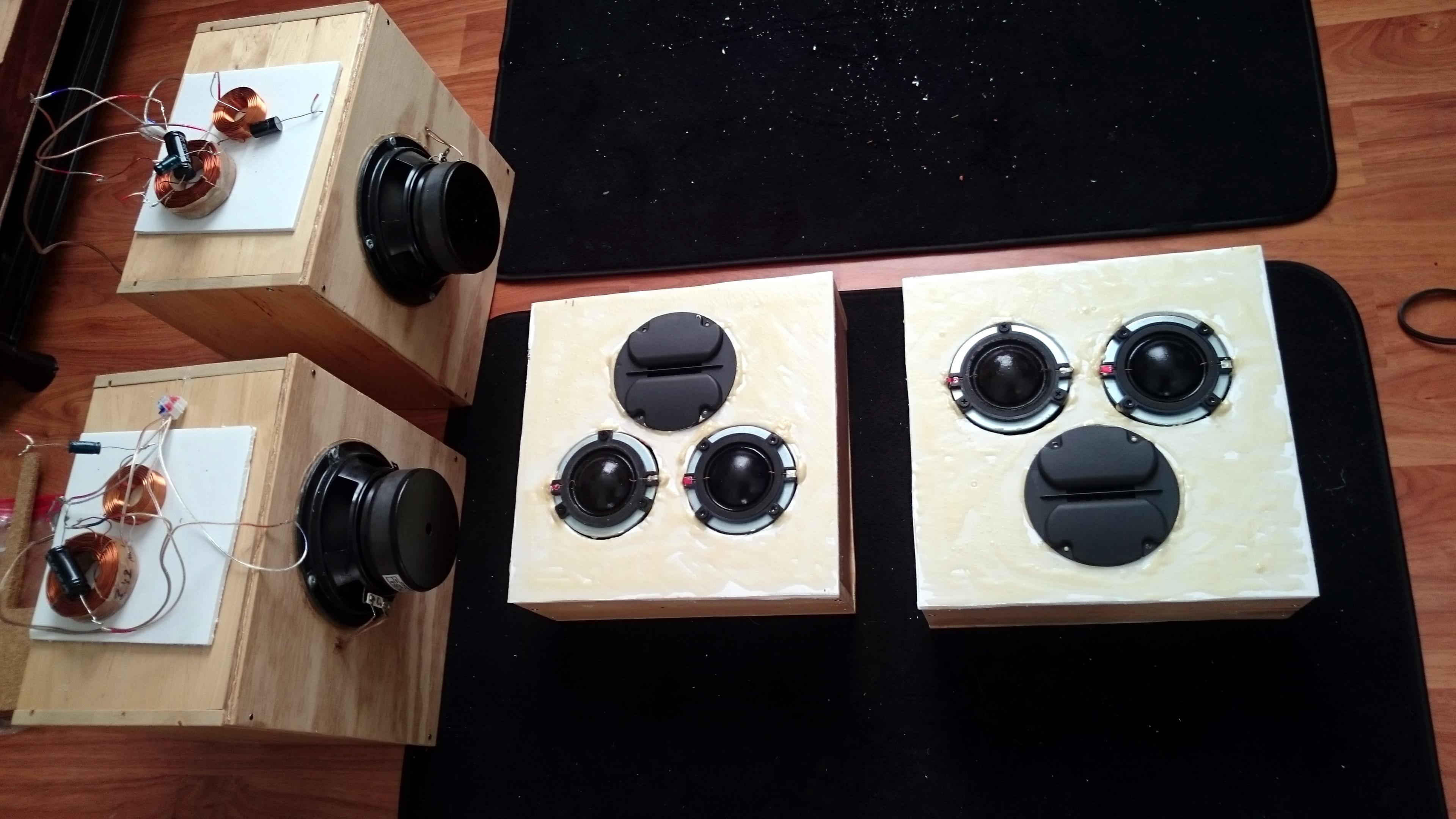

here is how it looks
it's a good thing!

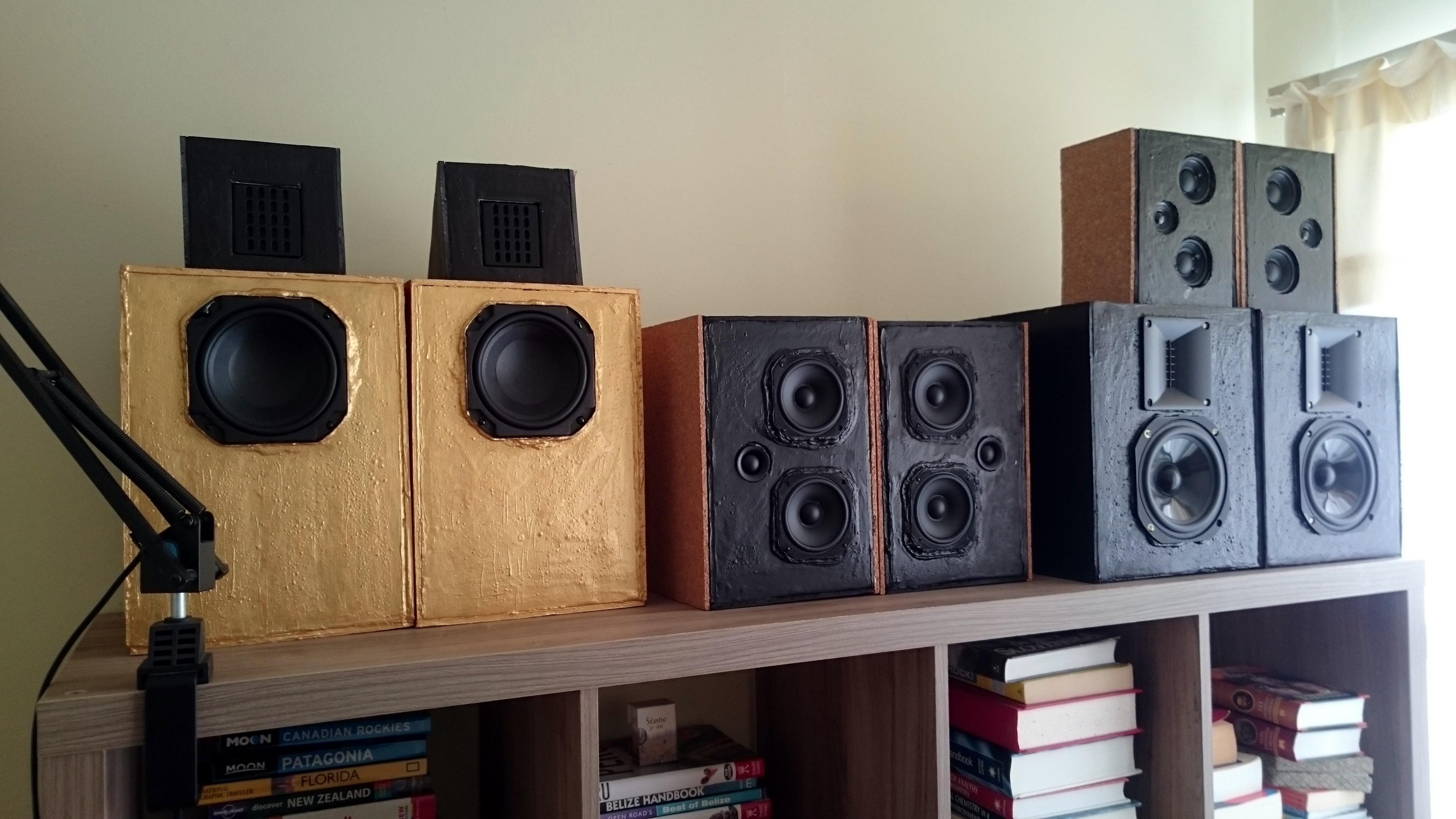

recently finished...
- 6FE200 + ST200
