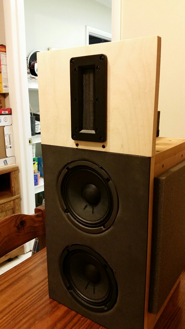

Sir, I am not really sure what you are asking about (?) The pair per side of 6fe200 are in a sealed box, with 5/6 of a partition between the drivers. Damping materials on both the inside and outside of the walls, along with acoustic absorbent in the internal space.

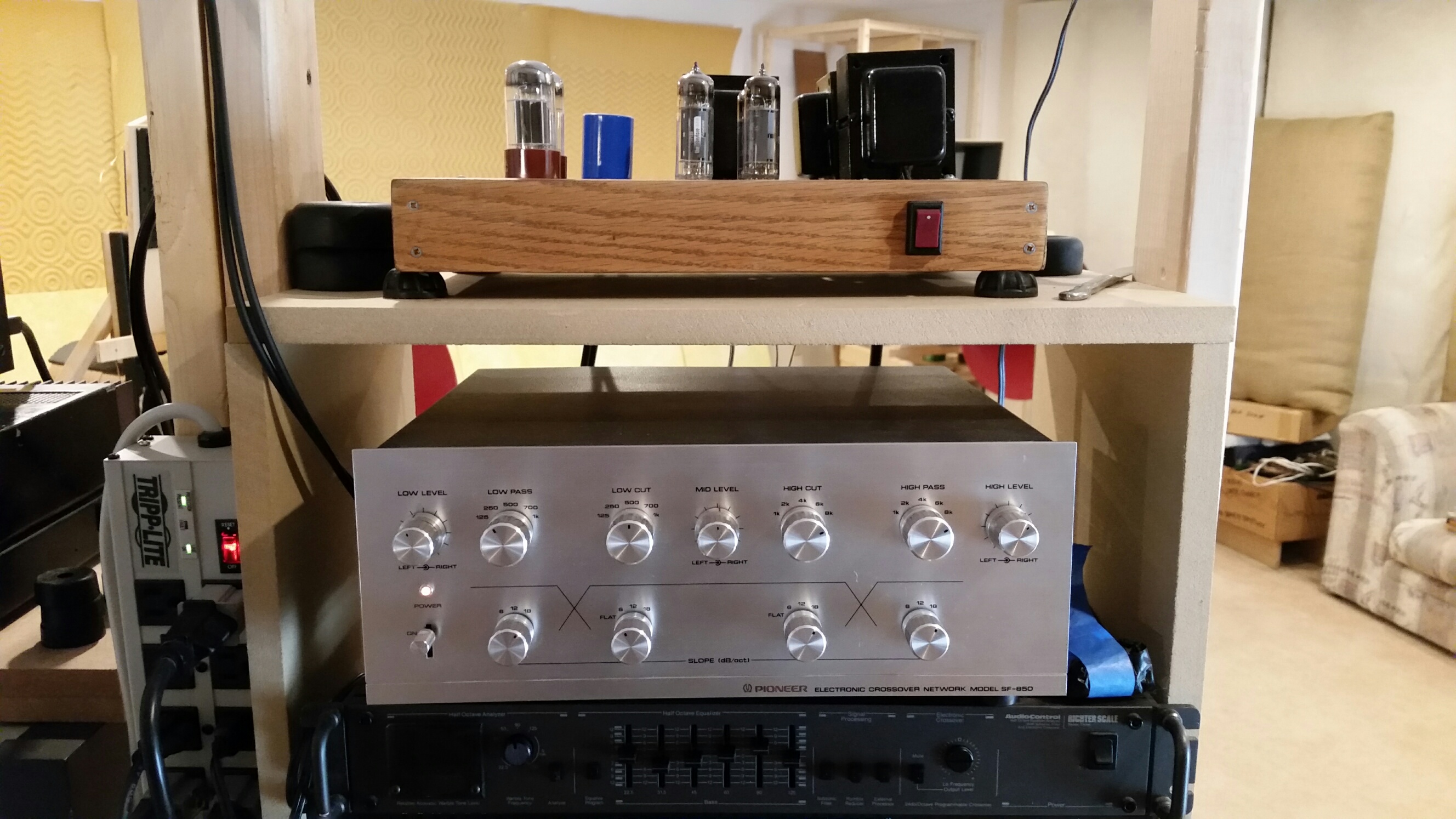

Your crossover?

The ST-200 tweeter was never intended to be considered as a replacement for the ribbon currently installed in the system. The ribbons are the Stage Accompany SA-8535 and have been in use for 17 years without even the slightest temptation to replace them. The purchase of the ST-200 was just out of curiosity to see what a cost effective device might could do. Still, to this day, however, I have not had occasion to install them in a prototype speaker project for evaluation.
The answer to your question about a crossover is the attached picture.
crossover points? slopes?
since you have the e-crossover and the seleniums, you could do us a favor and find out the best CO point/type between them (no need for a new cabinet; the bullet can sit on top of mid box)

I prefer 18db/oct slopes. I was using a 4k Hz crossover at the time I was using the 6fe200's.

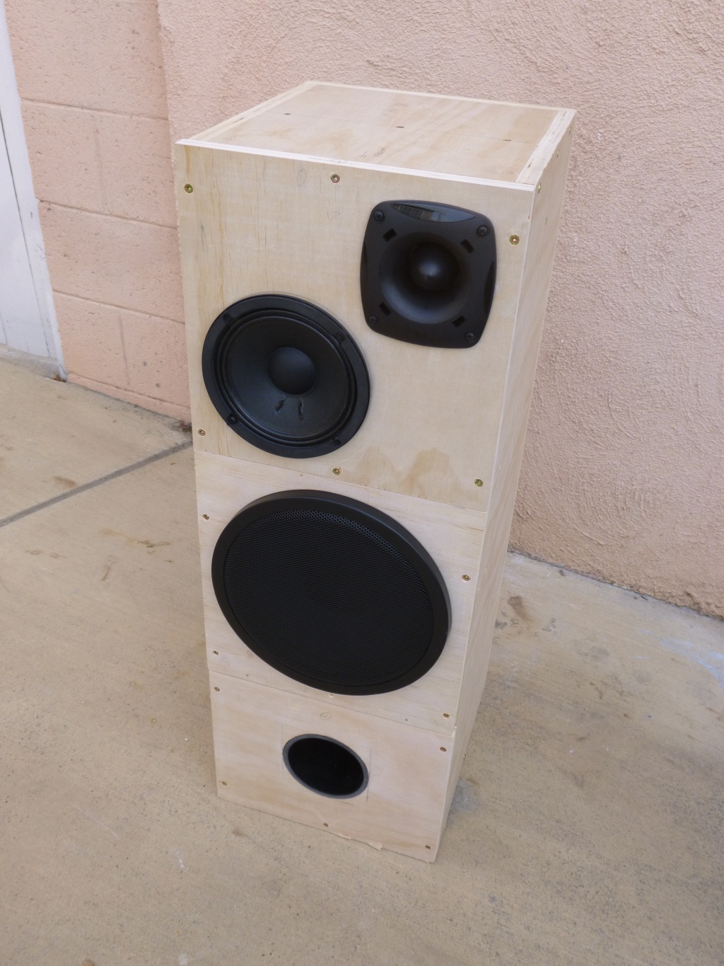

Here's my take on Adason's design. About the same volume as Adason's in a sealed sub-enclosure in a vented enclosure. Paired with my favorite 10" woofer - Eminence BP102.

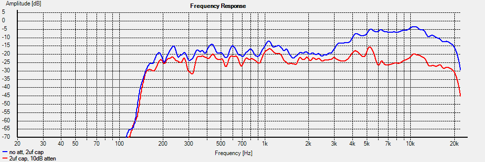

The 6FE200 is an excellent sounding midrange.The ST200 adds a nice amount of sparkle, even though the sensitivity is much higher than the Faital. I've played around with the attenuation of the tweeter and do like it better toned down a bit. I have an L-pad on the ST200. Measurements attached.
