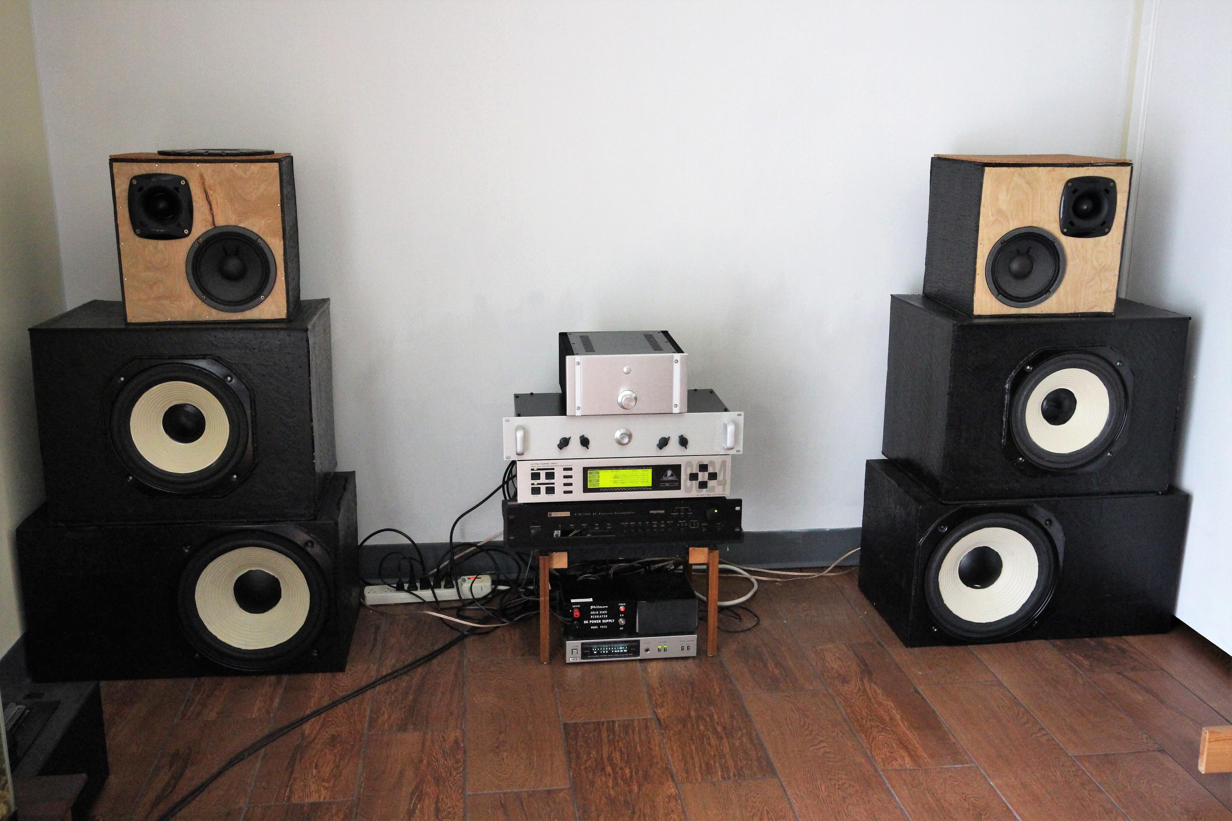

The 6FE200 and ST200 combo being still used, currently in home theater. Its only 2 channel sound supporting my 3D projector, but I prefer good 2 channel sound to any dolby crap anytime. Can't stand multiple channel sound. My sound for projector is so good, it could satisfy as audio only. Thanks to high efficiency of 6FE200/ST200 combo, just few watts of classA amp are enough for dynamic yet sweet sound.

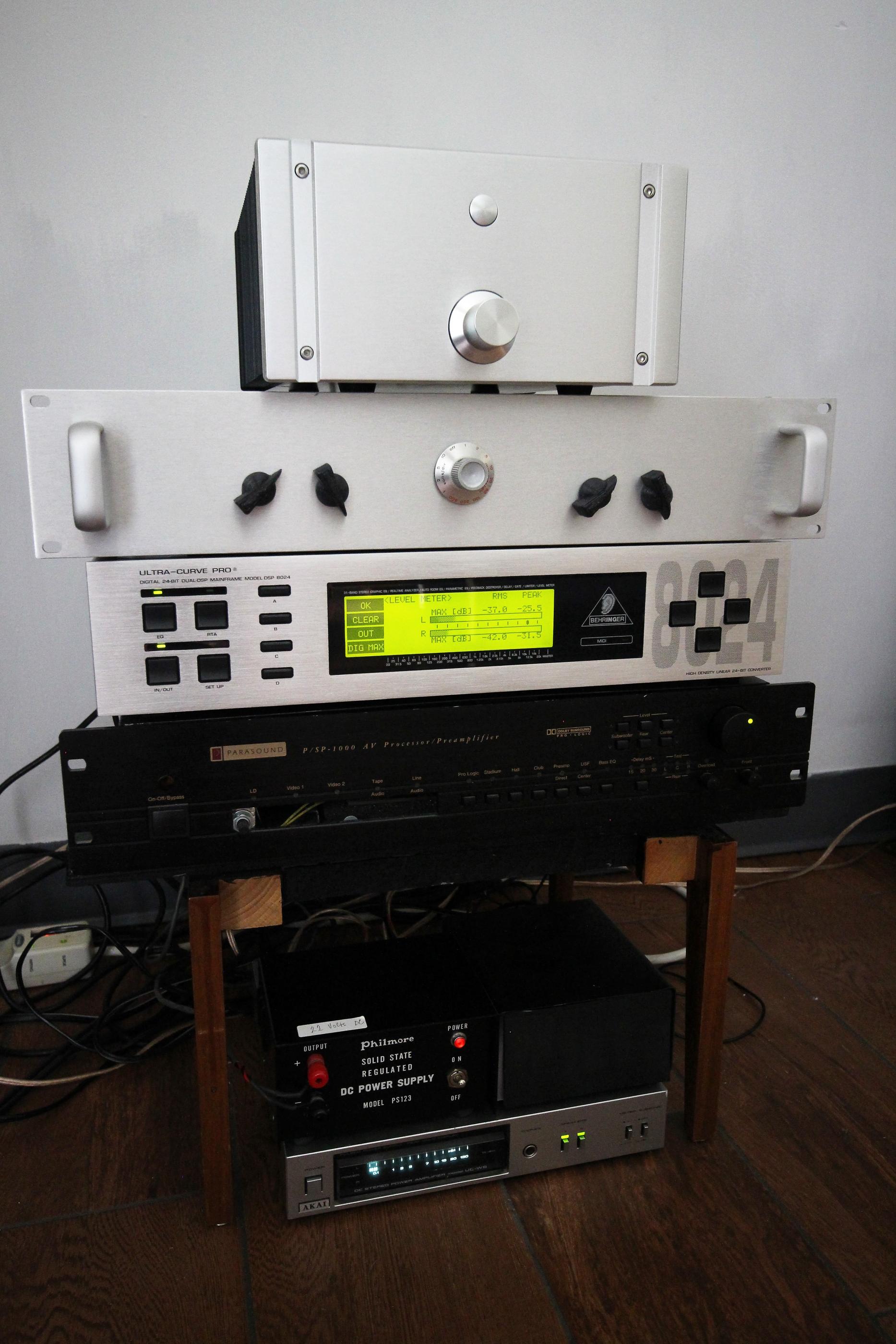

Supporting electronic consists of JC-2 preamp/signal selector, Behringer Ultracurve eq, active crossover Kaneda 150Hz, JLH mosfet 2x15 watts classA amp powering the 6FE200/ST200 bookshelf, and AKAI 2x70 watts chip power amp powering the woofers.

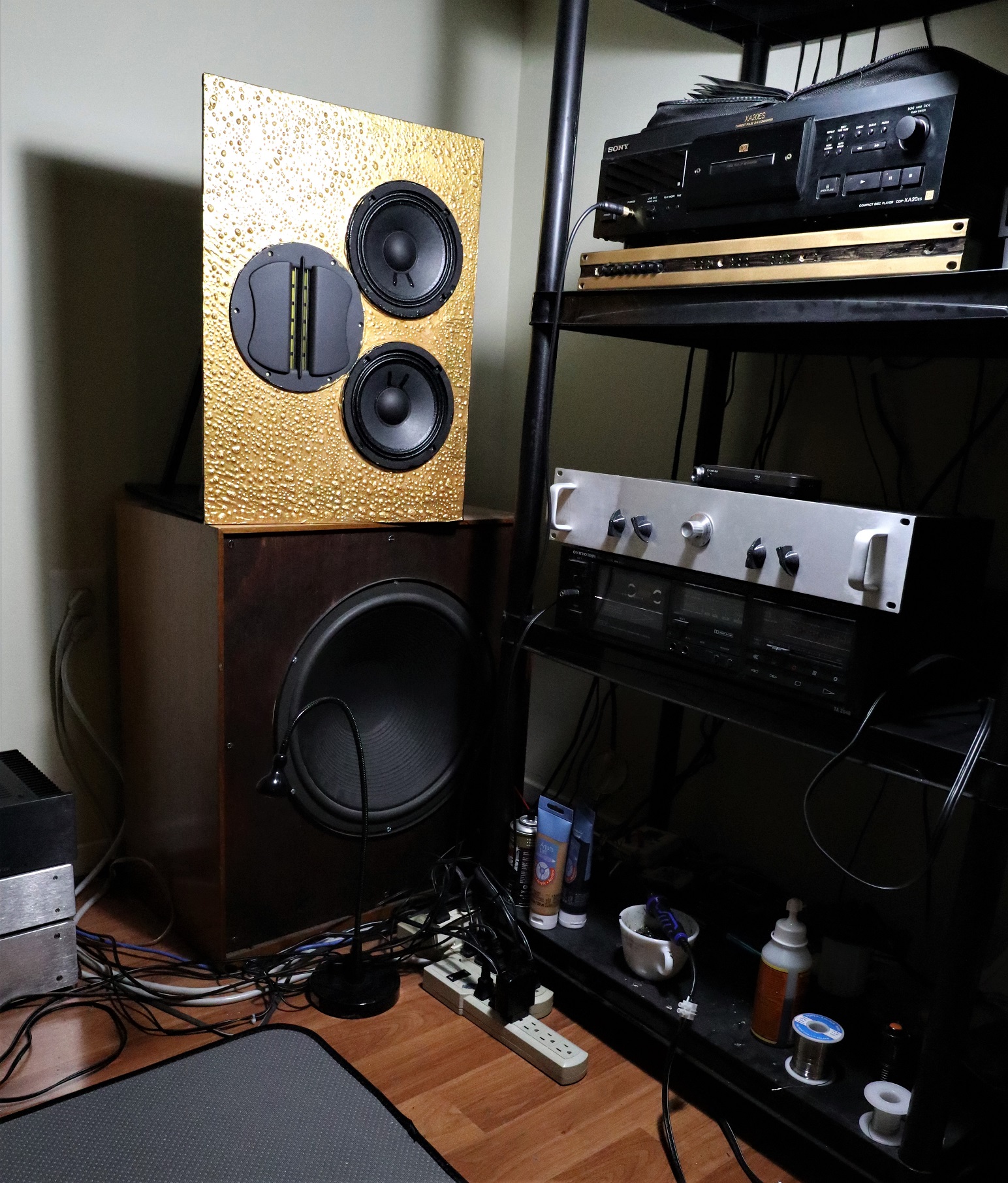

This is how it looks now. Two 8 ohm 6fe200 in series for comfortable 16 ohm load friendly with tube amps and class A solid state amps. No crossover on 6fe200, HiVi planar with just one cap.

On the dual 6fe200/8 build, which model HI VI planar did you use and the cap value?
Thanks.
Thanks.
Its the biggest HiVi planar, RT2C-A. I am not at home so I can not be certain, but I vaguely remember it to be 4.5uF for about 5kHz crossover point.
