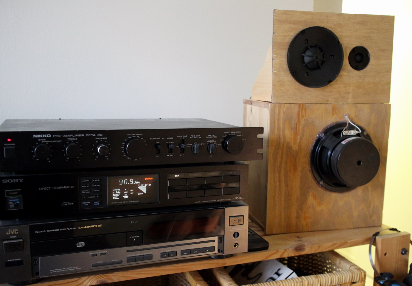

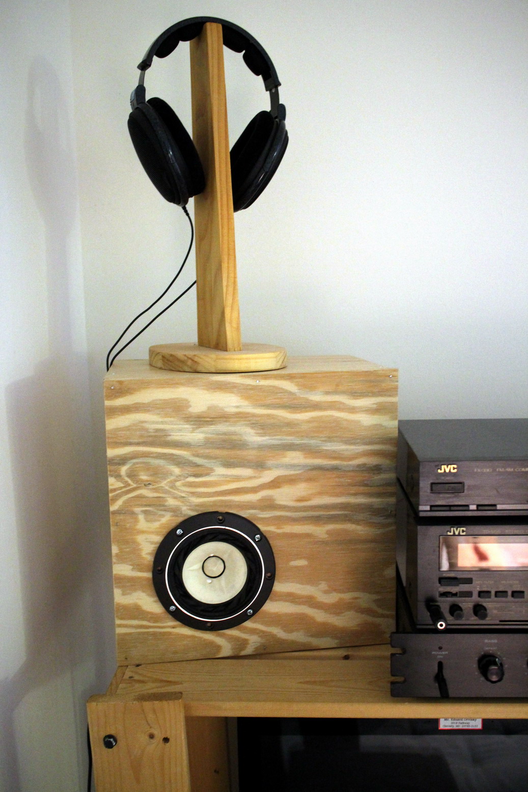

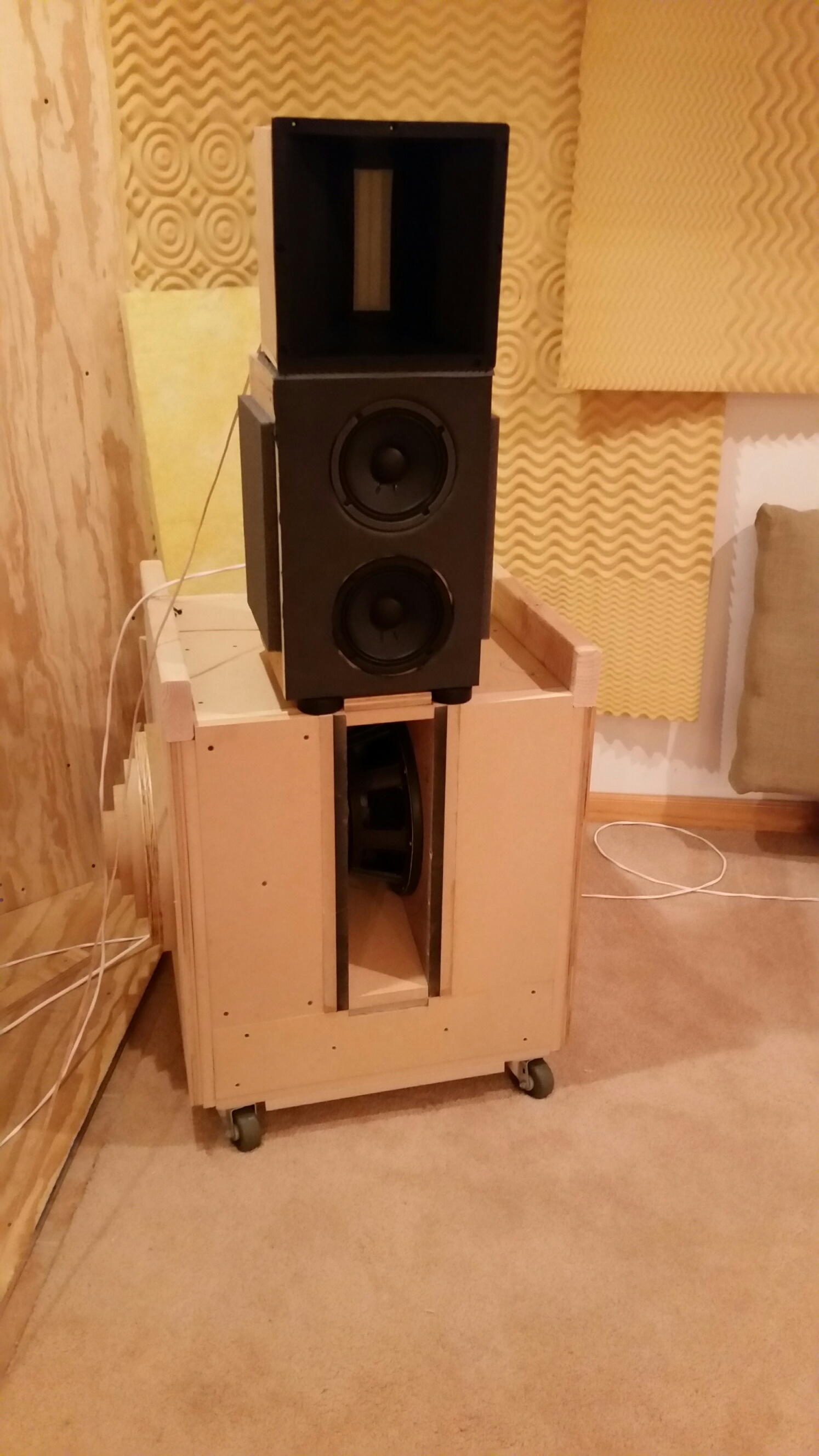

I had exactly opposite experience. Recently started rebuilding mtm to mmtt, and had 2nd order filters all over, did not like the sound. Was sterile like typical commercial speakers. I thing higher the crossover order, bigger phase mess, even if it measures flat on axis.
Long story short, i removed 2nd order, now its just an inductor for mids, one cap for hivi, one cap for foster supertweet.
Measures flat on axis, and off axis till 40deg. Flat phase. Low distortion by rew. Very musical. No sign if harshness from the hivi planar.
But i do not listen loud.
Cosmetics is work in progress, it sounded great upstairs, so i had to test it in bigger room with best amps.

Placed digital oscope on the satellite, average level 200mV rms, with peaks to 500mV.
This is for the two midranges and tweeters together. Fraction goes to hivi. This is like 1/10th of the watt at normal listening level. With 70 watts of music power handling, i think i am safe.
Not sure how you managed to get it to distort. It has 94dB sensitivity, you must have been pushing 100 watts just to the poor planar. Are you sure it was not the midrange, or better, amplifier which was distorting? Or worse, clipping?

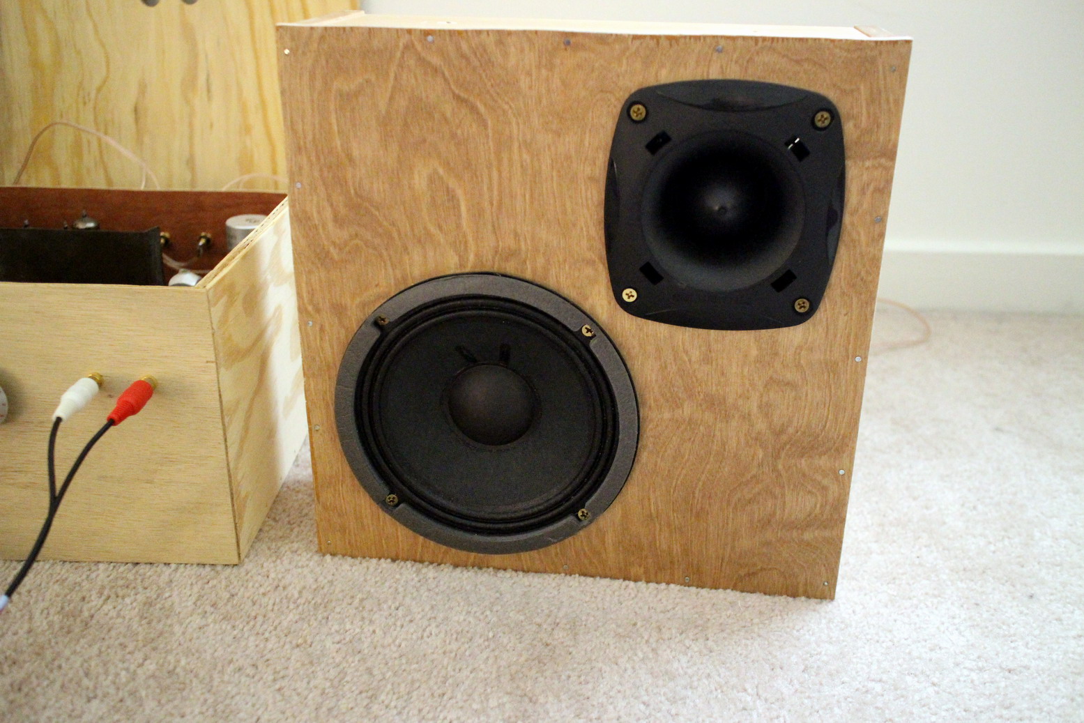

That's interesting. This build was roughly 10 yrs ago, so I dont have pics. It was a 3 way WMTM with RT2C-A, 2x Audax MH100ZO mids and Audax PR330MO LF. It was designed to play loud for a guy who listened to alot of big band jazz. Is it possible my batch of RT2CAs was a different spec at that time? Thats really the only explanation I can think of given our different experiences.
