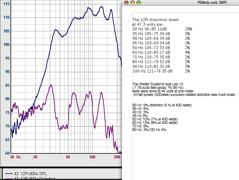

Wayne,
Comparing the distortion of my Lab 2x12 ported cabinet to the 12Pi, it is apparent that the "good horn loading" of the 12Pi seems to have reduced the distortion by a few percent, not 10 or 15%.
Interestingly, below the horn cutoff, where you say the push pull arrangement has the most benefit, the 12Pi distortion rises much higher than the ported cabinet.
Art Welter
Which proves you used the wrong tool for the job, or simply botched the measurements.
I really like the LAB12 in vented cabinets, it's a great system for moderate SPL and power requirements. But through the passband, it can't compare with a horn loaded system in terms of output or distortion.
Not only did you use the wrong tool for the job, but you're also not very good at interpreting the results.
Compare the distortion measurements of a vented cabinet (or horn, for that matter) below cutoff with my 12Pi below cutoff. The vented cabinet distortion is well above 100%, and most horns are too.
I used the tools at hand to test various BR, Horn, and TH cabinets. Many of them did have distortion well above 100% below Fc or Fb at levels a fraction of rated power.
The Lab 12 loaded cabinets had very low distortion, tested in the exact same way.
Please explain in what way you think the results are "botched" and how you are interpreting the results.
OK, so then what's with your comments that my 12Pi hornsub having 28% THD below cutoff? That is clear evidence that push-pull drive reduces distortion. There's nothing below cutoff to load the drivers, so the only mechanism to keep distortion from going through the roof is push-pull drive.
The LAB12 is a good woofer, especially for its price. I use it in both hornsubs and direct radiating vented subs. I think they're both great, in their intended applications.
But there's no magic, no way for a simple bass-reflex box with any woofer to prevent distortion from going through the roof below the Helmholtz frequency. If you're trying to tell us that your box magically does, then I'm calling BS.
I think I just did that. I think your data is bogus.
