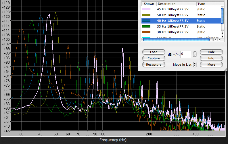

The BC18SW125-4 loaded Keystone Subs will take a lot more power, they were not getting warm with 77.5 volts of sine wave.
Search for the point where excursion is minimum, impedance is low and SPL output high. Try your 77.5V clean sine-wave signal test at that point for >20min… (with intervals)a single tone allows me to measure excursion at the test frequency

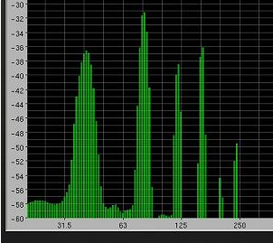

Did you see Jim's SS15 over 100% distortion at 40 Hz screen shot yet ?
The first harmonic would read about six dB more than the fundamental on a dB meter !

Wow, that's...terrible.

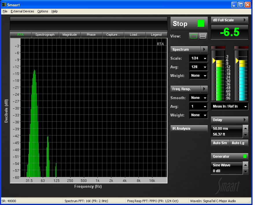

What software is being used in that screenshot?
Smaart.Wow, that's...terrible.
Jim (jBell) has not posted the drive level used on the SS15 in the screenshot, but distortion in well in excess of 100% is common for boxes driven below Fb or Fc .

Now you suggest that the results of a single sine wave on a Smaart will not show distortion ?
How can there be "missing harmonics" in the Smaart RTA display?
If you ever bothered to try the single tone RTA method, you will find it shows what your precious LMS system does in more detail, and will agree closely in distortion percentages.

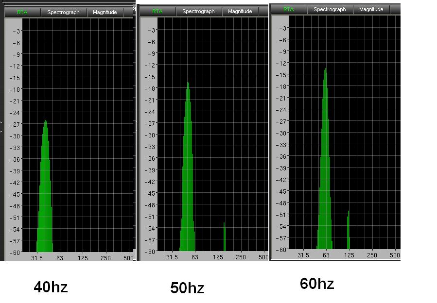

Here is 40hz at a reasonable 100watt (28v) and you can see 2nd harmonic just starting to poke his head up. That's a reasonable 118db@40hz (c-weighted) and 125db@60hz at 100watts. To some that's war volume, and others that's just getting started, so I guess my comment about 'reasonable' has to be interpreted to some degree.
what I still find fascinating is that a 2nd harmonic is there at all, in a 1/4 wave horn, where 1/4wave resonators only produce odd harmonics. That is of interest to me.

Here is the BC18SW115-4 at 77.5 volts, I don't recall if the SPL is calibrated correctly.
