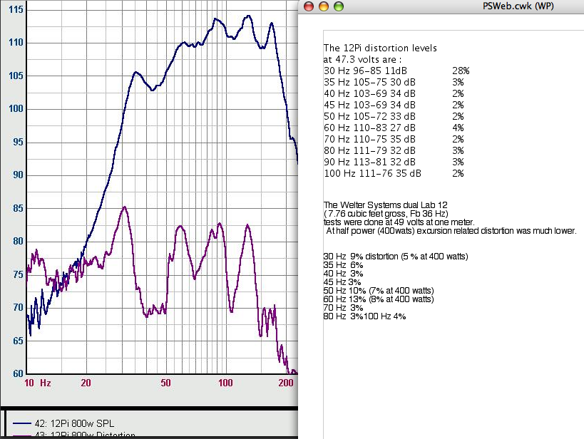

As far as distortion, I have posted data showing my ported 12s having more distortion in the passband, but less at 30 Hz than the 12Pi.
If your ported Lab12 are a 20Hz Fb, in four cubic feet I would expect distortion to be high, at high power, the speaker will run out of Xmax well before Pmax, unlike my 36 Fb alignment.
Post the distortion data of your ported subs here if you have any.

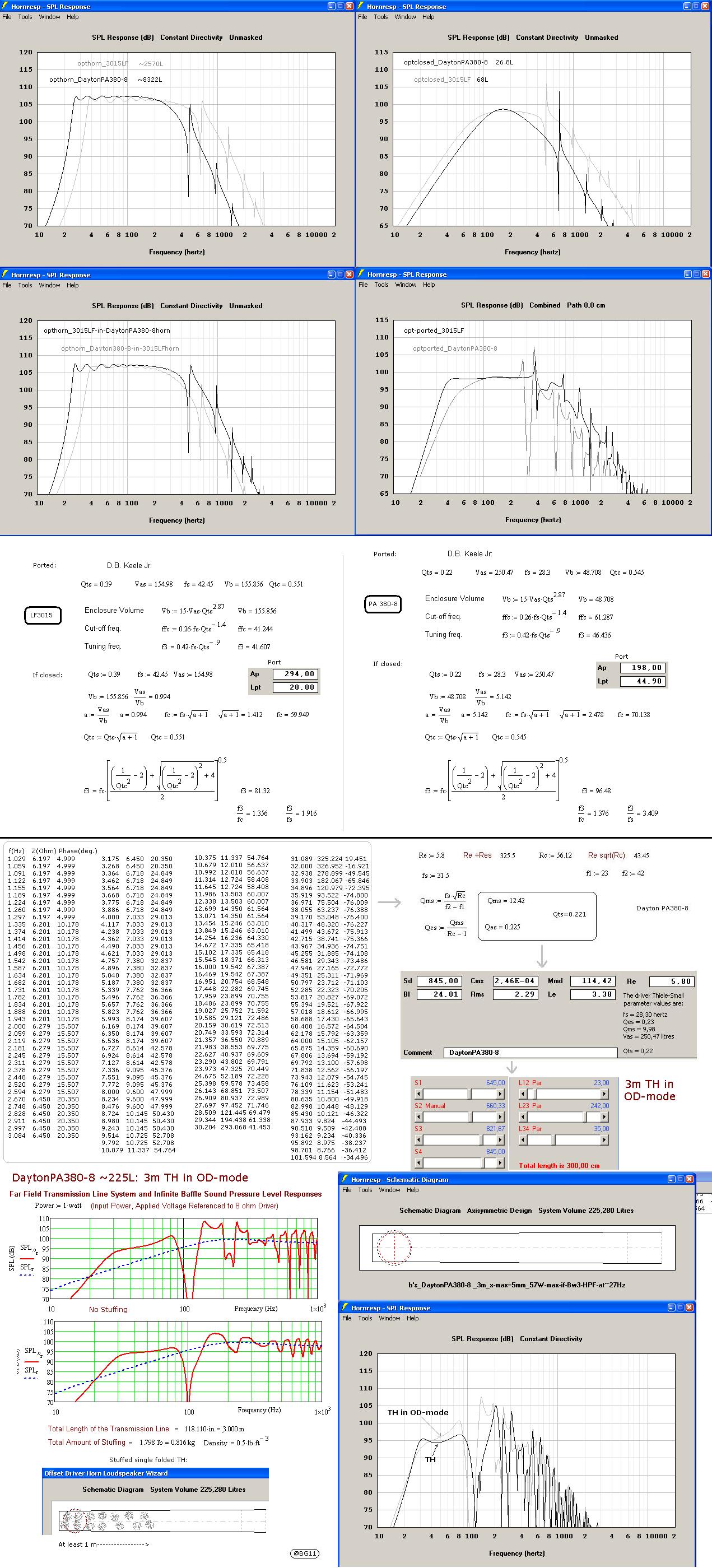

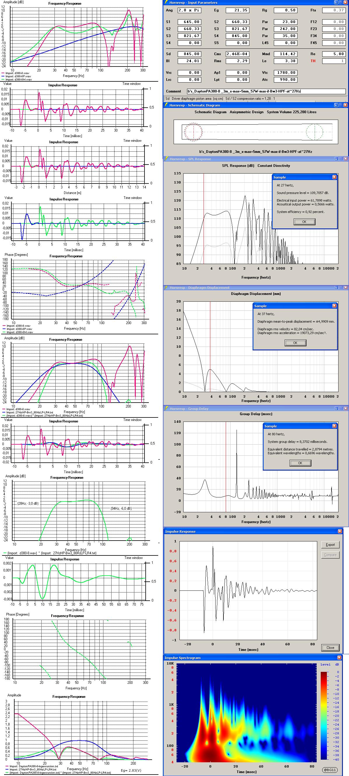

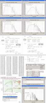

If your Helmholtz frequency is 36Hz, then I expect distortion to start rising rapidly below that frequency. Should be ramping up pretty steeply by 30Hz or thereabouts.
Of course, we all high-pass at that frequency, so it's academic. But you keep harping on it, and I'm calling you out on that. I further challenge your claims of distortion through the passband, which you initially said was better but I think you're backpeddling a bit now. Still, doesn't matter, let's just line 'em up and sweep 'em.

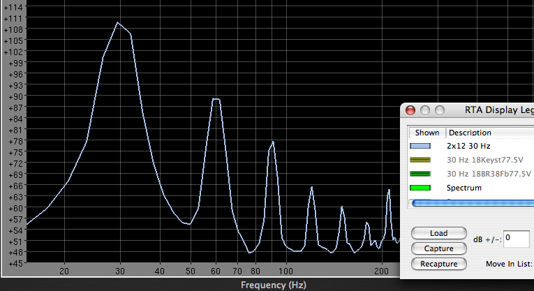

The only reason I “harped” on the 30 Hz distortion was my data shows the WS Lab 2x12 to have MORE distortion in the passband, and LESS below than the 12Pi, which bears out your “horns have less distortion” statements, but opposes your observation that push pull has the most effect below Fc or Fb.
I gotta calls ‘em likes I sees ‘em.
I only used a pair of Crest CA-9 to power my four 2x12 cabinets, into slight clip results in the speakers hitting Xmax in the 50-60 Hz region. I have put 66 volts sine wave into them in that region, they sounded a bit rugged. Four cabinets will do 104 dBC at 125 feet at 40 Hz with music with two CA-9 driving them.
The BC18SW125-4 loaded Keystone Subs will take a lot more power, they were not getting warm with 77.5 volts of sine wave. The CA-9 bridged mono is not enough power to "light 'em up", but my system has more headroom with them than the WS Lab 2x12s.
