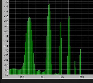

what's up with this? (ss15 at 40hz sine wave) flute or clarinet?
Jim,
Looks like normal (but gross, over 100%) distortion at multiples of the fundamental, 80, 120, 160, 200, and 240 Hz.
Pretty much what you would expect from any speaker driven below Fb.
That distortion makes a speaker sound loud ;^)!
I'd expect distortion to be pretty high with the speaker you use in the SS15.
What does it look like above Fb (the low frequency cone movement minima frequency) ?

Well, at least we have shed some light on the subject. We clearly are talking different things here. You're talking only about second harmonics. I think if we were using the same measurement procedures and gathering the same kind of data, the scale of the numbers would probably jive better.
I can see in your measurements that the third harmonic is nearly as loud as the second, which is not uncommon. Sometimes the third harmonic is actually louder than the second. I think for completeness sake, it might be best to mention the fact that your value is second harmonic only. You are quoting second harmonics, not third, and certainly not total.
Personally, I am interested in second and third harmonics, because those are usually the highest. When looking at tapped horns, I think it might be important to go higher, since they regularly have a lot of high frequency spikes. But of course, if you're comparing tapped horns with other configurations, it would only be fair to examine the higher harmonics of every other system under test too. Apples and apples.

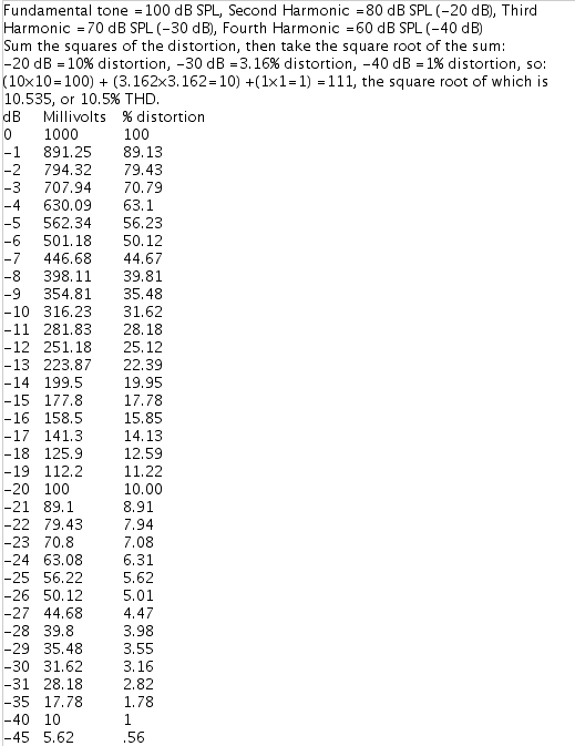

I might suggest that one way to make your data less confusing and perhaps more presentable would be to list each of the harmonics you can see with their decibel (and percentage, if you wish) relationship to the fundamental. For example, instead of saying the "distortion" is 6.25%, which might lead people to think it is THD, make a list of the harmonics like this:
2H = -24dB (6%)
3H = -28dB (4%)
and so on.

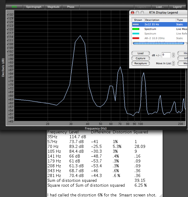

As far as my figures, just to satisfy you,(and any one else doubting my figures) I did the math on the 35 Hz dual Lab 12 screen shot.
I had called it 6% distortion, adding all the harmonics makes the figure 6.25%.
