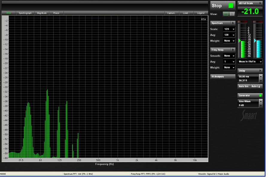

Wayne,I think I see the source of the confusion. I am talking about THD figures, but I think weltersys is using the value of the 2nd harmonic, by itself.
I was taking his word, and not really examining his charts very closely.
But when I look at his chart of a dual-LAB12 bass-reflex box, this is what I see:
2nd harmonic - 24dB below the fundamental (~5%)
3rd harmonic - 28dB below the fundamental (~3%)
others above that too, each successively less.
When you add all the harmonics together, the THD much higher than the second harmonic by itself. That would account for the missing ~10dB.
The addition of the additional harmonics hardly makes a very small difference in the total, which is why I did not bother with all the math.
For example:
Fundamental tone =100 dB SPL, Second Harmonic =80 dB SPL (-20 dB), Third Harmonic =70 dB SPL (-30 dB), Fourth Harmonic =60 dB SPL (-40 dB)
Sum the squares of the distortion, then take the square root of the sum:
-20 dB =10% distortion, -30 dB =3.16% distortion, -40 dB =1% distortion, so:
(10x10=100) + (3.162x3.162=10) +(1x1=1) =111, the square root of which is 10.535, or 10.5% THD.
If you want to go through all my charts and do the math for about .5% difference, go ahead.
You will find since I rounded up to the nearest percentage point already that the difference will be quite small.
Have fun !
Art Welter
The 16% distortion @50 Hz for the TH design was excursion related, different distortion resulted with different speakers in the same cabinet.I ran a sim of that design. The Lab12 does stay within Xmax @400W. Did you measure Fb though? I expected the output @40 Hz to be a bit more than what you measured, if the Fb is indeed 36 Hz. Or maybe your measurements are showing the effects of vent compression.
The 16% distortion @50 Hz for the TH design is a bit of a curiousity, particularly as it appears to spike at that frequency - it's lower at nearby frequencies, and if it wasn't for that spike, the TH would look like the better performer. Panel flex perhaps? I ran into a similar issue when measuring distortion with my POC #2. Turned out to be a small stone below the box that was preventing the bottom from being in full contact with the ground.
