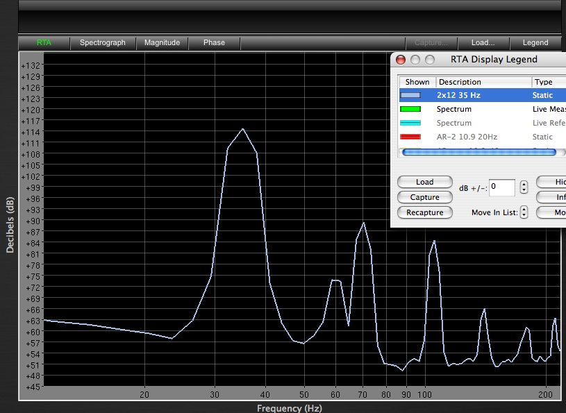

I use Smaart, single sine wave tones, using the RTA to see the added harmonics. All my posted tests have been outdoors.
I would like to test at 10 meters, unfortunately 2 meters gives more accurate results due to distance to buildings.
Generally have used 5 Hz spaced tones near the Fc or Fb, then 10 Hz at higher frequencies.

The tests were done at 49 volts, nominally 400 watts per speaker.
I checked my test results before posting them.
The percent distortion only includes the largest harmonic, but addition of the lesser harmonic distortion would only amount to a fraction of a percentage point, so I did not go to the trouble of calculating it.
The method of calculation is time intensive enough as it is .
The Lab 12s did not exceed 10% distortion except when over Xmax.
Art Welter

Wayne,
The voltage could be off by a volt or so. I have several VOMs, the variation between them is only a couple volts at 120, probably only a volt at 49 V. I set the voltage at 60 Hz, presumably a frequency the meter should be most accurate at.
The Smaart RTA seems quite accurate to me, why do you doubt it ?
A screen shot is attached below, can you point out some screen shot that looks "off" to you?
Where is your data supporting the statement that the "THD of a direct radiating LAB12 is not even close to 6-7% at any frequency at 400 watts." ?
