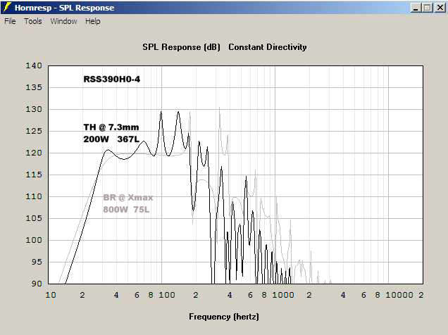

If that's the case why bother asking about phase (or anything else as a matter of fact, just stuff that puppy in 4'x' board, and call it good)? Attached, please, find a SPL comparison of the RSS390HO in a tapped horn (@500W), and in a bass reflex enclosure (@800W). They don't perform the same, they are nowhere near the same size, be have differently under power, and if you would break down and fire up Hornresp you would see that their phase behaviour isn't the same either.
5dB difference is 3.16 x the power in our world...
and 120 is about 94% of 125, in this world.

However, lets get back on topic, and put some math to this... as everyone is just guessing in the dark as to what you really want. You have a wo32 (corner loaded I'm assuming) and it has the recommended 10" drivers (again assuming) You are very happy with it, and it's crossed at 60hz to flatten off the rising response, so that you have (optimistic) somewhere between about 35-40hz up to about 120hz. At about 150 watts you are exceeding xmax by 2, so it's safe to assume that's driver damage territory and there is no way you are running that loud. At the most optimistic you are running 120db from 40-120hz at 1 meter. Your listening position is somewhere between -6db and -10db from your 1 meter level, meaning you are really listening to about 110db. (In reality, it's probably closer to 105db)
SO, lets put that outdoors, and you are listening at about 30-60 feet away. You need your 1 meter output to be about 23db above your 105-110, meaning your sub needs to put out 128-133db from 35hz-120hz.
That's no easy feat, and your little 12volt supply to an auto amplifier with your Karlson will not do it.
Your 120db = 125db comment shows that you haven't done any math.
please do us all a favor -- do the math, figure out what you want, and then ask questions.
You'll find lots of help, with no sarcasm or anything else off topic.
and no.... "and 120 is about 94% of 125, in this world...." it is not -- your ears hear log, not linear.

A 10 dB increase sounds twice as loud at around 1000 Hz.
Down at 20 Hz, it "only" takes 5 dB to sound twice as loud.
A 3 dB increase requires double the power .
A six dB difference requires four times the power, but when drivers are pushed hard, they heat up, and no longer will put out 3 dB or six dB more even if the power is available.
And if driven over excursion limits, drivers break. Many designs run out of excursion before power limits.

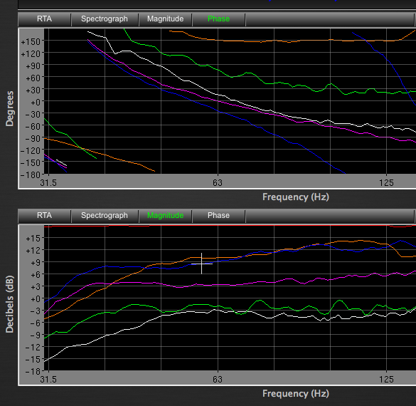

Regarding phase questions, no speakers are flat in phase response, below are a TH (blue), BR (purple), and AS (acoustic suspension, green) all with similar frequency response. A pair of C horns (orange) have a higher cutoff than the other three cabinets but the flattest phase response.
As long as the subs phase curve is matched to the top cabinet at the acoustic crossover point, the difference in phase response between the cabinets is not a big deal to my ears.

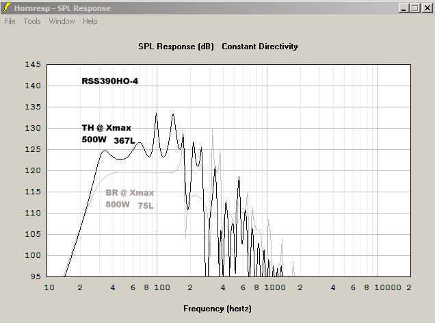

Hi 60ndown,
The problem with dB is that it's so easy to get the numbers wrong. 3 dB is a 100% difference in power. In addition the models in the example (Post #15) are run @ a 300W difference in input power to begin with, that's another 2dB (from 500W to 800W). Just for fun I had Hornresp plot out both boxes with a 6dB input power difference, TH=200W/BR=800W, then the SPL curves are on about the same level. Naturally, the BR is still maxed out in power and Xmax, while the TH is now taking it considerably easier @ 1/4 max. power, and 7.3mm/35Hz excursion.
There has been a long discussion in the
http://www.diyaudio.com/forums/subw...ped-horn-project.html?perpage=25&pagenumber=1
pertaining to port losses, and there have been many discussions as to the very real power compression in the drivers, so the difference may be even a lot worse for the poor BR, but then, the TH is still in a much bigger box, and thus the BR may be much easier to lug back and forth, and nobody can tell you which sound you'll prefer.
