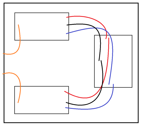

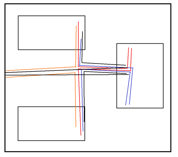

Another thing (in case of using the same PS) is the GND loop between to 2 channels as attached.
I think the 2nd version is the better. And maybe the input RCA wires should follow this main wiring as well.
each PAIR of wires that passes a flow and returncurrent must be a close coupled PAIR.
Your right hand diagram gets closer to achieving that.
But is mixing a low level signal PAIR along side a HIGH current PAIR a good idea for minimising interference?

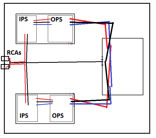

And what about a layout like this?
  • input RCAs close together on the chassis
  • PS wires can create a "loop"
  • signal GND goes directly to main GND
  • signal GNDs arent connected to local PS GND on the amp PCB at all

You have a big loop area around the input , amplifier board, power supply and back to the input. Any flux from the power transformer intersecting this loop will probably generate hum.
Personally, I would run the signal returns to the amplifier board along with the signal and not directly to the PSU as you have shown.
I would bond to the chassis from the central star ground, being careful to 'T' off to avoid charging currents. The incoming mains earth would also bond to the chassis at this point.

No and confirmed by MarkW and Bonzai.
The input pair must run as a pair for the whole route from RCA to Amplifier.
The extra wire from Input RCA barrels to Zero volts creates a pair of LOOPS.
Those loops will inject interference.
I don't see any loop there, that's the point. That's why I said "loop" as well.
It's looks like but there isn't. (The signal GND is not connected with the PS GND on the PCB!)
So (if you would like) you can bring the PS wires whereever you like.
I am not sure what you are saying (maybe a quick paint work to explain..?) but if the
signal GND is not going via 1 wire only to main GND, then will be a loop created.
It's exactly like this: there goes 1 pair of wires from RCA to the amp.
I am not sure how much noise it would create with wires close to eachother.
Or it can be implemented without loop as well: taking the signal GNDs
from that wire going to the amp PCBs exactly as my image shows.
An other thing: I am not sure but maybe with this layout a 10R resistor can
be applied in series with this wire..?! (These 2 potentials should not change a lot so
the main goal there is basically just the "equalization" of this 2 potentials, right?)
