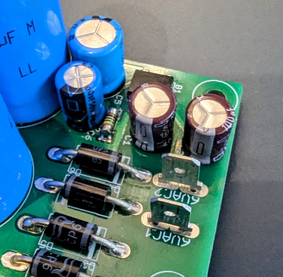

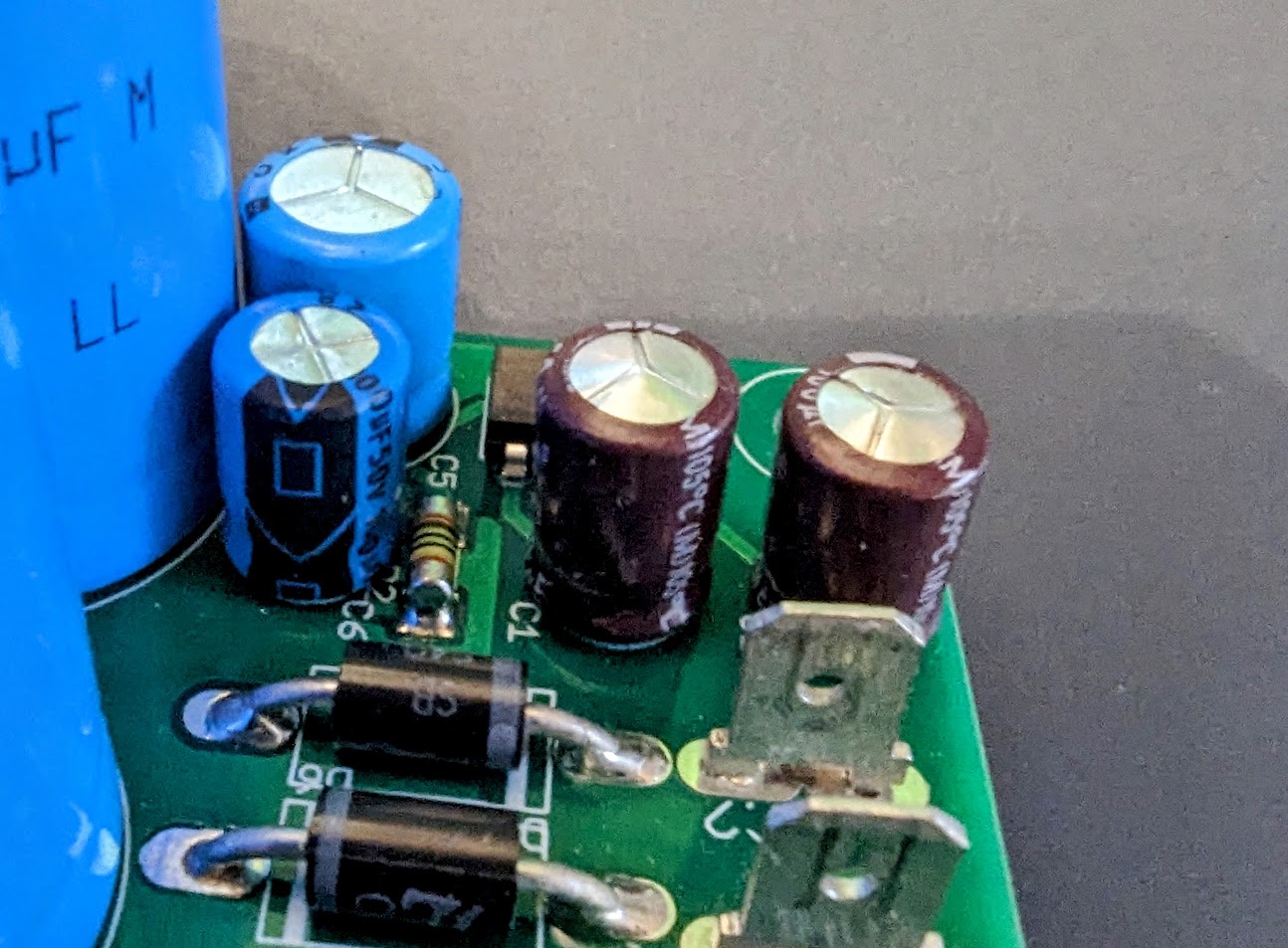

I replaced them with unpolarized caps a while ago. Measure the bridge and get some unpolarized replacements 47uF 25V

Swopping polarity will work as well. Swopped the polarity around on the boards I bought from you. And then there is 8 volt accross them with negative probe on negative pole and positive probe on positive pole.I replaced them with unpolarized caps a while ago. Measure the bridge and get some unpolarized replacements 47uF 25V
if you can't find 47uF nonpolar then you can use two 100uF normal polarised electrolytics in series with their negative legs joined, per side.

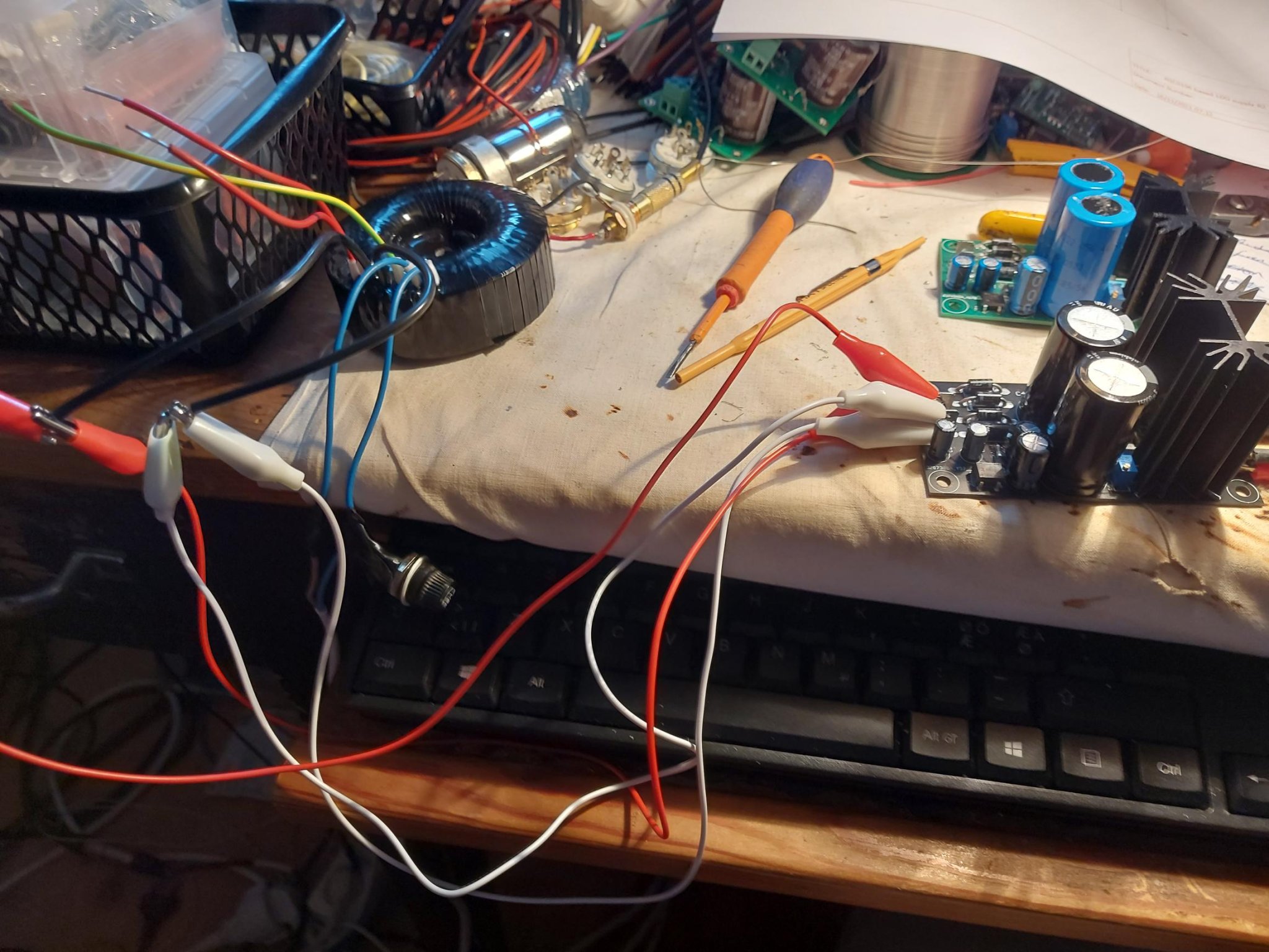

Ive built 5 of these with pcbs from jlp.But I cant get past 6v with a 6sn7 at the output.Its he same on all boards.I have 6,55v at the big elyts.
I use IRF840 is that of any dissadvantage?
So the IRF840 is doing fine in this circuit? I have also purchased them for this board.I found the fault.
I found out that the experiment cables that I use between the trafo and the 6,3v module are to thin that I get a voltage drop.
I took another pair and paralleled and I now get 6,3v dc out.

Will change to unpolarized.But it still working as it is.I think they are a part of a voltage doubler.c1 and c2 are the wrong way around still. Check my post 87 and 88.
