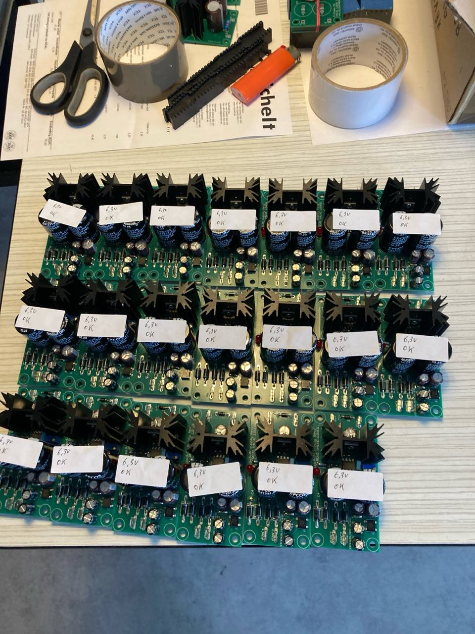

Due to popular request im doing another batch of 10. Ive sold 4 sofar so there will be 6PC available.
Price is €35 each.

Received the first four bords sold a few time ago and they are very well done by @v4lve lover , they also works great.
I suppose they will also work at 2.5Vac to 2.5vdc? Will test it myself...but thought I might as well ask as well.
No, they wont work for 2.5VAC to 2.5VDC i think, there is not enough drive voltage for the mosfet in that case. 4VAC to 2.5VDC should be possible through. I used IRL540 mosfets in the latest batches, these have low threshold voltage.
