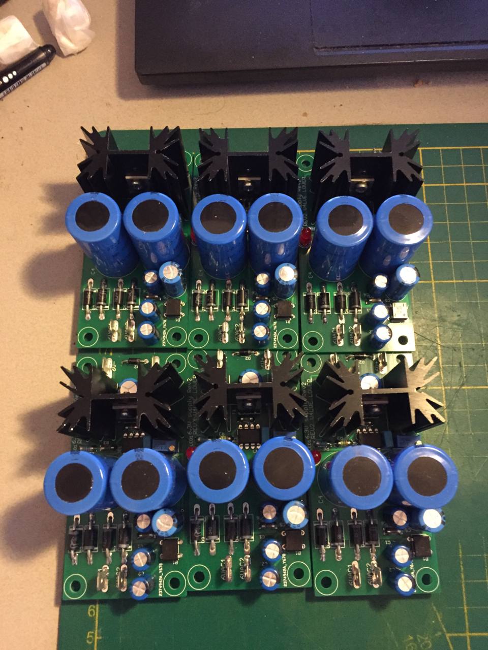

6.3VAC to 6.3VDC LDO supplies MIC5156 based tube amp upgrade
I sold five modules of the last batch of ten, 5 remaining.

Sorry for asking very basic questions:
So these are adjustable voltage 5156 based regulators, with essentially zero voltage drop, and can supply up to 2.5 A?
What is the actual voltage drop?
At what ambient temperature can these provide the 2.5 A? - (I had briefly looked at low forward voltage diodes/bridges, and the ones I found seemed to be continuously derated for ambient above 25 °C. I'd like to power two 6L6GC at 6.3V 0.9 A each, with ambient probably around 50 °C.)
And what is the size of the module? 50 x 100 x ? mm
Do they need any additional external voltage, besides the e.g. 6.3 V AC? - found the schematic in an earlier post, doesn't seem so.
Can this board be set up for constant current mode?
If there is another thread answering these questions (or others I should ask but forgot... 😉), please point me there.
Voltage drop is 50mV/A. I would have to run the specs on the diode derating at different ambient temperatures, but Ive never had diode failure reported in over 50 modules sold.
These are adjustable 5156 regulators, voltage drop is near zero, depends on the On resistance of the fet, but lower than 50mOhm .
I wouldnt go over 60C ambient temperatures at 2.5A DC out or you may overstress the diodes.
Sixe is 50x100mm and about 38mm high excluding stand offs M4.
No additional voltage needed except for the single input AC, these modules cannot run off DC cause of the way the drive voltage for the FET is made.
This is a constant voltage board.
