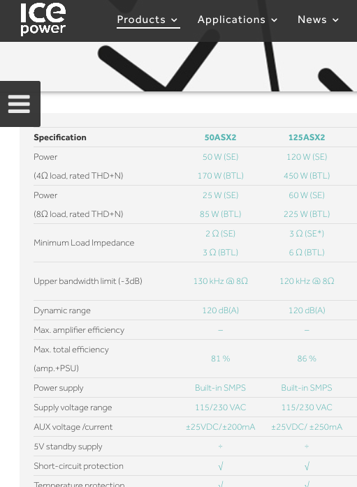

The rating gets worst the more you stare at it.
Lower power for 115V
Continuous power of 60-70W
I’m getting 1 to play with. Possibly hooking up 2 8 ohm sub to get decent peak power.

60W as a stereo amp, but 225W BTL. Just use them as monoblocks. In my experience, monoblocks sound better. That's why I'm using it BTL.
The data sheet you show seems to have a typo. The pdf data sheet page 8 shows the minimum load impedence in BTL mode is 3 ohms, not 6 ohms. It has minimum asymetric SE loading of 2 & 6 ohms.
I got the screen shot directly off the ICEPower website today. I was looking for a replacement of a Rotel Power amp that pushes 130 WRMS per channel. There are newer ICEPower modules available like the 1200AS2 but are too expensive for me at this time. I am looking forward to the review of your mono blocks. If you are happy with them I may possibly reconsider. Thanks for your replies. 🙂
The argument is that music doesn't require continuous power. Also, the 125 has better continuous output BTL into 8 ohms (200W) vs 4 ohms (70W). Nelson Pass says, it's the first watt that matters most. And 0.002% THD+N at 1W into 8 ohms is very good. Note that distortion is greater at higher frequencies, like all Class D amps.

I cancelled the order after studying the specs and it could not replace what I have. The amp is really rated at 60 watts RMS into 8 ohms according to ICEPower website. 😡
60W vs 125W, could you tell the difference? But of course it depends on your need. For me 40-50W is more than enough.

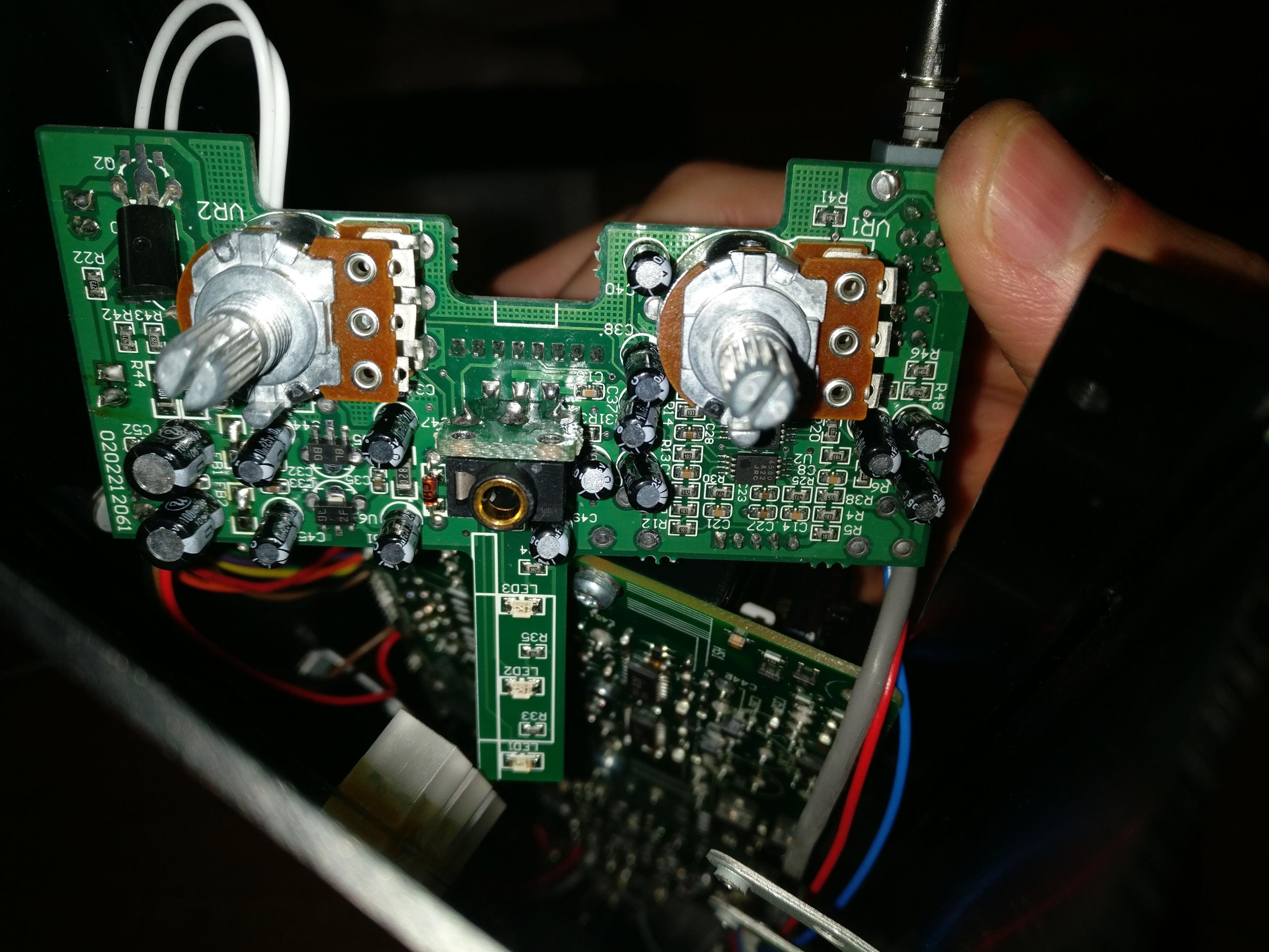

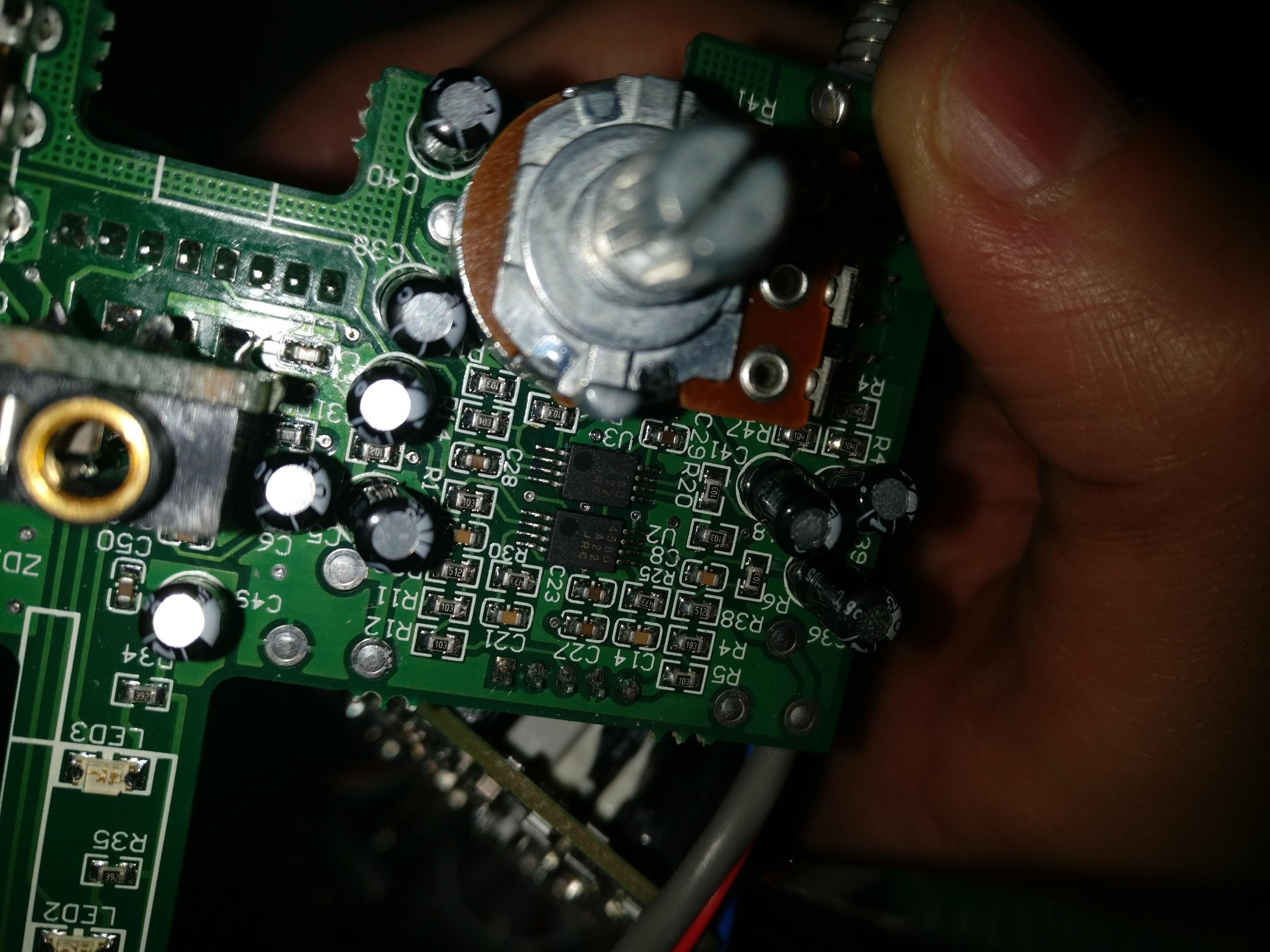

I finally received my Feather Amp.
I received late at night so I could not make any extended listening.
It's build quality it's quite good (Made in Taiwan not China). It's indeed an ICEpower 125asx2 module.
I only took it apart to switch the pins to 220Volts (default is 110Volts).
Both input (3.5mm jack and 1/4 TRS) both go to the pre-amp board.
The fan is a 40mm 24v 20mm thick and it's not always on.
I am uploading pictures of the preamp, later I will upload pictures of the whole amp disassembled.

Looking forward to the expert's comments on the preamp.

Thanks for the high res photos. The opamp is an NJM4580 which based on descriptions in DIYaudio is an "also ran" to "ghetto blaster". Could do better. Replacing it may be a challenge, because of the surface mount size, and finding replacements like an OPA-2132 in the same package. But, I'm no expert in swapping surface mount chips. We may be stuck with it. Hope it sounds good in the circuit.
It would be nice to know what those pot values are and put in a dual pot instead. Listening now on a stock FeatherAmp. Not bad sound. Don't know if I like it any better than my TPA3255evm board or not, time will tell... but the small size is appealing.
