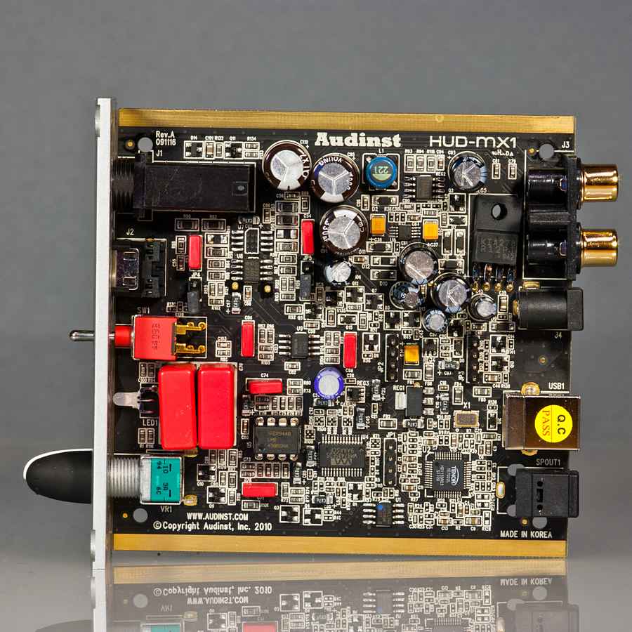

Can someone explain what is this unique "impedance is changing with frequency" behaviour of the ICEpower modules? I mean I have a desktop DAC with 200 Ohm output (+ an integrated headphone amp if that helps), and I'm thinking about simply bypassing the preamp / input buffer stage. Wouldn't it make a better sound?
It has a volume knob which also affects the line out, or I can use digital volume controls. Would that work with the 125ASX2 or I'll have trouble because of the "changing impedance" thing? Here are two pics from my DAC:

The 125ASX2 manual states: "The input impedance of the signal input section is approximately 8k over the audio bandwidth, which is an
acceptable loading condition for most pre-amps, active crossover outputs etc." Standard line level impedence is 10k, so the 8k figure kind of stands out.
200 Ohm output impedence is very good. You should have no problems. Your DAC has a very good output opamp. I think the least amount of components in the signal path, the better. In my setup, I go straight from the DAC to the amp. You may need to determine the sound quality of the digital volume control. There are different ways to implement this. If the DAC chip has a hardware volume control, and you can control it, it's probably good.
The output impedence of the amp increases with frequency, because of the required filter on the output to attenuate switching noise. I think all Class D amps have this filter.

hifiamps, thanks a lot for the explanation, I'll mod it to bypass the input buffer then.
The only thing which is not clear to me is that people said that using a potentiometer would not work with these amps. So if my DAC has a potentiometer (as well as hardware volume control). So is the pot usually at the input stage, before the op-amps?

The 125ASX2 can take single ended inputs in stereo mode. Your DAC has low enough impedence to drive it. The potentiometer is before the opamp buffer. In mono BTL mode, the 125ASX2 needs a balanced input.
Thanks, yes, I realised this would only work in SE mode, luckily I only ordered one board only.
