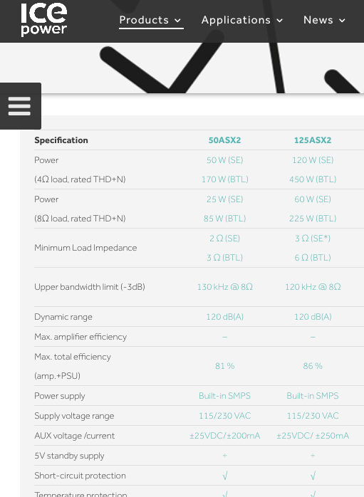

I cancelled the order after studying the specs and it could not replace what I have. The amp is really rated at 60 watts RMS into 8 ohms according to ICEPower website. 😡
60W as a stereo amp, but 225W BTL. Just use them as monoblocks. In my experience, monoblocks sound better. That's why I'm using it BTL.
The data sheet you show seems to have a typo. The pdf data sheet page 8 shows the minimum load impedence in BTL mode is 3 ohms, not 6 ohms. It has minimum asymetric SE loading of 2 & 6 ohms.
