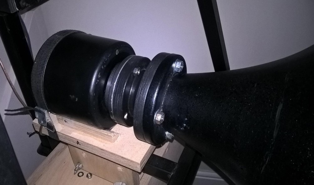

Here's a pic of testing the Tractrix 400Hz horns in place of my 550s.
I made throat adapter from 2" to 1.5" so they could be used on S2's etc.
I've also had some interesting Phillips 1.378" compression drivers here. They
sound much like aluminium diaphragm Vitavox S2's. They share the same screw on thread too. Perhaps they were made under licence or by agreement?

400Hz Tractrix and a mid bass itch to scratch
