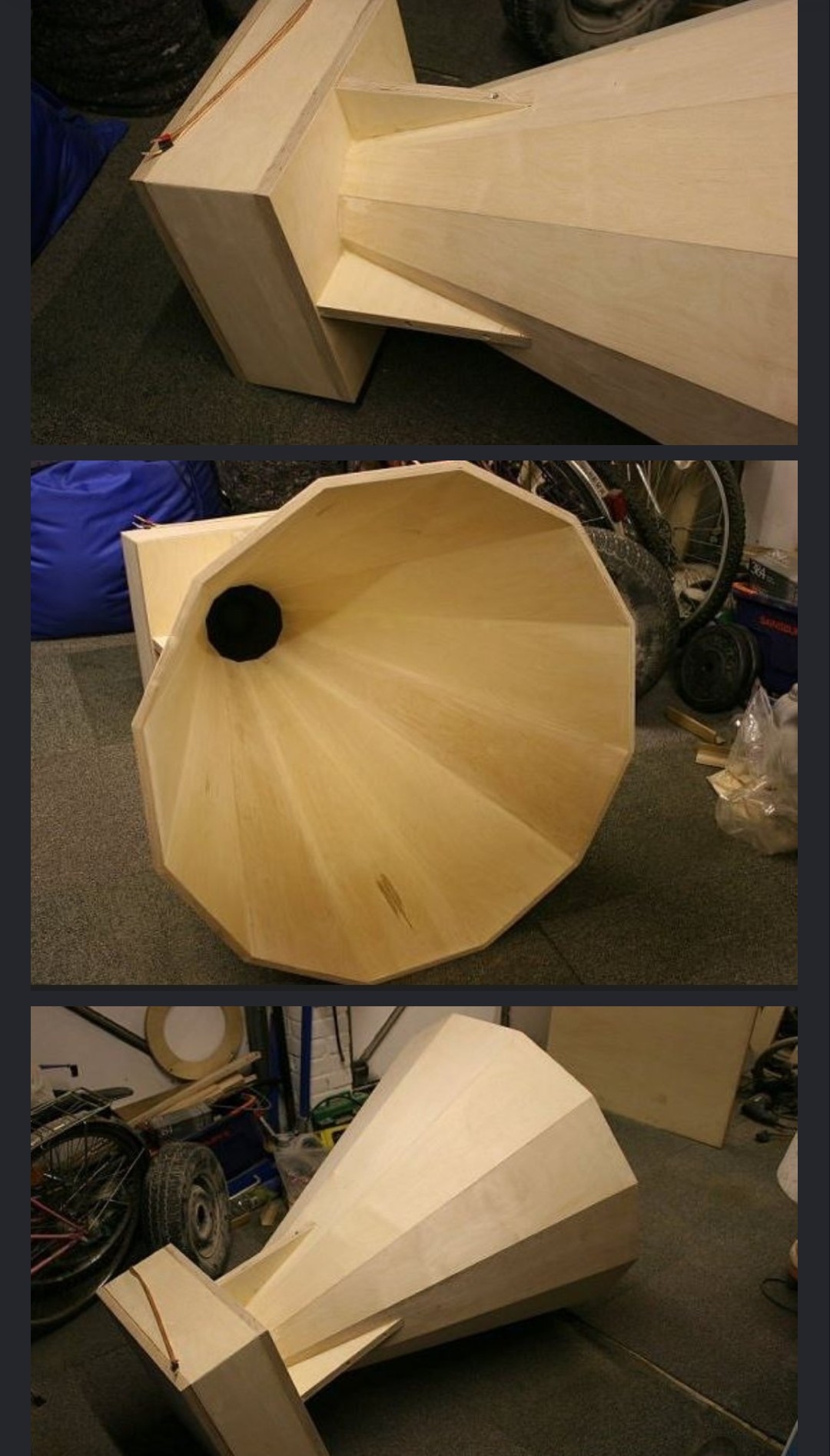

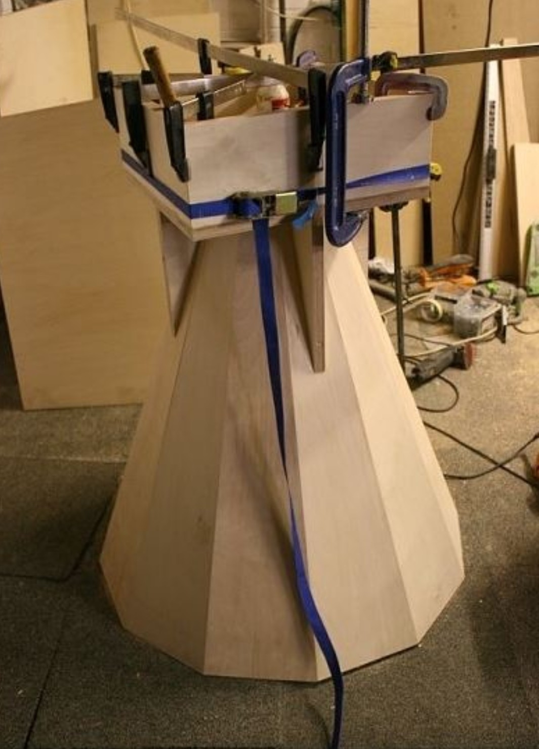

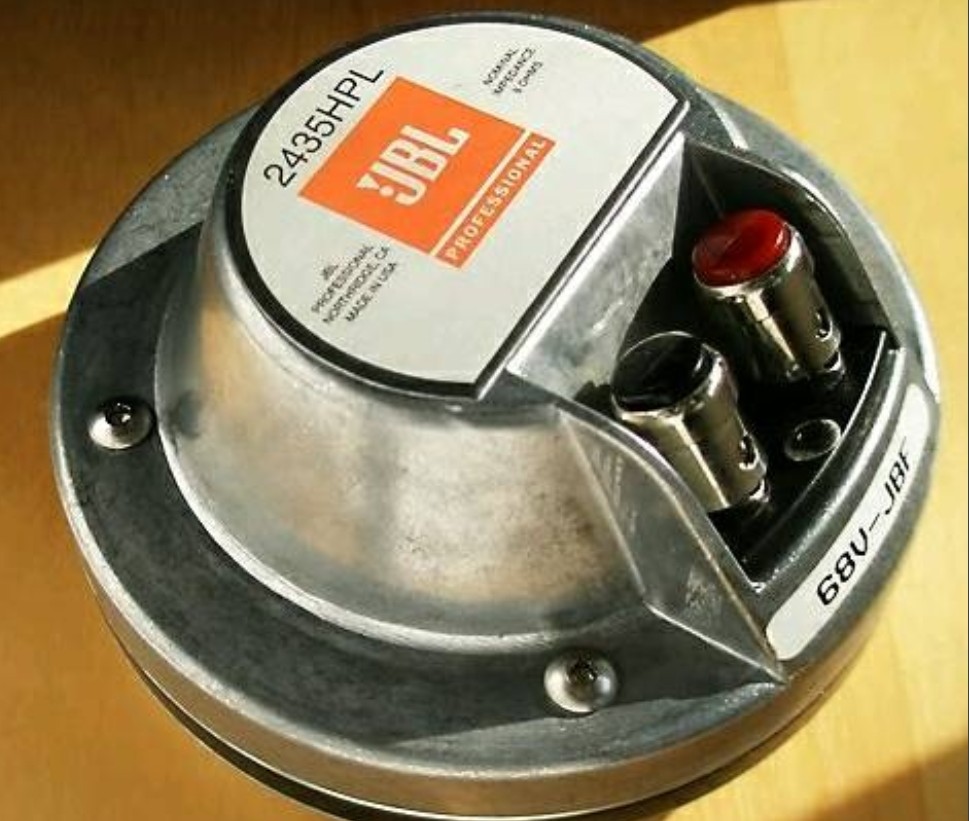

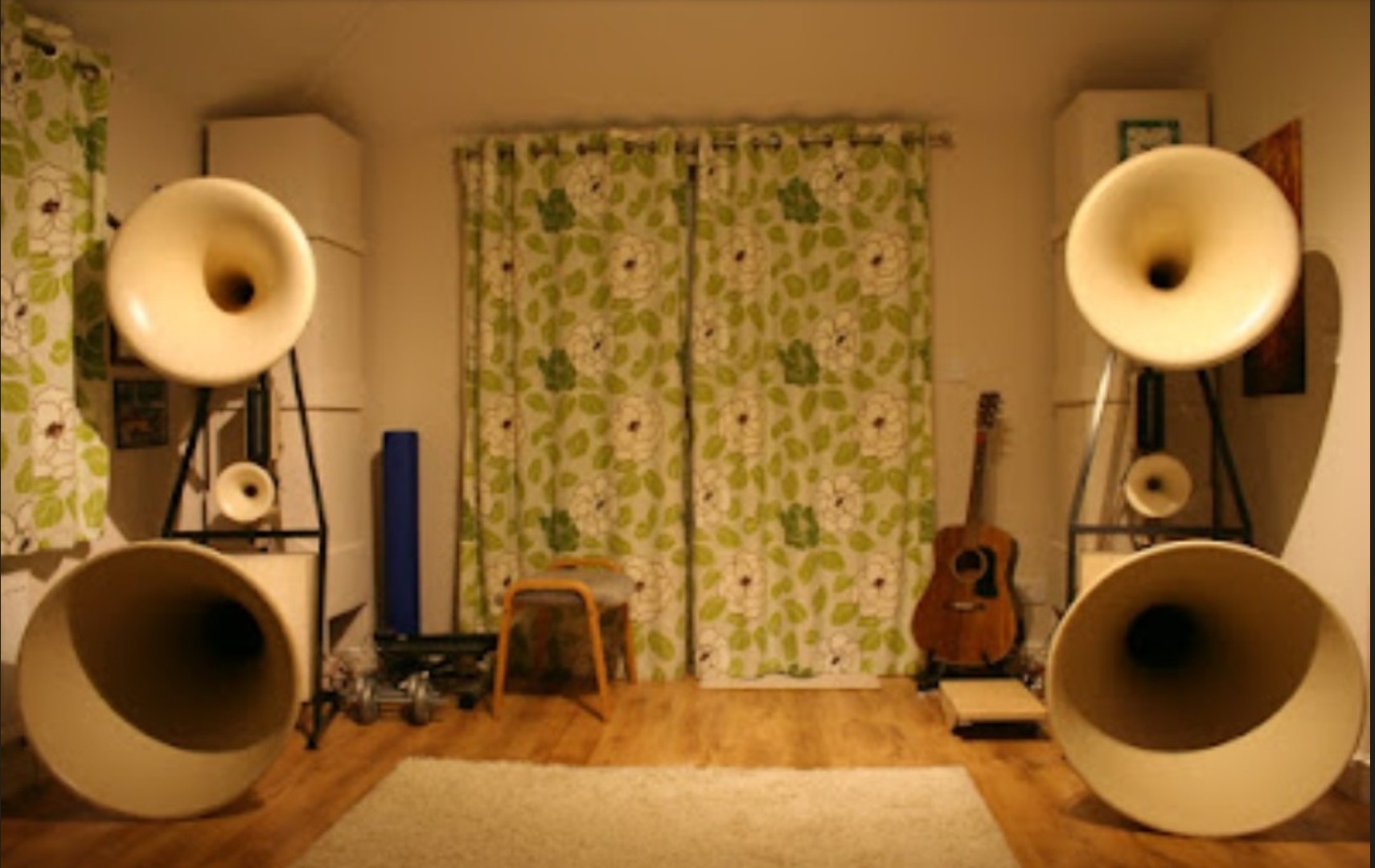

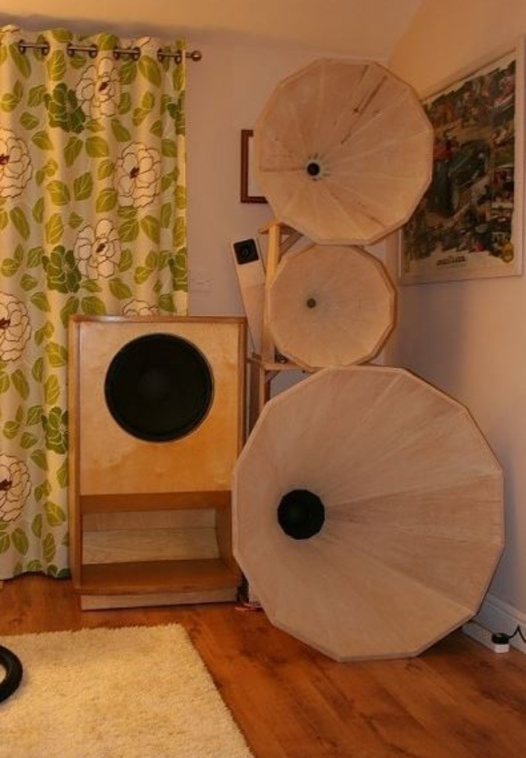

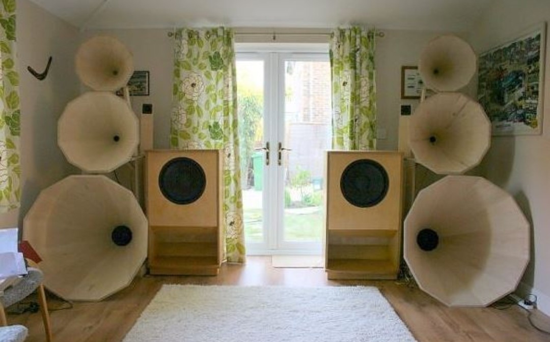

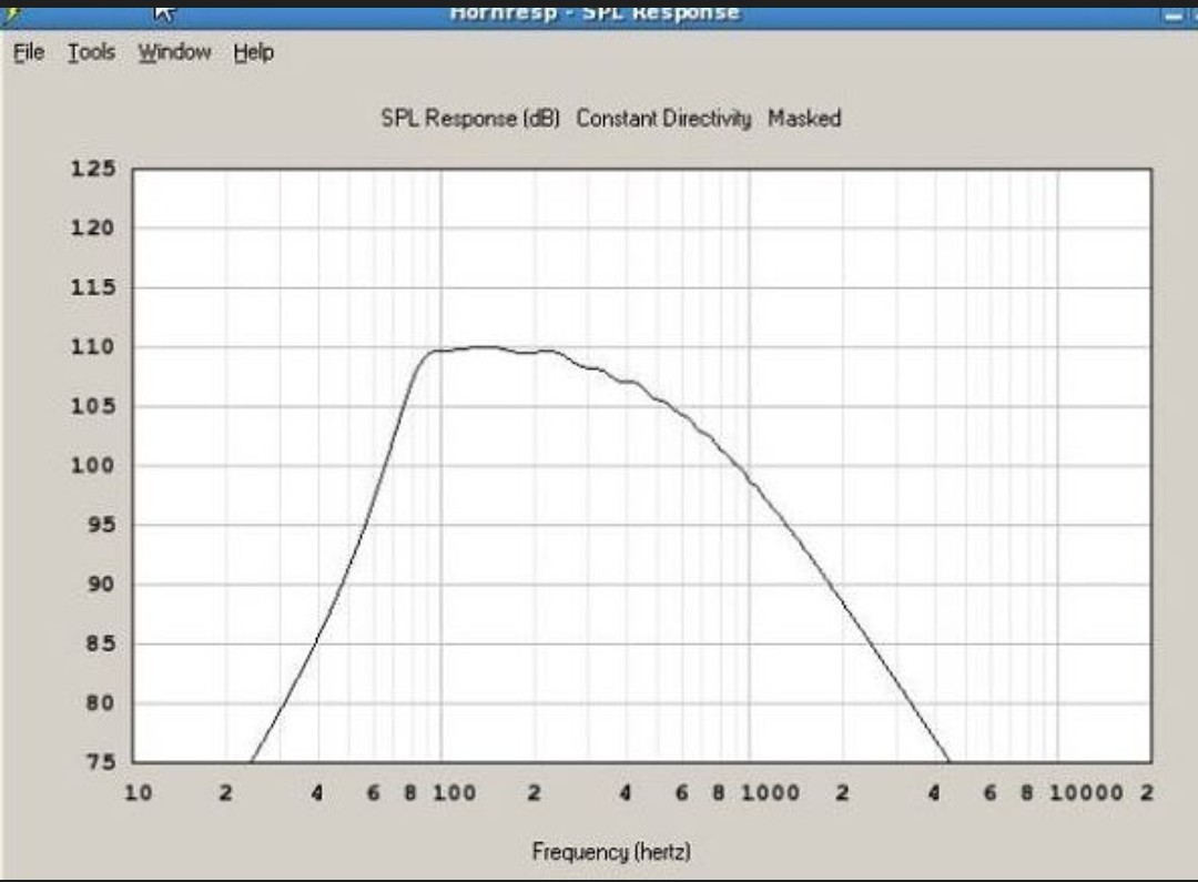

I think there is one last hurra left in the 5 way (mostly front loaded) horn system.
The idea would be top down.
-Raal lazy ribbon tweeters (13000Hz up)
-Vitavox S2s on Le Cléac'h horns (800Hz to 13000)
-JBL 2482s on Tractrix T200 horns (350Hz to 800)
-LF provided by the SH50s (sub 100Hz somewhere to 350)
-Tapped horns (20Hz to sub 100)

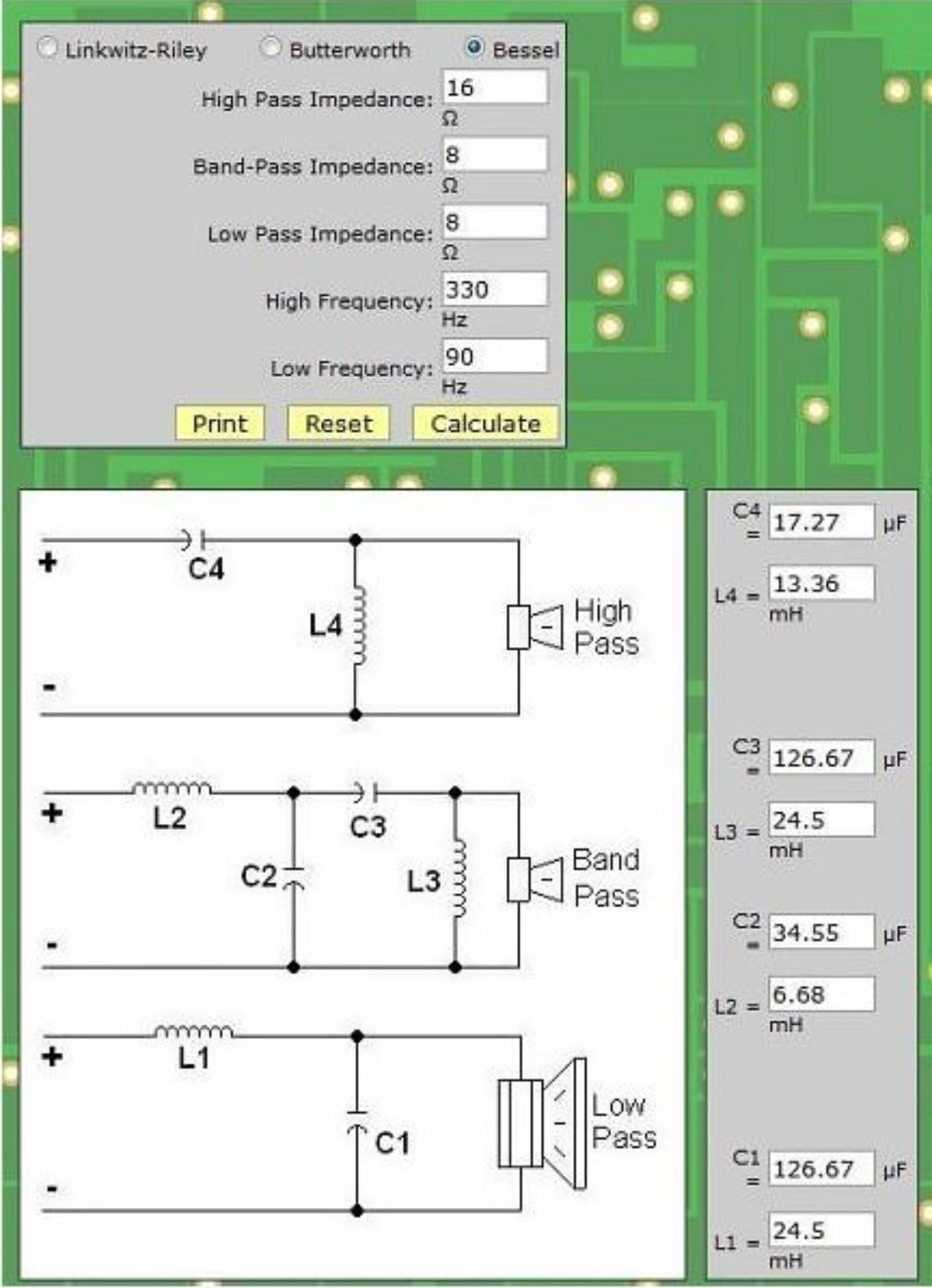

similar to this but with the Tractrix T200 doing mids..
Before I start moving lots of gear and making stands to support the horns in the best positions (centres as close as possible)..
One question for @Cask05.
Would the strategy of no, or the odd 1st order XO here and there, PEQ to trim off unwanted freqs, and with time delays to optimize phase, be an idea to try?
It's the only thing I've not tried with those horns.. kinda curious as to how it might sound.
I could rest it in peace then😂

What is occurring in the "zeroth order" (PEQ-only) crossovers is that they are eliminating the all-pass phase growth of passive electrical filter networks or canned IIR crossover filters.One question for @Cask05.
In loudspeakers not having "unity summation apertures" (i.e., non-MEHs), what you're doing with the PEQ-only zeroth order crossovers is avoiding some of the problems of not having unity acoustic summation across the multiple drivers in the loudspeaker. In multiway loudspeakers mounted on flat baffles having multiple apertures, the output simply sounds better--more cohesive, among the other effects. Some of these subjective effects are enumerated here:

While I do not really condone multiple-aperture loudspeakers nowadays (especially those whose driver centerlines are separated by more than 1/4 wavelength at crossover points), simply eliminating the all-pass phase growth problems on these type of loudspeakers will more or less achieve some or all of the enumerated improvements listed above, to the degree that unity summation of driver output is achieved or not achieved by the loudspeaker's spread-out driver centerlines, the composite loudspeaker directivity control reaches down to the room's Schroeder frequency, and the listening room itself is treated for early reflections around the loudspeakers and listeners' ears.
Chris
Thanks Chris,
Excellent explanation and confirmation.
This will be a project for next winter I think.

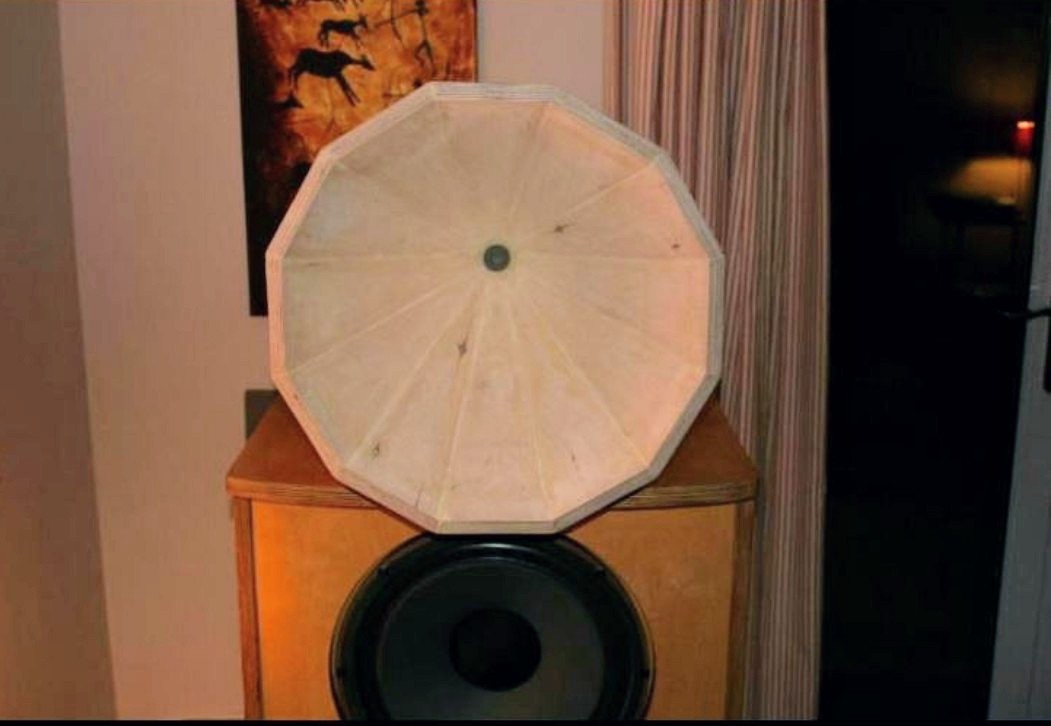

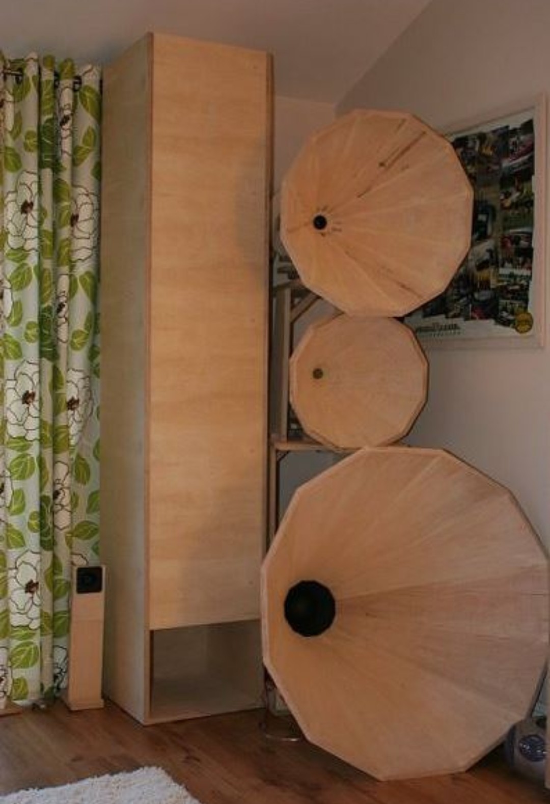

It will be interesting to hear, but I really struggled with the sound of the Le Cléac'h atop the SH50, that distance driver centre to centre is obvious once you've heard otherwise.
No way to get less than 1/4 wavelength distances there.
Esp sitting fairly close in smaller hifi room situation.
I'm still immersing myself in the Synergy sound. Really liking it.

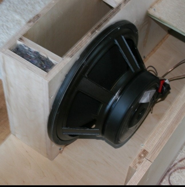

The mid bass horns, once powered by the Eninence Kappa 15As, trialled with Vitavox 15", JBL 15" drivers, then extended and used with Kappa 12As.
Now out in temp storage, on their way to either a new home (unlikely), or as @mark100 knows to well, the skip.
