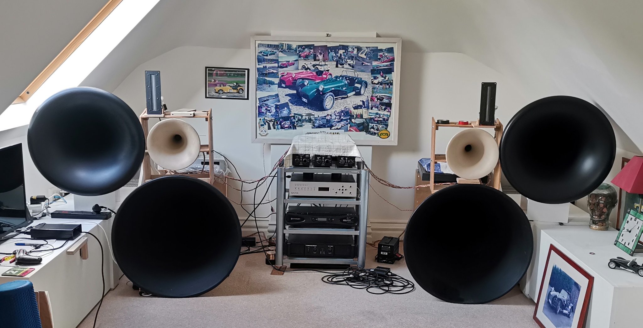

Was up in the attic sorting a few things.
Came across the 400Hz tractrix horns🙂
Instant thought was, Wonder what they sound like with horn length / mouth distance adjusted alignment?
Got them down.
Treated them to better damping
2mm self adhesive bitumen damping sheet. Was left over from another job.
More than tripled their mass!
Fitted to the Vitavox S2 drivers
Get that throat nicely aligned - critical
Both installed
Then I had to re-timealign to the diaphragm alignment, as these 400Hz Tractrix are 45mm longer than the Le Cléac'h 550Hz!
Also realign the Tweeters.
Some 45mm farther back..
Then compute the new mouth alignment delay samples value.
Listening now...
There some different detail.
They are more efficient - had to throttle back the gain to the S2s a bit.
Under evaluation...

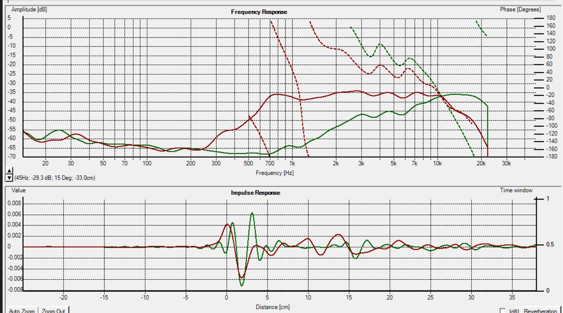

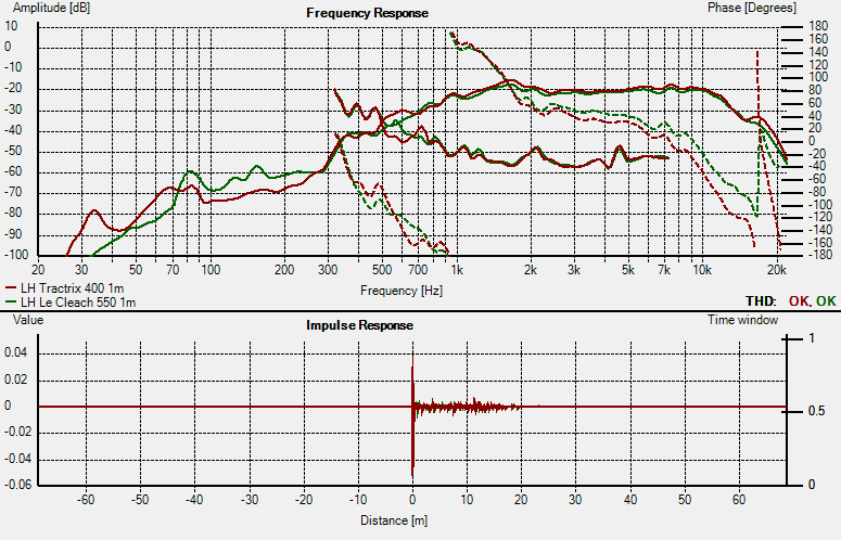

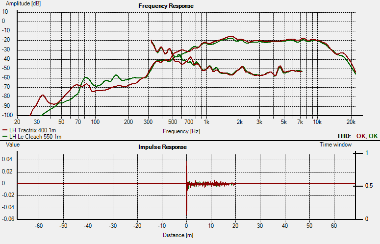

Took some plots.
Vitavox S2 Driver , 3uF Clarity cap 1st order.
No EQ - as always.
Tractrix 400Hz in red vs Le Cléac'h in green 1m directly in front.
Can see the extra gain of the Tractrix!
Without the phase plot
Both sound great TBH.
I'd like to try a 3d printed ATH wave guidey thingy with the rippley throat some day!
Don't think I could make them..
Where is dB scale? If it is +140 and -140 it is not very impressive. I limit to 55-110dB usually.
Silly me, too quick / focused with the snip-it screenshots. Used bitmap save instead.
See above.

Nice work Steve the Swede! How do your wood horns sound compared to other materials? I am curious as you have commented on my folded horns inside my guitar that are Hard Maple 1/4" thick.
Thx, the journey goes on 🙂
I've made the bass horns out of high grade birch plywood.
The tapped horn subs are braced. They play 20Hz to 100Hz, no vibrations or dramas. They still shock and awe me to this day, on the right music.
The mid bass horns are thick round rings of birch plywood laminated up. Again no nasties.

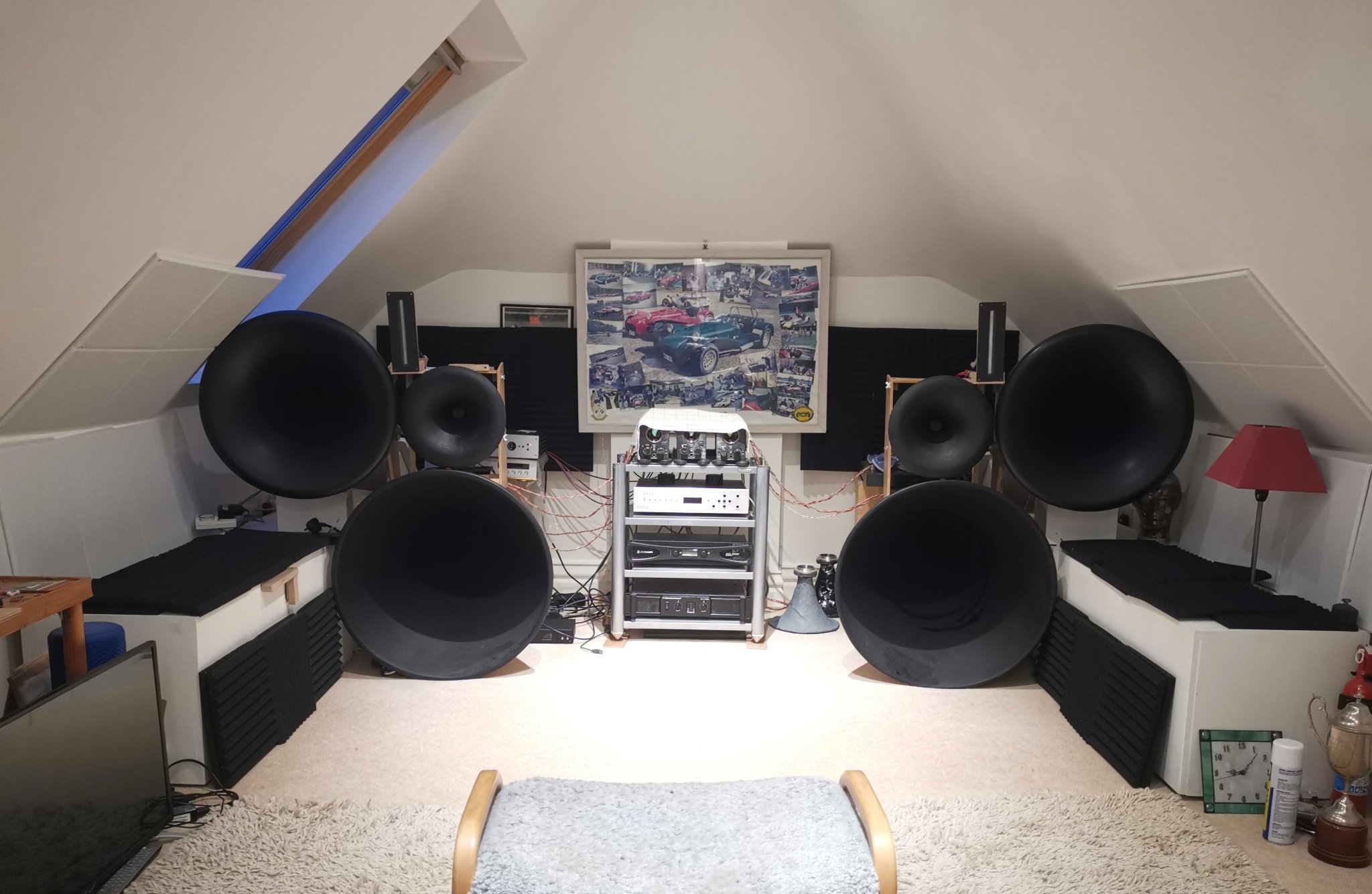

The mid horns (200Hz cutoff), (pictured out wide in current room), are a thick composite.
They didn't ring when struck, but sounded a bit hollow so
I added 3.6mm thick bitumen damping sheet to them.
The sort they sell for car and van panel damping.
The upper mids Le Cléac'h profile 550Hz cutoff (smallest horns), I made of very soft redwood pine, pretty thick.
Using the softest available for this frequency use was written up on another horn forum. Who I am I to argue, they sound great.
I didn't try balsawood though😀
I've also got 550Hz tractrix I turned, and 400Hz tractrix I made in GRP (again heavily damped with bitumen).
It's a toss up between the Le Cléac'h and the 400Hz tractrix sound wise.
I switch between the two sometimes.
But the Le Cléac'h do integrate with the room better and measure slightly smoother.
I think it's a bit different between hifi horns (that should faithfully reproduce the frequencies and amplitudes thrown at them), and an instrument like yours.
There the material you use can accentuate the sound and dramatic affect, give it it's signature sound, so it rocks out🎸🙂
I guess the need for sympathetic, great sounding resonating in an instrument is different to the need to dampen resonations of a hifi horn, so only the accurate tones come out.
I guess you do have consider the need to have a nice resonation / timbre across the whole instrument frequency though.
Or are your horns faithfully reproducing / amplifying the string and soundboard?
In which case you could try damping the 1/4" hard maple.
But you might lose a bit of SPL😱

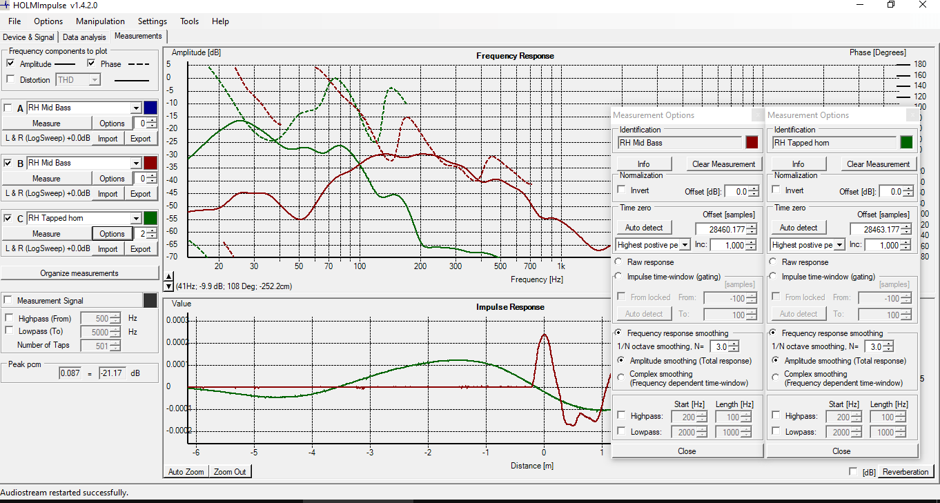

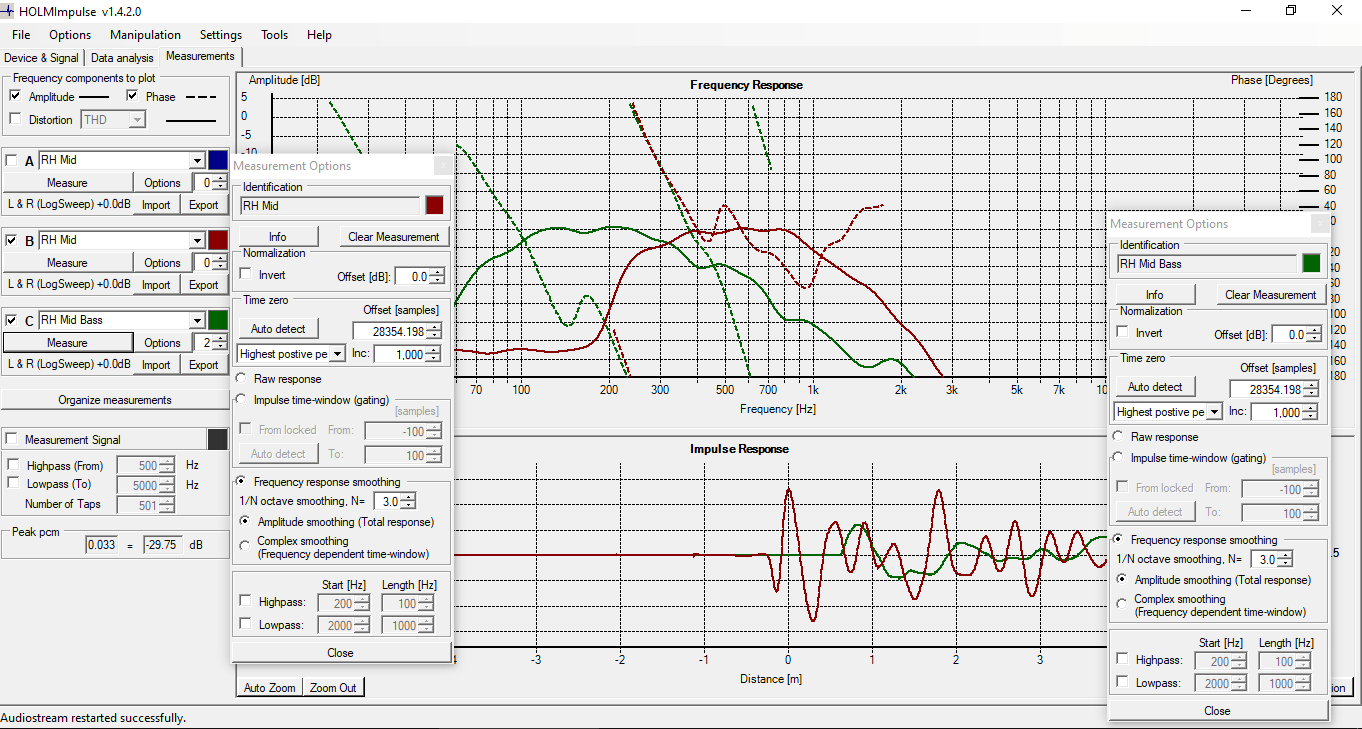

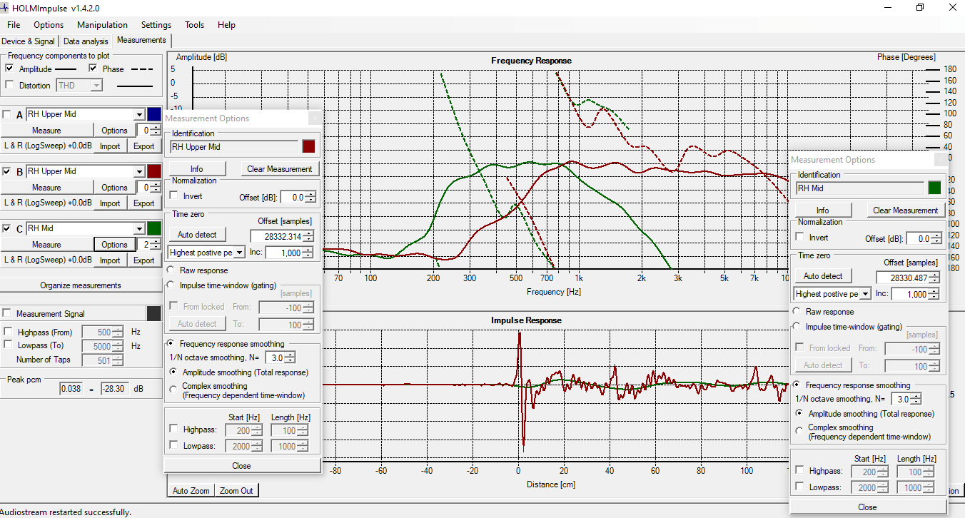

I've been messing about refining the phase alignment.
Got the procedure off pat now, I think
Do these look sensible?
It's the overlap of phase plots I'm concerned about.
Where and how much they should overlap? What best practise?
I've current gone with intersection at the X/O point, rather than then being parallel lines
Is that right?
All taken at the ear listening spot.
Upper mid horn in red, Mid horn in green
Mid horn in red and Mid bass in green
Finally the Mid bass and Tapped horn
Note the room mode bass hump at 30Hz.
Left as it is for comic effect when folk visit. Various tracks vibrate the sofa under them nicely🙂
I've also got a version of the setup with a healthy EQ cut that tames it nicely.
diyAudio Moderator
Joined 2008
I believe part of your question is how far up and down in frequency do they need to remain in cooperation. The answer lies in how loud they are relative to each other. Once each has dropped out sufficiently, you can let it go. Depending on the situation and on the builder, some choose this level to be 20dB or more.
Reactions: 1 user
Thanks Allen that was the logic I needed!

Bass traps are not needed as I EQ the 30Hz room mode very successfully.
I don't have the room for them either..
I found I have to be careful not to over damp the far wall behind the horns, as the system loses a bit of depth.
I tried a wall of material and it lost a bit of that something special..
As I'm damping 500Hz and above, I've found the bass needs a dB or two less.
Easily accomplished.
The side wall damping adjacent to the horns and top surface damping is good, I think. Again less might be more though.
I might try another row of absorbing above the sloping ceiling panels?
I have a bit more further along the side walls you can't see.
It's very much test my way forward.
I think that you need to stop thinking about the electric slopes off your crossover but start looking at the acoustical slopes.
If you look at your Raal slope it looks like a 6dB slope acoustical but your S2 has a much steeper fall of like 12dB or more.
Now you can't align the phase proper because the difference in slopes.
If you have 6dB acoustical slopes the phase should be 90 degrees apart.
If you make 12dB slopes you have to switch polarity of the Raal and align the phases.
Download Vituixcad and play with some filtering and look at the graphs, it has a steep learning curve.
When you make a 2 way in vituixcad with flat driver and impedance and filter 12dB at 1kHz and look at the impulsresponse of the individual drivers you see at the low frequency driver the top of the impulse has a delay.
So when you align the top of the impulse it's not right.
You can also play with delay in Vituixcad
