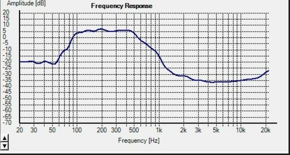

Another driver that models very flat like the JBL 2220A is the Altec 515-8GHP. Both are really good midbass horn drivers and can easily go out to 800Hz on a straight horn.
The 2220 measured in horn using Holmimpulse plays on higher than other drivers I've tried.

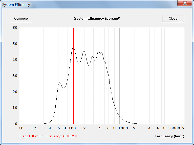

Here's the efficiency data modelled in Hornresp - I've not tried that before, or maybe I have and forgot it was there🙂.
Hi Speedysteve7,
Remember that it is also possible to chart the efficiency, rather than just sampling it at a specific frequency 🙂.

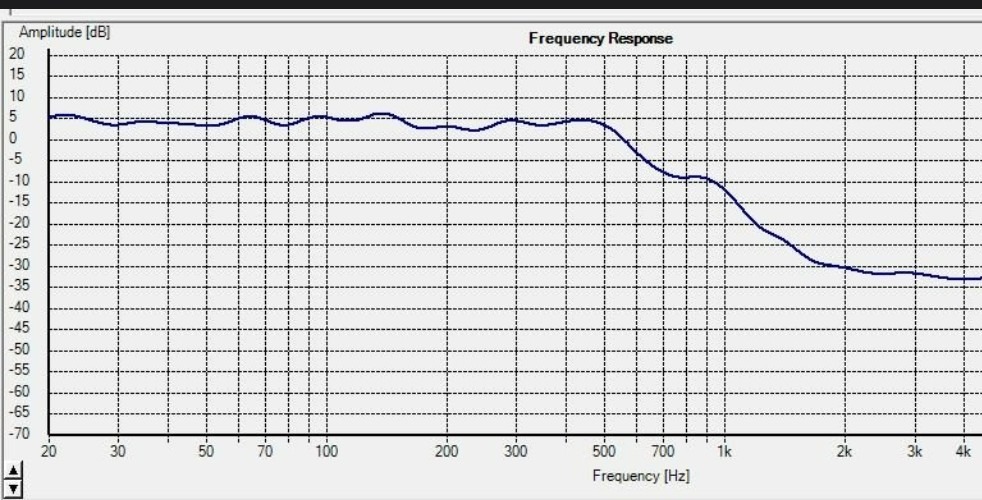

Today's messing about has been to check and then re-optimise the lower 2 channels of the system.
By measuring in room and setting up the crossover points Tapped to Mid bass and mid bass to mid horns to suit the JBL2220's.
I like what I am measuring and hearing.
The 2220's are offering a bit more punch that I've not heard on the short horns before and are integrating very well with the tapped horns.
I am firmly on 4th order X/O's now for the bass channels. 2nd order for the upper mid bass knee and mids. Upper mids and tweets unchanged.
I did try a little higher X/O point (400Hz) 2220's to 2482's as suggested and that's how I've left it for evaluation.
Switching to the old setup shows its short comings.

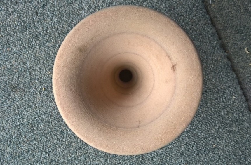

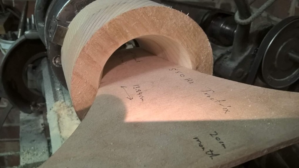

I'll be testing some softwood (redwood pine) turned Tractrix 550Hz cutoff horns on the Vitavox S2's soon.
Be interesting to compare how they sound against my birch ply ones...
Romy has always said use as soft a wood as possible. Balsa would be too soft to even work - so went with pine.

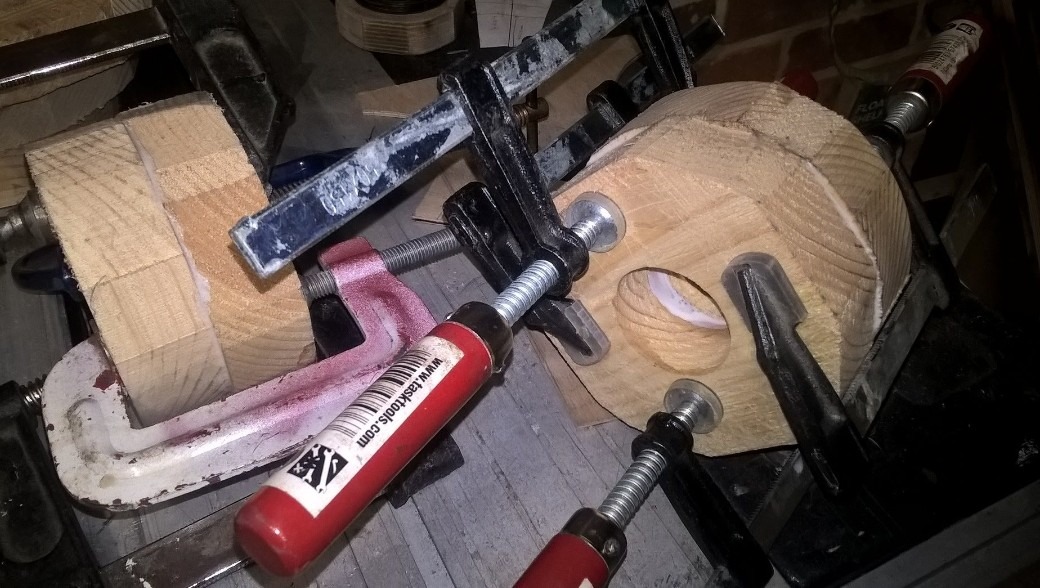

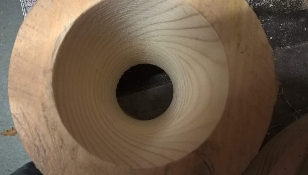

Here's some pics of the turning.
1 section
2nd sectionl
Aligning to the template
I've got more pics on the big camera - must get around to uploading them. Windows phone and One drive auto upload is soooo convenient.

Be careful what you use to coat it. I used wood oil for one horn and it made the glue release. It was a mess.
🙁 that much have been rather heart breaking. I suppose re-bond and sand and they were OK again?
I will choose spray filler to enable me to sand to a really smooth finish and then spray paint - like I did for the birch ply protos only even better🙂

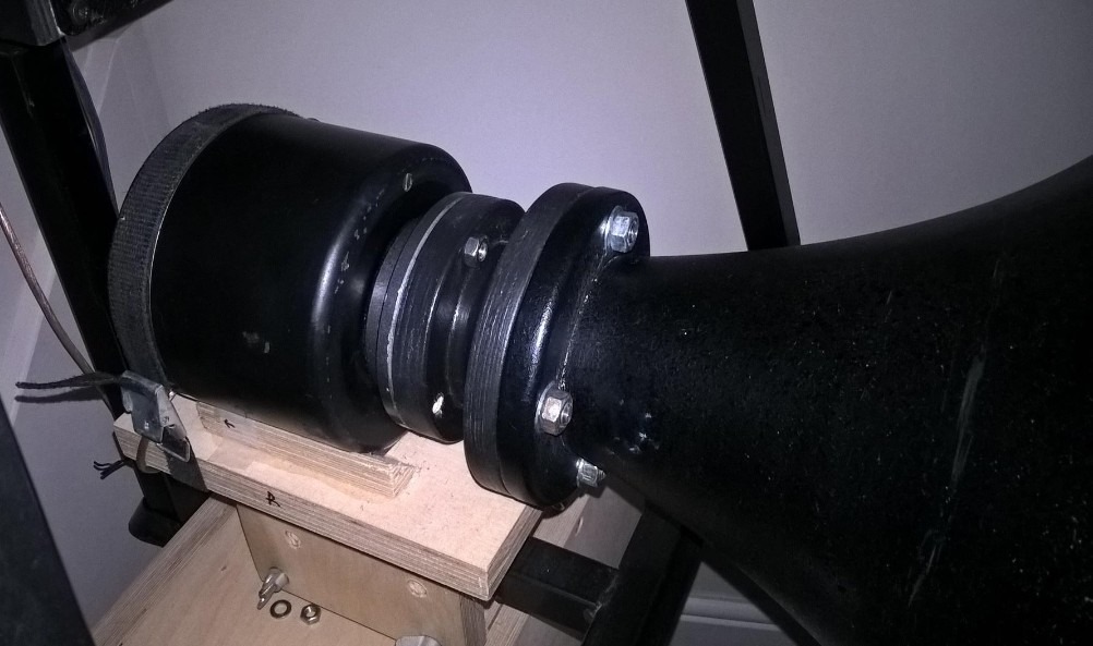

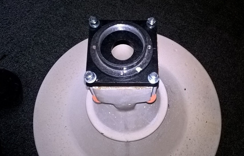

I've played around and a nice throat adapter added to my existing horns to go from the larger throat to what I need for the 12" drivers and add the needed length too, is easily doable.
The mouth will be a little bit smaller than optimal, but not by much.
If I like the SQ then a couple of extra big rings would see the mouth sorted too!
So a couple of hours turning a pair of throat adapters and get me some nice 12" drivers and I'll be able to comment😉

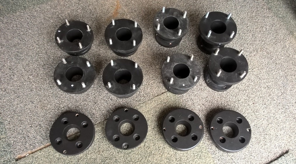

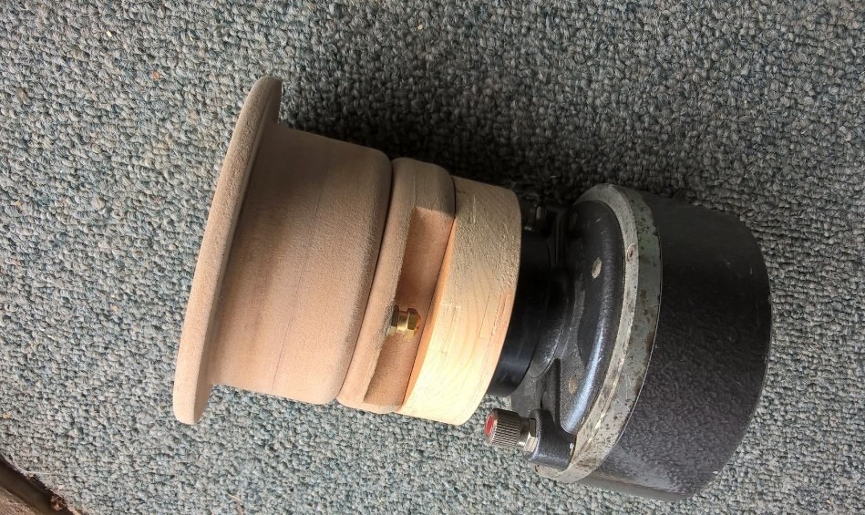

I've also been making some adapters for Vitavox S2 and other horns for a fellow horn enthusiast and testing his 400Hz horns and some screw on adapter rings in brass - outer ring will be polished up when finished, Will also be faced off to 18mm thick so the horn throat contacts the driver.
Testing in my S2s.
Testing in my S2s.
