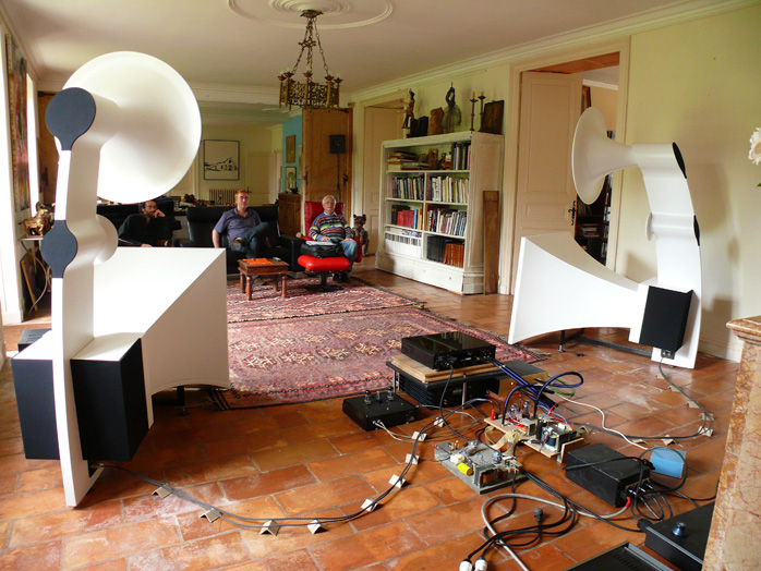

5 way horn speaker system project - tapped, bass, mids and tweeter passive active
I've been living with the long horns for quite a while now and I like them.

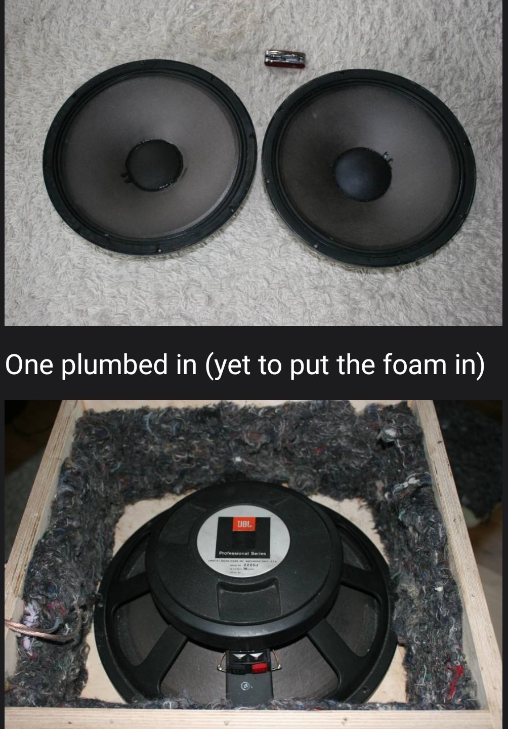

However, today Jack (aka NSM) was over with his JBl 2225J 15" drivers. These are 16ohm drivers.
He's kindly lending them to me.
I loaded them into my shorter / larger throat round exponential mid bass horns for a trial - I have a pair of JBL 2220H's on a slow boat from Canada arriving at some point so the 2225 are for loan and a test out.
Initial thoughts were that they were a bit lighter on bass compared to my Kappa 15A's on the same horn, but as we played all sorts of stuff, but centred around rock and heavy rock / bassy stuff they got better and better.
2 scenarios cam to mind. One is that they were NOS as they look absolutely mint and we are running them in and they were freeing up. The other is that they are little used and have sat on a shelf face down for years and years and the suspension etc went through a similar freeing up.
By the end of the listening session we could not really fault the bass coming form them.
Jack asked me to turn the tapped horns off and on at several points and then commented on how much sub 90Hz stuff they do and how well they do it.
A bass scale on one track from a 5 string bass all the way up appeared completely linear and transitionless or rather free from transition issue.
I think this is attributable to the proper time alignment factor - only possible since Najda DSP has been on the scene.
Note this was on 4th order X/O's on Tapped horn and Mid bass horn.
Switching between 4th order on the above and 8th order it depended largely on the material being played whether we favoured one or the other...

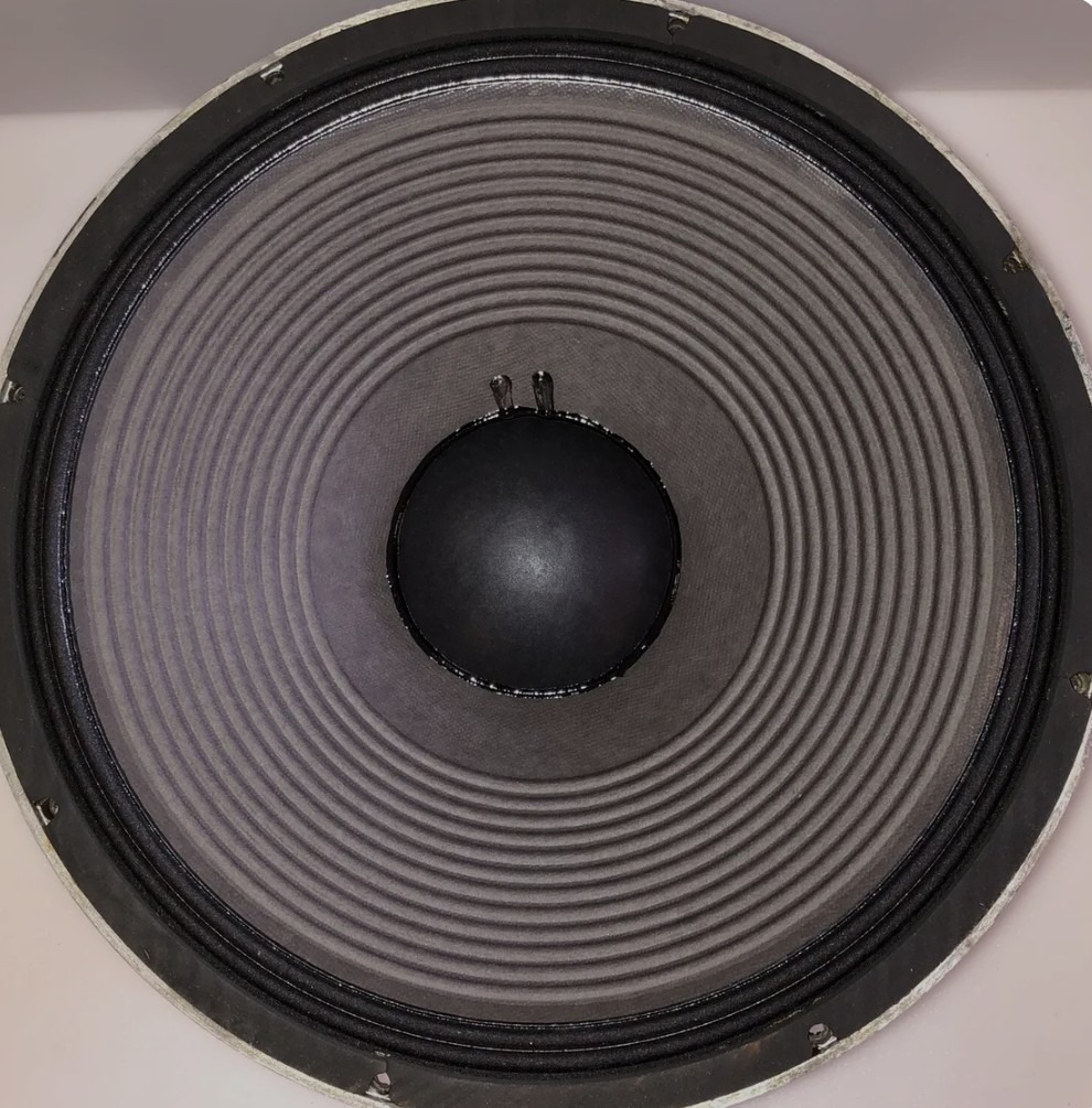

A bit more on the veteran JBL 15" drivers.
Here's a pic of how the JBL2225's look - I like the ribbed look
The 2220's look like this (not as cool but does not matter as you can't really see them in the horns).
Both share the same piston area which is a little greater than other 15"'ers I've used (due to deeper cone).
I keep meaning to measure the 2225's, but they sound good as they are with the slight room correction in place for the Eminence Kappa 15A's.
Be interesting to do to see if its the horn, room or driver that one is correcting... Probably a bit of all.
I find the 2220 cone too thin and weak in a horn and may have problems driving smaller throat horns. It is more sensitive then the 2225 and should have better high end extension. I find the 2225 is the better bass driver though.

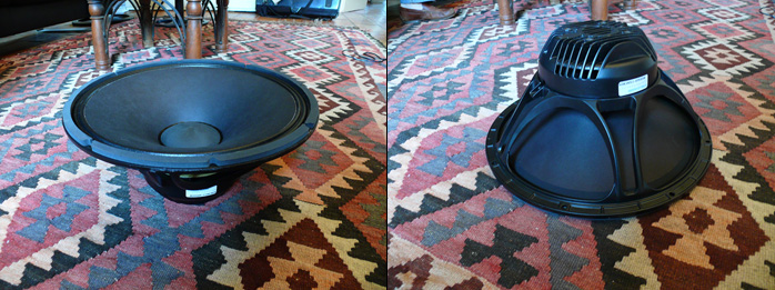

The 2220's arrived safe and sound!
More texture to the upper bass coming from the 2220's I would say.
Lower down it's a bit more difficult to deduce big differences at this stage.
Some JBL users have commented that the 2220's do not get on so well in small throat horns - I have quite a large throat on these at the moment.
In fact only 0.5cm radius bigger than the ideal Hornresp model for the 2220's! Would I hear the difference - perhaps, but perhaps not.
