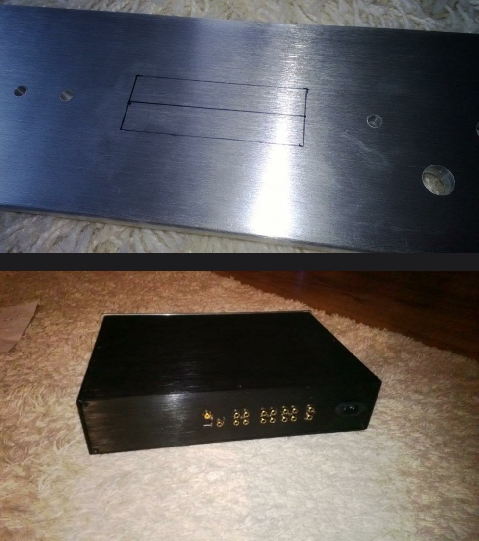

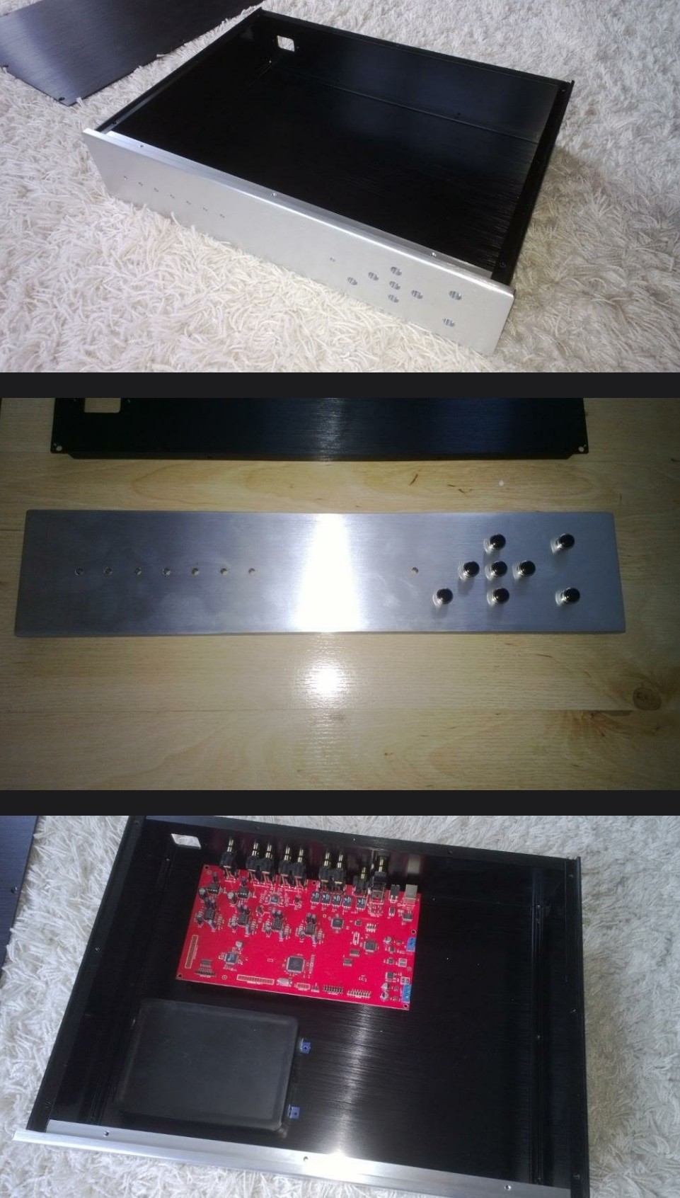

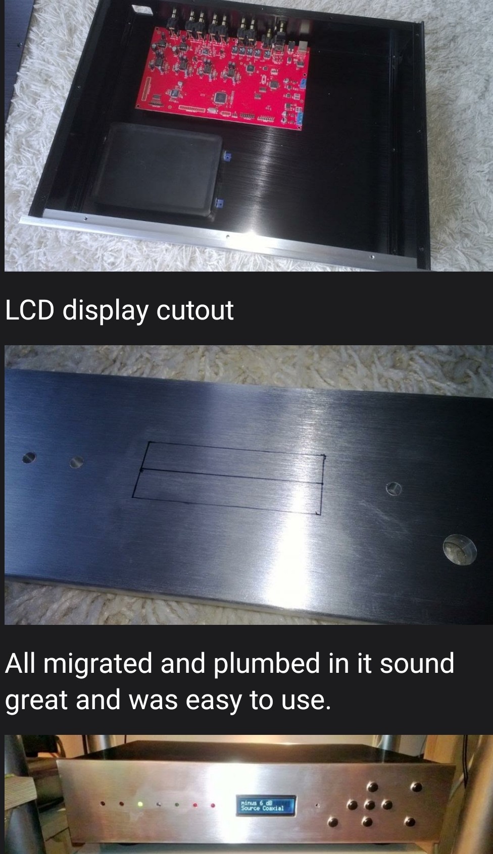

Well I hit Najda and this is fun...
I put 48dB/oct (8th order) on Tapped and mid bass. Boosted tapped horn by 2dB and mid bass by 1dB as first cut.
Then A/B listened to Nevermind - Nirvana
Like it. Tightened things up, improved speed / punch and made it suitably fake tits bass as Mr Coco would say.
Then I put a high pass on the tapped horns at 30Hz also 8th order. Tried it at 35Hz and 40Hz but went back to 30Hz as 5 string bass / synth bass will hit this.
I took 1dB off the 35Hz PEQ room correction too.
As a further test I put 8th order on everything (bar the tweeter). That kinda compressed things - in a rock sort of way. May be a bit too far have to play backing things off and on until I get it right.
This setup is beginning to kick *** now, mofo betch! its the bomb!
Time for a proper case for Najda.

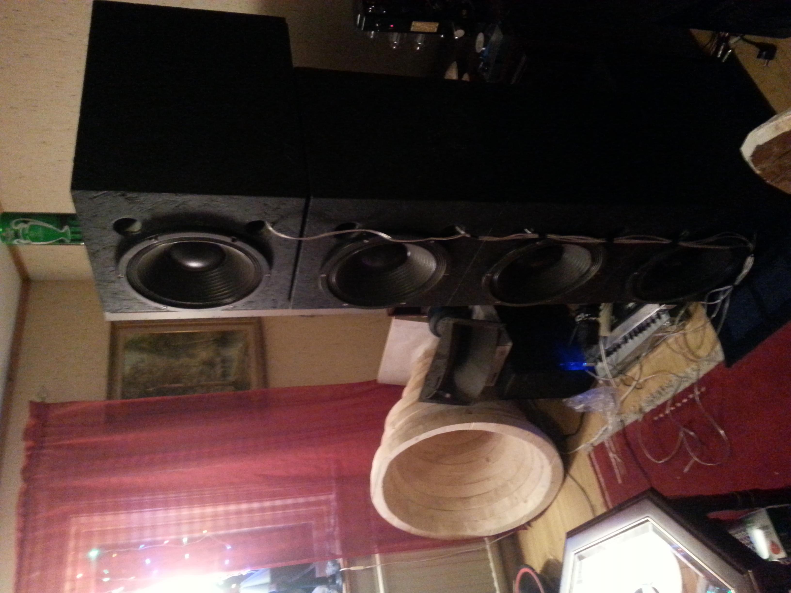

In the meantime I am trying to solve midbass. I made a replica of your horn in solid pine and last night I finished a Meyer Miko 120 replica with originsl woofers The milo is more neutral and balanced but yes a little more boring and sensible I like them both. I will probably use them both. 🙂 My GF said the array make the horns look so small so now I need bigger horns! Okay!

Nice work on the bass horn. Not going to resonate. Are you making a second one? I found it hard to tell what was what with just one.
I have to apply a little DSP correction on mine for a room mode - forget where 130 or 150Hz I think it was.
I am making a pair of 1.2m long rectangular exponential bass horns at the moment for 15" drivers at the moment.
Be interesting to see how they sound.

I am not sure what I will use in them. With horns I prefer 1st order but that doesn't work with 15" drivers unless I find a very nice driver. I have not bought the Eminence 15A yet, and I am very curious how that will sound. I stuck one of the Meyer woofers in there and they had a cool snare drum snap but I could not use them with 1st order. It sounded a bit warped and weird. Hopefully I will not have that problem with the 15A.
Are you making the new horns because you are not satisfied with your current horn?
I would like to use the Milo replicas as a fill in to be sure I have an overall balanced sound and use the horn for added presence. On the right side I have a midbass horn of similar dimensions but with a 4" throat suitable for a Fane 8M. In comparison, the smaller throated horn have more compression and more detail around 200Hz, but I think it has a little too much intensity. The lower compression of the left horn has a more mellow sound to it which I like. Still has a lot detail. I have only tested with 12" and 10" drivers so far. It is almost too mellow. A horn in between would have been nice. I still doubt your midbass horn should be used below ~140Hz. A driver that goes lower will maybe have too much issues with warped sounding bass, I don't know. And a driver that goes deep will have less detail in the midrange. With the Milo filling in the rest I don't have to worry too much how low I should push it.

I am making them for someone who does not have length constraints. Will be 1.4m long in driver chamber.
When I modelled the exponential it came out with a smaller throat than I expected. I made them a bit longer so I could try different throat sizes - with some work to change things of course.
I was coming from 1m long conical bass horns with quite a large throat (20cm diameter), and they sounded fine / I had become used to them.
On trying the round exponentials (which modelled better in the upper freq region than the conicals BTW), with the smaller throat I thought they sounded a bit weird. Like you describe perhaps...?
I successively reduced the volume of the driver chamber right down and made the throat larger. This got me the sound I liked from the conicals but I found I had more detail / texture in the upper frequencies.
Trying different driver chamber vols with the conicals was inconclusive.
So, I conclude (oversimplified no doubt,) that the 15" drivers like bigger throats than indicated from the modelling.
I will soon find out if the longer rect exponential horn sounds OK with a smaller throat.
Successive mods to follow should it not.
Horn bass is not in your face in the same way as box bass IMHO.
It is more subtle and textured. Bass guitar, church organ, drum solos sound great to me. There is much detail and speed.
Thumps and bumps and muddy wads of bass that you get from other solutions are not there. I think they take a bit of getting used to - kind of you have to educate your ears to the new sounds. All IMHO of course. It's whatever floats your boat.
