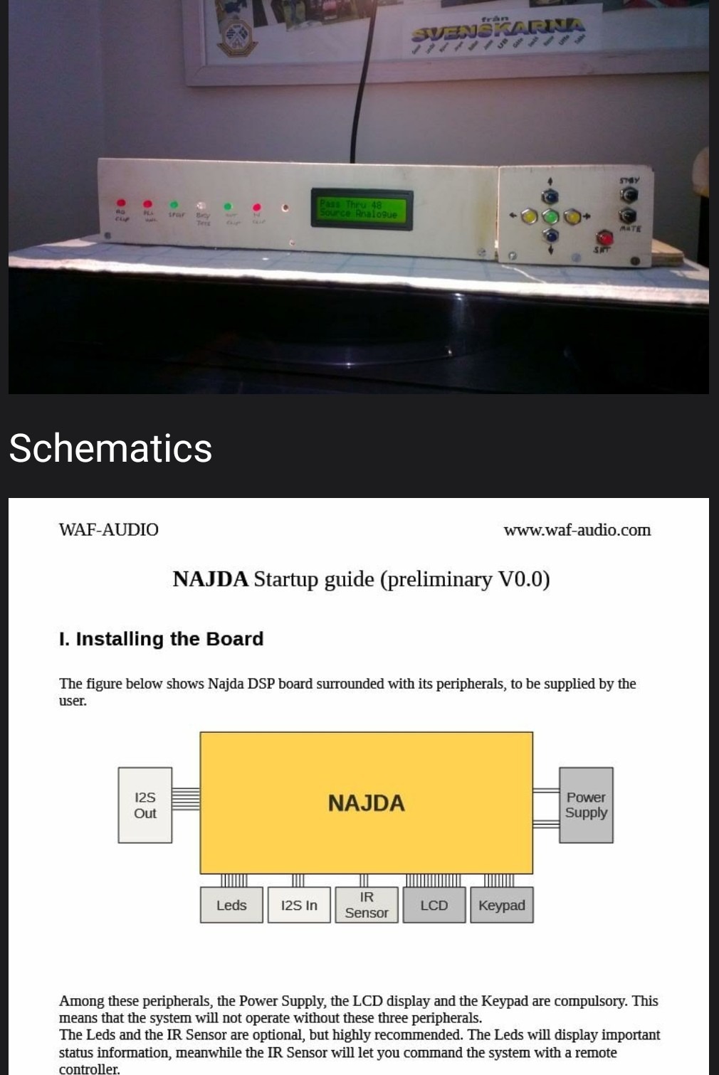

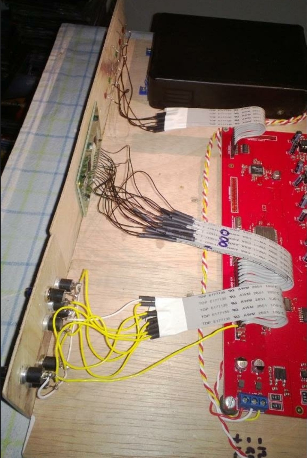

I have been on the WAF Najda thread a while and took the plunge.

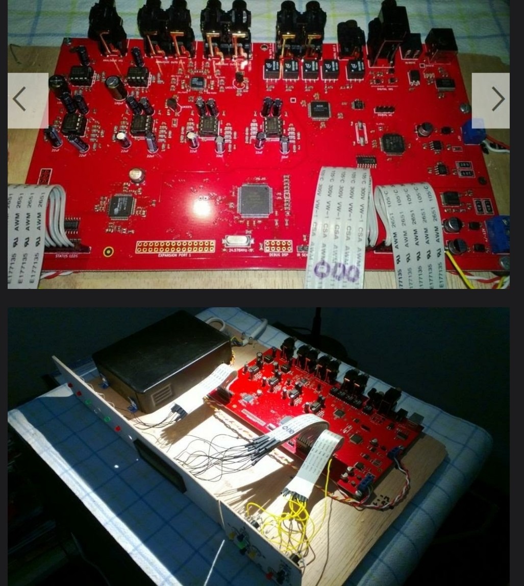

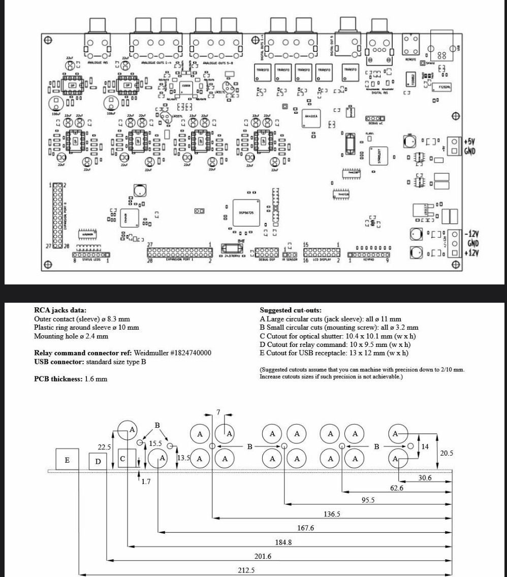

The board arrived.
Got the other bits, Mouser +5v and 12-0-12v SMPS.
Cheap LCD display, buttons, some ribbon connectors etc.
Here's the board.
Lashed up on a breadboard to start with.
From the front🙂 and schematic

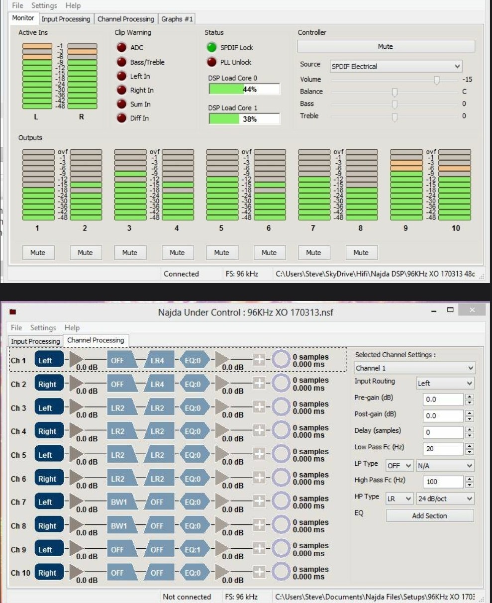

The control panel when connected to PC and the config panel.

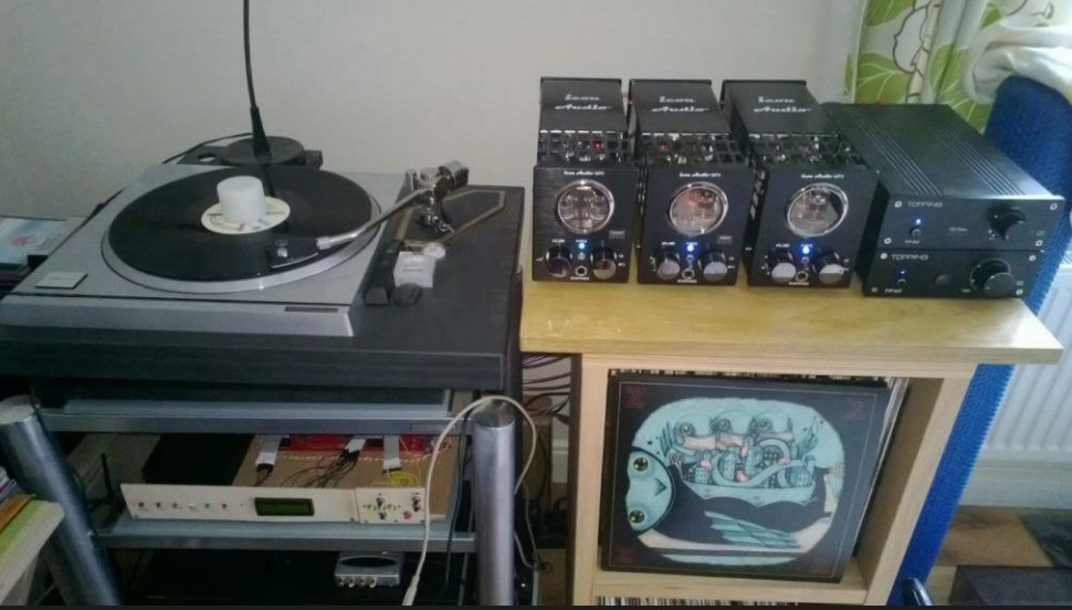

In situ

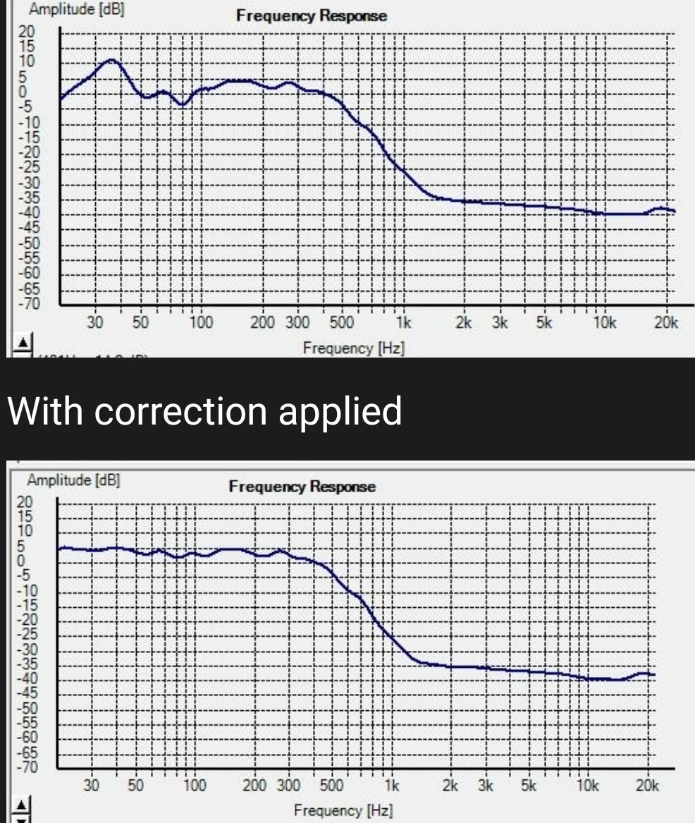

A few corrections on the tapped horn

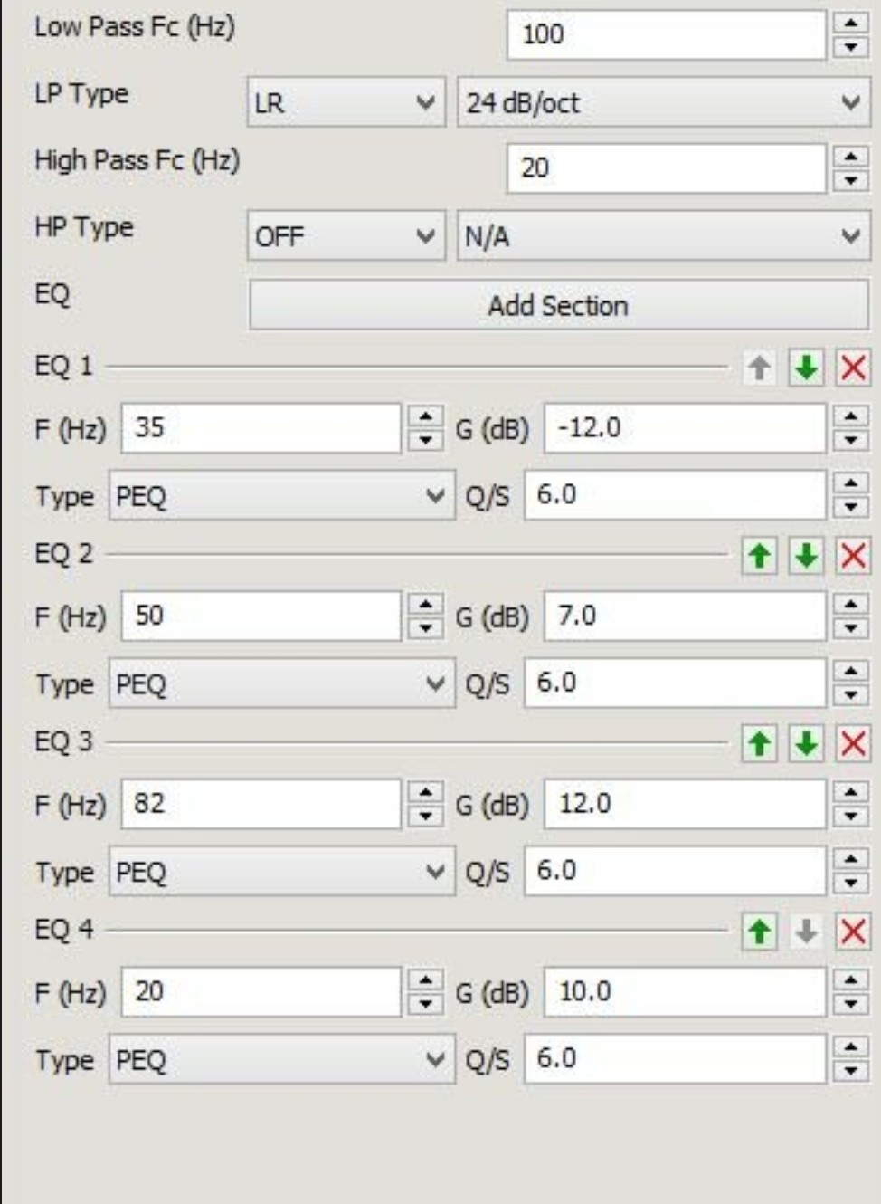

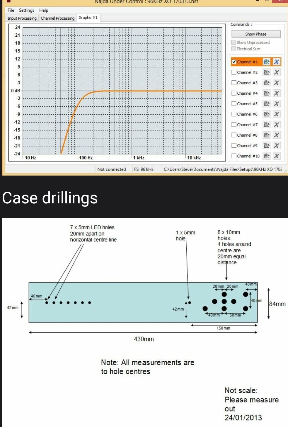

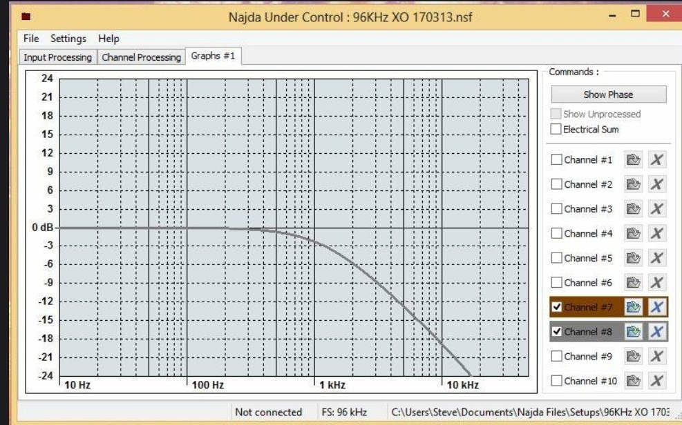

In the meantime I am going to play around with Najda DSP SPL levels to see if I can increase the critical 'float my rock boat' frequencies and boost them or rather cut the others and amp up the rest.
Then I can have a DSP Rock setup which is easily flicked to. Thanks to Ritchie (Hayward) of the Wam for that idea.
