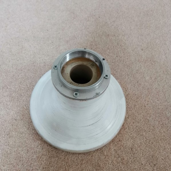

Roughly sprayed up to match existing horn. Screw on adapter in place
Not bothered finishing the backs to match yet - wanna hear the results first... Makes a nice solid unit the driver is heavy but can be picked up by the horn no problem.
In situ ready for test listen (felt damping pads left off for the pic)
From the front
Listening as I type the sound is perfect - no problems integrating (I did not expect any TBH).
Obviously I'm listening RH channel upper mid horn I've just made vs Cube Audio GRP one. Can't tell any difference so far.
A pair might tell me more - Will be making the 2nd one tomorrow

A lathe helps with these projects. I came across a website where a great looking pair of horns were made with a router and skill - respect.
I am about 1/2 way through the 2nd tractrix horn. The drive belt on my trusty old South Bend let go so that stopped play for a while. I took the opportunity to re-design the belt / mandrel / belt tensioning system and keep a spare stretch of drive belt in stock so up and running again.
Should have a pair to listen to tomorrow evening.

2nd one in and working. Sounding fine. The clean effortless perfection coming out the Vitavox S2's never fails to amaze.
Yet integration and progression is spot on too.
Only primed up at the moment. The screw on fittings mean I can whip the horns off / on with the drivers left in place

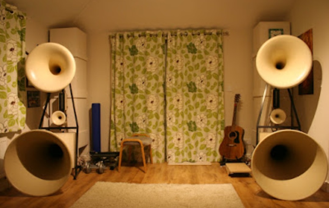

Here is what Bonzo wrote following his visit:
"Thanks very much for the session. I have heard 2 way Cessaro's and 2 and 3 way Avantgarde's, also Tune Audio Animas, so it was awesome to compare them to a 5-way horn system which was DIY. Steve ran me through what each driver meant and what specific frequency he covered. I had never heard a church organ in an hifi before, but Steve's tapped horns go down so low that it feels you are listening to new notes in classical, one that you would not know existed.
The power amps and the room correction box are cool too. Normally I don't like room correction, but in Steve's system you don't notice it. Also I am a non-vinyl guy so far, but something in Steve's TT had me sitting up. Steve also knows the ins and outs of the physics of sound, so it is generally fun talking to him, and seeing a DIY set up without room treatments that sounds great. Each of his horn has a different driver. I guess most people into DIY and horns on this forum know Steve, but for others I would strongly recommend you visit Steve, Purite Audio, BD Audio to see the differences in horns and how they compare to normal box speakers - suggesting this as someone new to hifi I had the wrong perceptions about horns before, which I think are shared by quite a few, so best thing to do is go out there and listen to some horns"
To be clear - I only use a few PEQ fixes for the tapped horns and mid bass room modes - nothing elsewhere.
