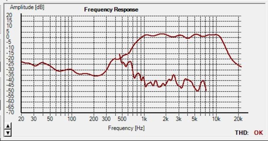

Here's a measure of the S2 on a 3uF cap
The Romy the 3uF call works a treat.
The S2 survival guide thread has been helpful. Just as he hoped.
Not sure where the up to 15KHz went though...

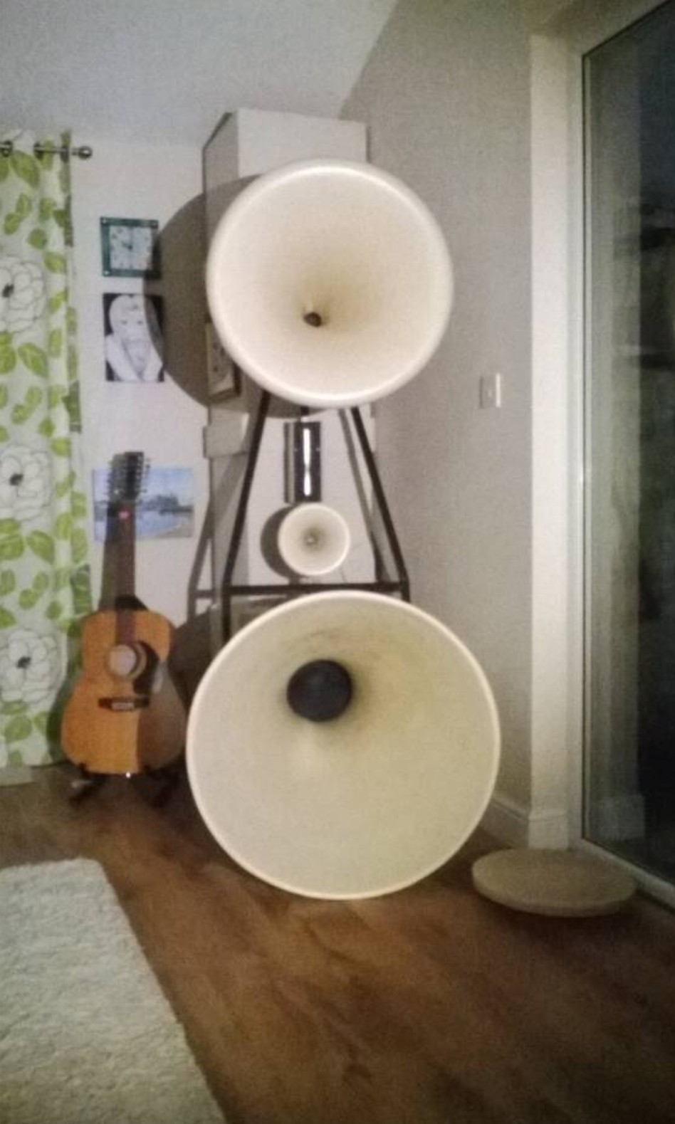

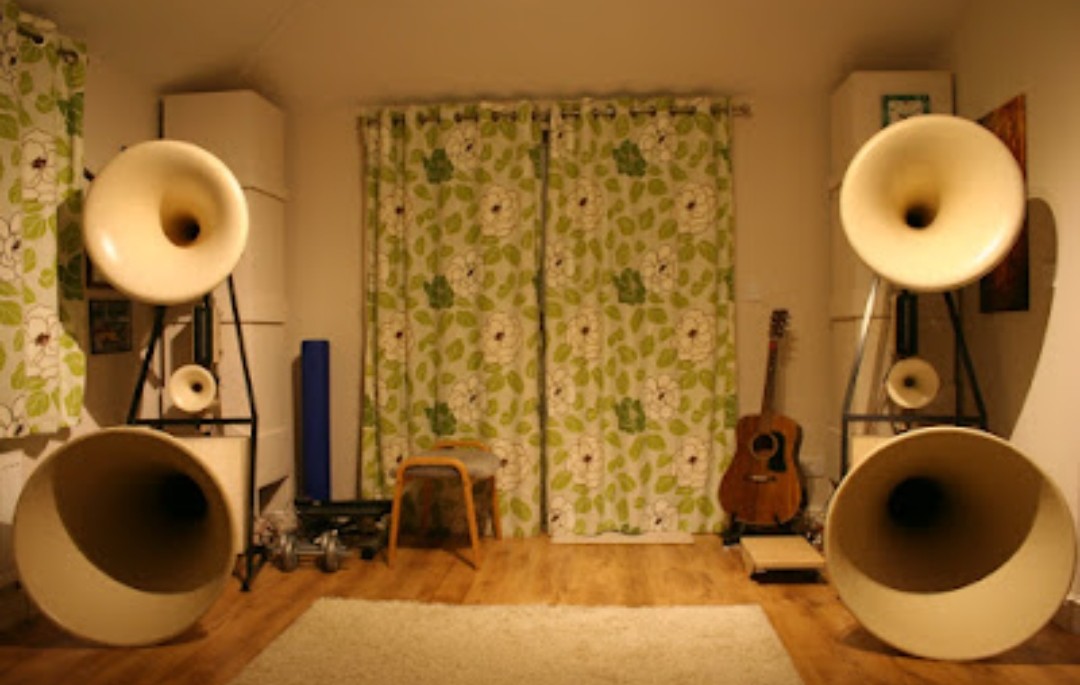

Today, I moved the horns so they are more physically aligned, distance wise from the front, as opposed to time aligned.
I then set about time aligning them in Najda DSP X/O.
Here's how they look on the lashed up supports. Can be prettied later if the experiment works.
I am still having to time align the Raal Lazy ribbon tweeters physically as they are off the same line feed as the S2's. The Najda DSP only has 4 stereo channels, until the expansion board if completed. Hence they are much farther back than I would like...
However, this has brought the tweeters and especially the upper mid horns into free space. No reflections off the side of the tapped horns.
Alignment now done in DSP. I had to start out with a enough of a delay to allow the other horns to be slightly ahead of the tapped horns of course.
Having done it the other way around I knew the rough ball park figure of delay and added some. So, even the tapped horns are delayed a very slight amount in the digital domain.
Sounds a bit different. Less volume on the Upper mids if anything = less reflection addition I guess.

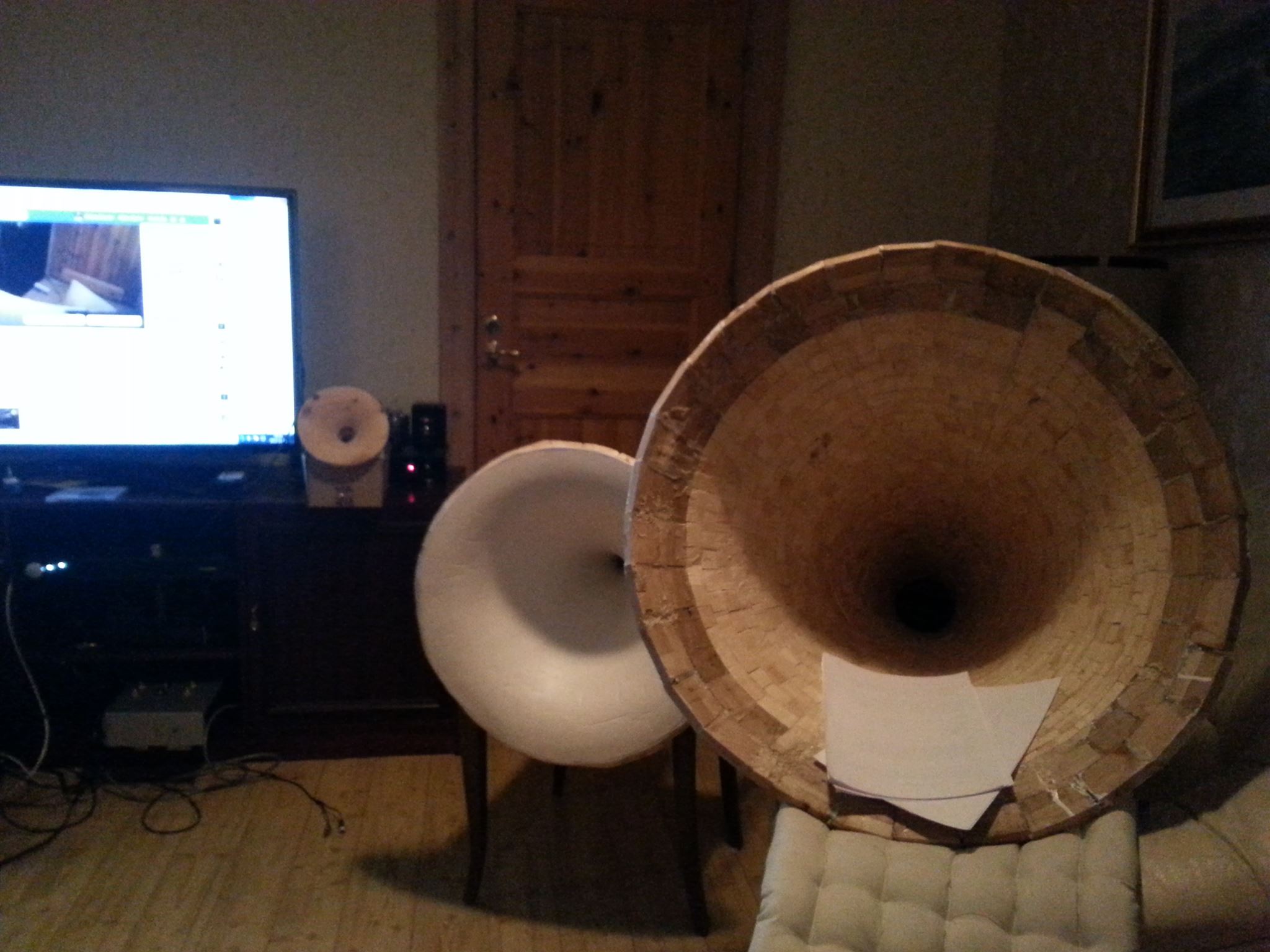

Here's how it looks now with wider horn placement.
MVH Steve

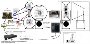

Summary of my system:
¤ 25-80Hz LAB12 subwoofer, in horn, or without. Will have its own analog out channel from the Minidsp or analog active XO.
¤ 80-340Hz JBL 2202H, soon with custom alu dustcap (still prototyping horns). Will have its own analog out channel from the minidsp or analog active XO.
The following three channels will hopefully share a passive XO that divides the signal from one digital out channel from the minidsp, that goes into a higher quality DAC and uses a fancy 45 SET tube amp.
¤ 340hz-~1000 Yamaha JA6681B in large custom made horn (still prototyping horns)
¤ ~1000-3500Hz Yamaha JA6681B in large custom made kugelwellen inspired by AG Trio midhorn
¤ 3500Hz-9000Hz Yamaha JA6681B in large custom made horn inspired by AG Trio tweeterhorn
¤ 9000-30 000Hz Transmission Audio 50cm true ribbon with RAAL trafo in custom horn. Will have its own analog out channel from the Minidsp, but I fear the cymbals will suffer greatly. Analog active XO would be preferred! This true ribbon is not as sensitive as the rest of the compression drivers and JBL 12". I am not sure yet what amp they like. This channel is somewhat of a mystery and it not in use yet.
I have found 2nd order to be good for everything except the LAB12 sub which seems to like LR24, for some reason.
I am guessing you are doing something similar. Are you still crossing a pair of crompression drivers down to ~340Hz? I have found an extreme way of doing so, using a replica of AG Trio's largest horn with a 4" to 1" adapter-extension. It is most certainly too big, but it sounds magical. I may reduce it slightly with wall paste. It is hornloading so low into the midbass area, that it is giving me a headache when I am trying to match that clarity of sound with a paper cone 12" JBL driver.
Your ribbon channel is the completely passive one? I could do this for my own ribbon.
Oh, and ignore the midbass horn with the oak rim in the picture. It is slowly being replaced with something larger. 4" throat was not enough for a 12" JBL driver.

Turns out if I start preparing for a DSP-less lifestyle I can save some money on SET amps.
What can you tell me of this hypothetical solution?
BTW, how can you have a clean signal that does not go through the DSP unit for your ribbon tweeter? Do you start out with analog, convert it to digital and then analog again? This would be very deteriorating for the signal.

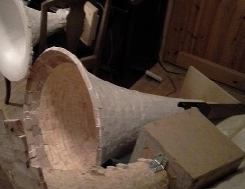

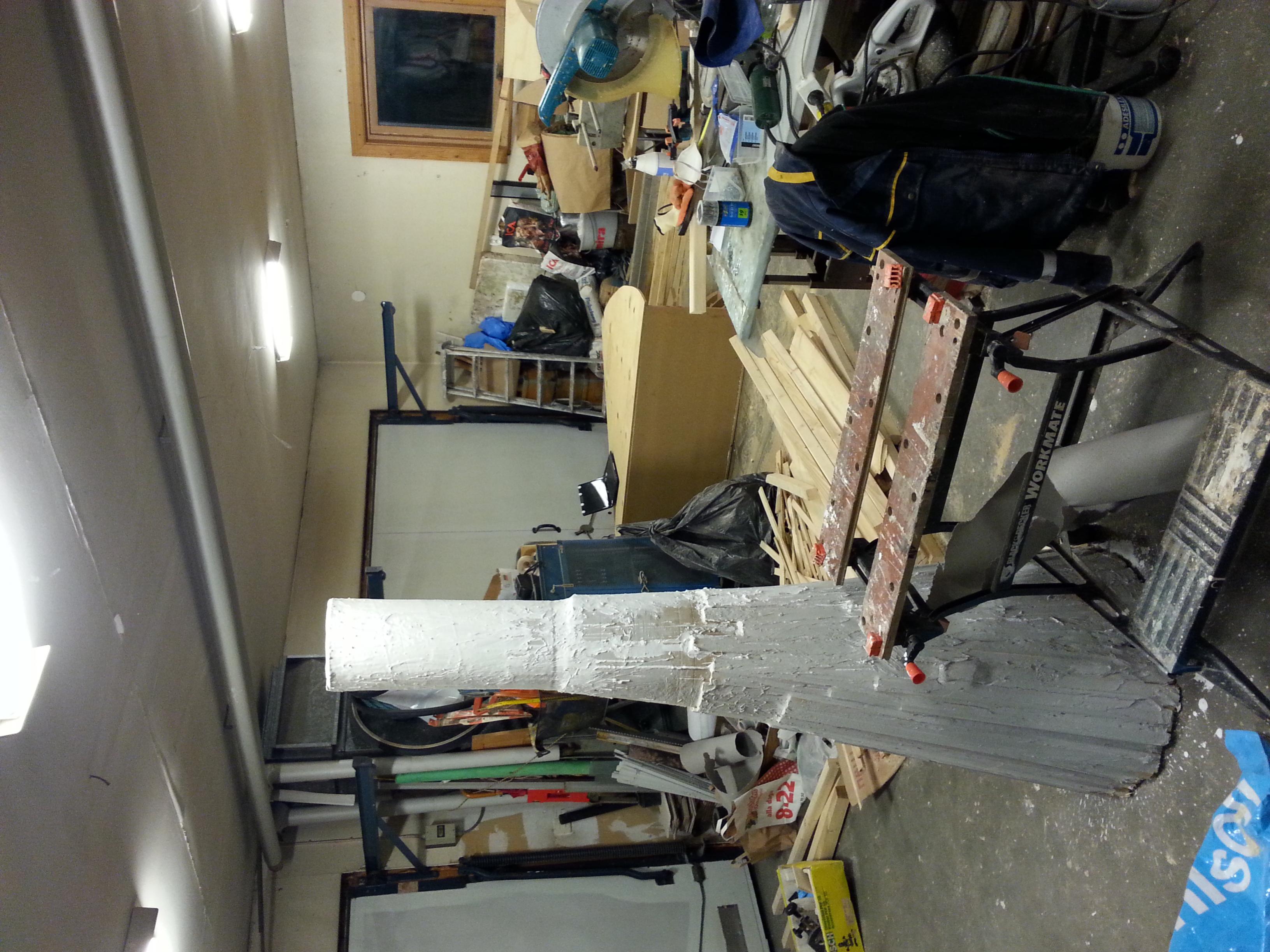

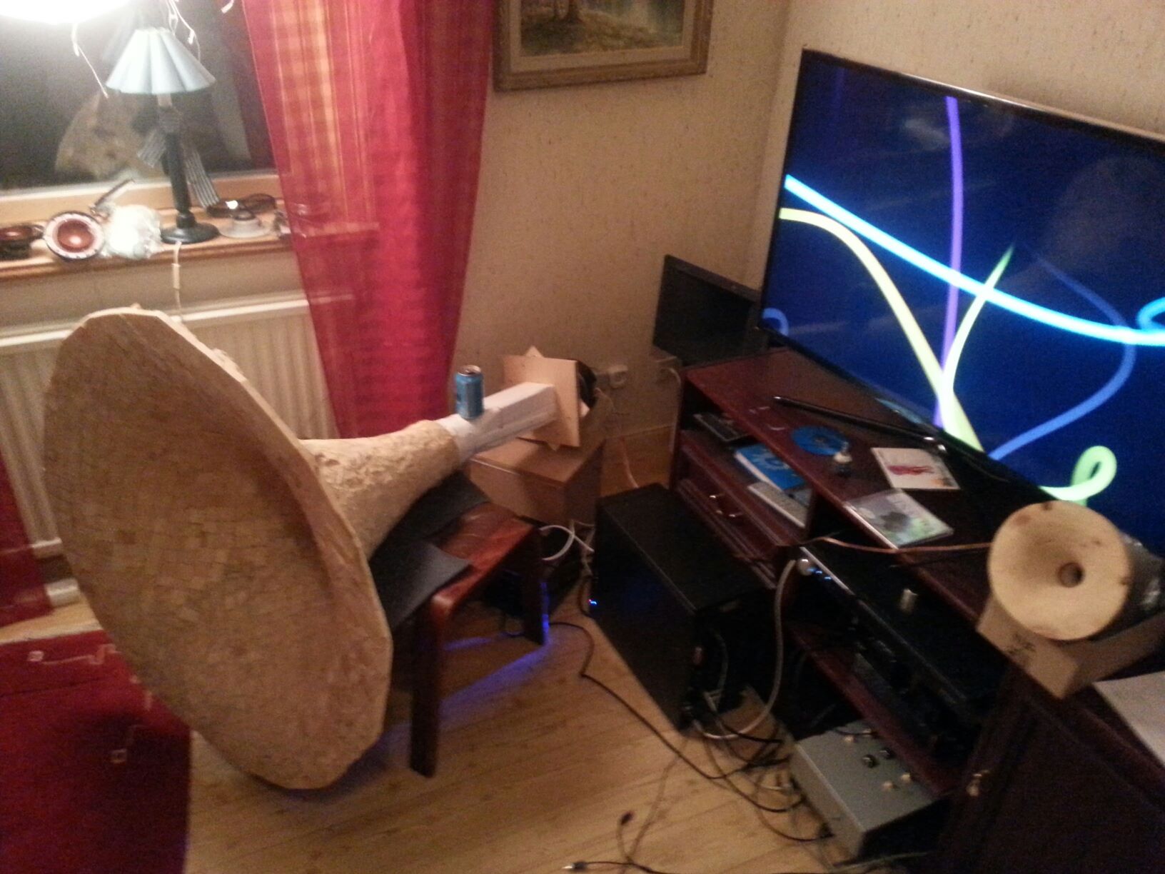

I was also wondering about your midbass horn, since I am in the situation where I don't really know what I want here.
I think this type of horn works best with a larger driver, like an 18" or 15", because for it to work down to 80Hz, the throat need to be so big that it starts to work like a direct radiator. There is no reason to put a direct radiator behind a tiny hole - so lets keep it open!
I have started from another angle - the 8" Fane Studio 8M drivers. I first began with the AG Trio midbass horn - it sounded more like a waveguide than a horn. The next horn I built is in fact the same size as yours, around 80cm in diameter, 1.1m deep, but it has a smaller 4" throat. The signal is hornloaded down to 150 or 200Hz, which is perfect for a 6.5" or 8" driver. The drivers suitable for hornloading in that size usually don't offer much midbass around 80Hz. To get down to 80Hz I needed a driver like the 12" JBL 2202H, but for it to sound good, I would need to open the throat to your size. I will do so, but I will also need a much larger mouth and depth.
Am I all wrong? I really hope so, because I will have trouble fitting the only horn that I think would do the job.
It will probably not be the funny looking biradial midbass horn. 😀 After reading how the edgy looking conical horn sounded compared to the smoothly rounded off midbass horn you have now, I will be very careful of any designs that stray from the idea of smooth round horns.
About placement. I think proper hornloading is more important than perfect on axis listening. Some say it might be even better to place midbass horns closer to each other, probably so that they can pump the same air together.
I base this on someone who had previously been listening to Western Electric 15A horns using WE 555 that reaches 100Hz. When listening to a pair that stood close to each other they apparently sounded much better then the pair that stood far apart on a Hifi convention. He was convinced that this was the reason.
I have heard the same thing about Labhorns, that if you are not planning on building six of them, but just two, then forget about it.
Still, I am just guessing. Despite all my horns, I have not heard hornloading below 110Hz yet.

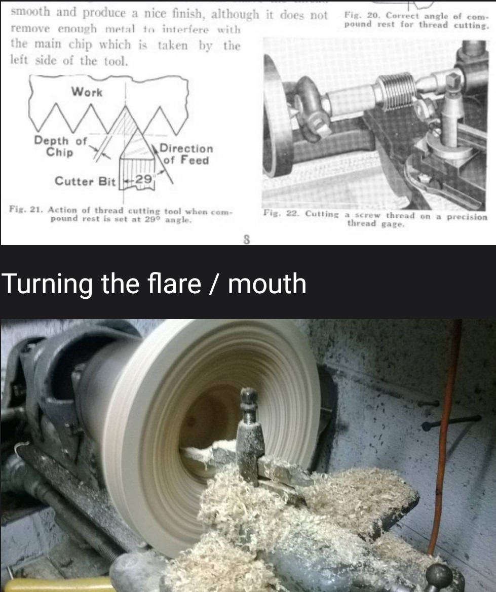

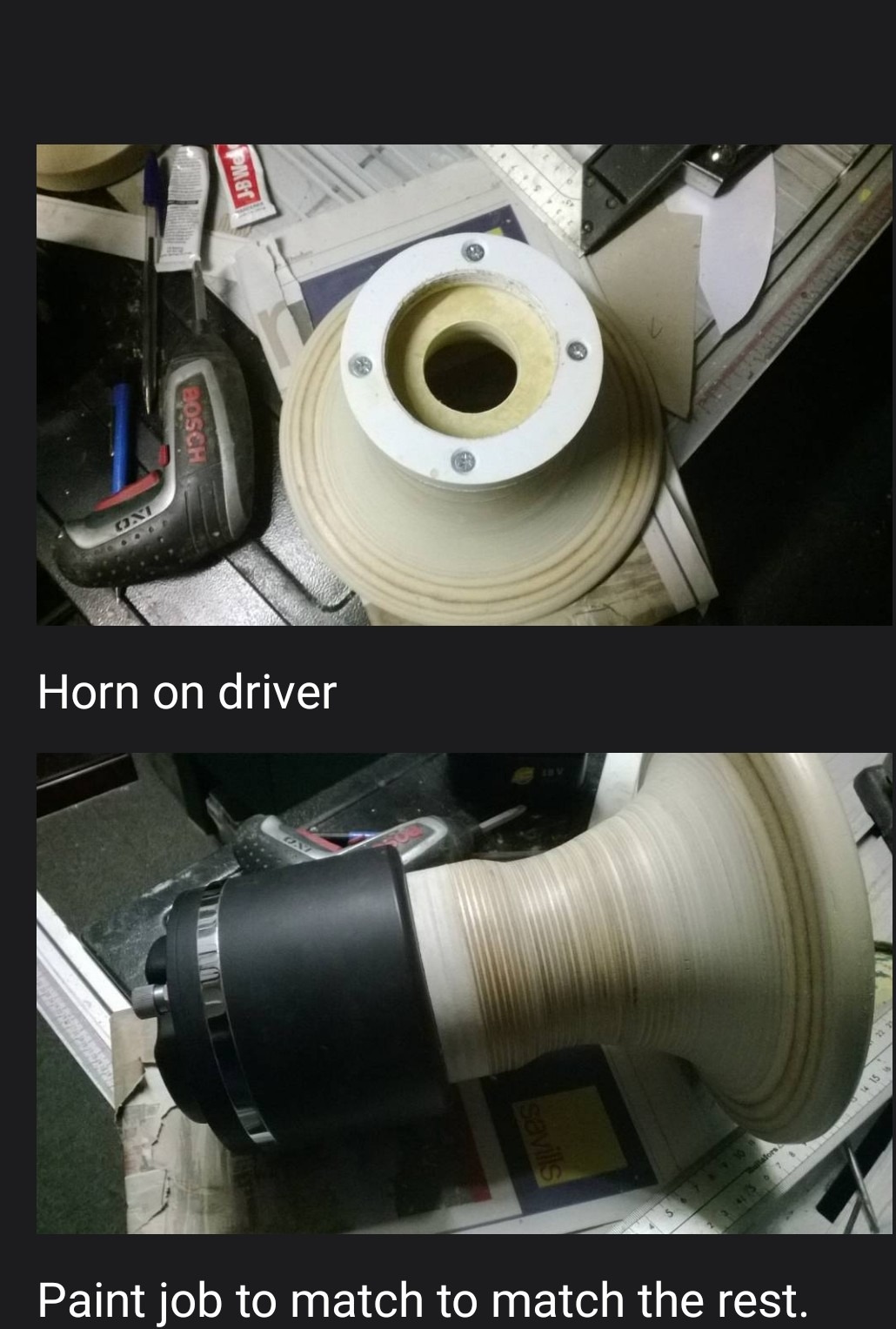

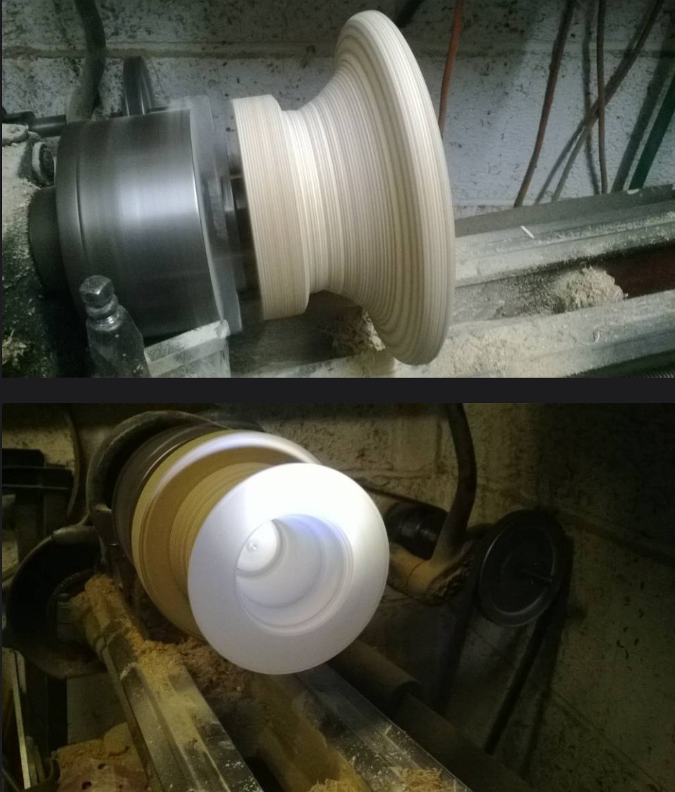

DIY made 550Hz tractrix horns for my Vitavox S2's
The next twist in the tale.
I've set about making a pair of 550 or so Hz tractrix horns for my Vitavox S2's.
A bit of modelling in Hornresp to give the dimensions and also comparing with the ~600Hz Cube Audio GRP ones I currently run.
I've decided to use birch ply as I have lots of it and it's nice to work with.
6 rings of 24mm birch ply will do it.
