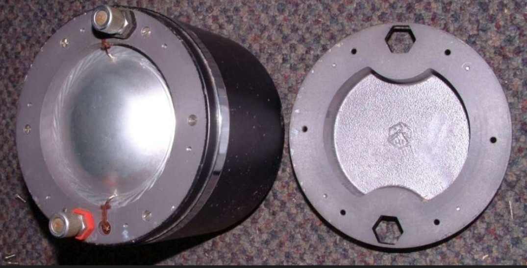

I have a 29lt rear chamber on the bass horn - pretty much the smallest enclosure.
15" driver it seems typically has a volume of ~6lt. I'm a bit unclear is that is just the cone and not the basket = negligible, and the magnet = perhaps a lt?
So I have around 23lt there as is. I loaded in 5 lt, got me to 18lt.
That was close to the right vol for the conicals (17lt). All good.
Current Hornresp calc for the Hyper bass horns is 14lt if I use the design feature.

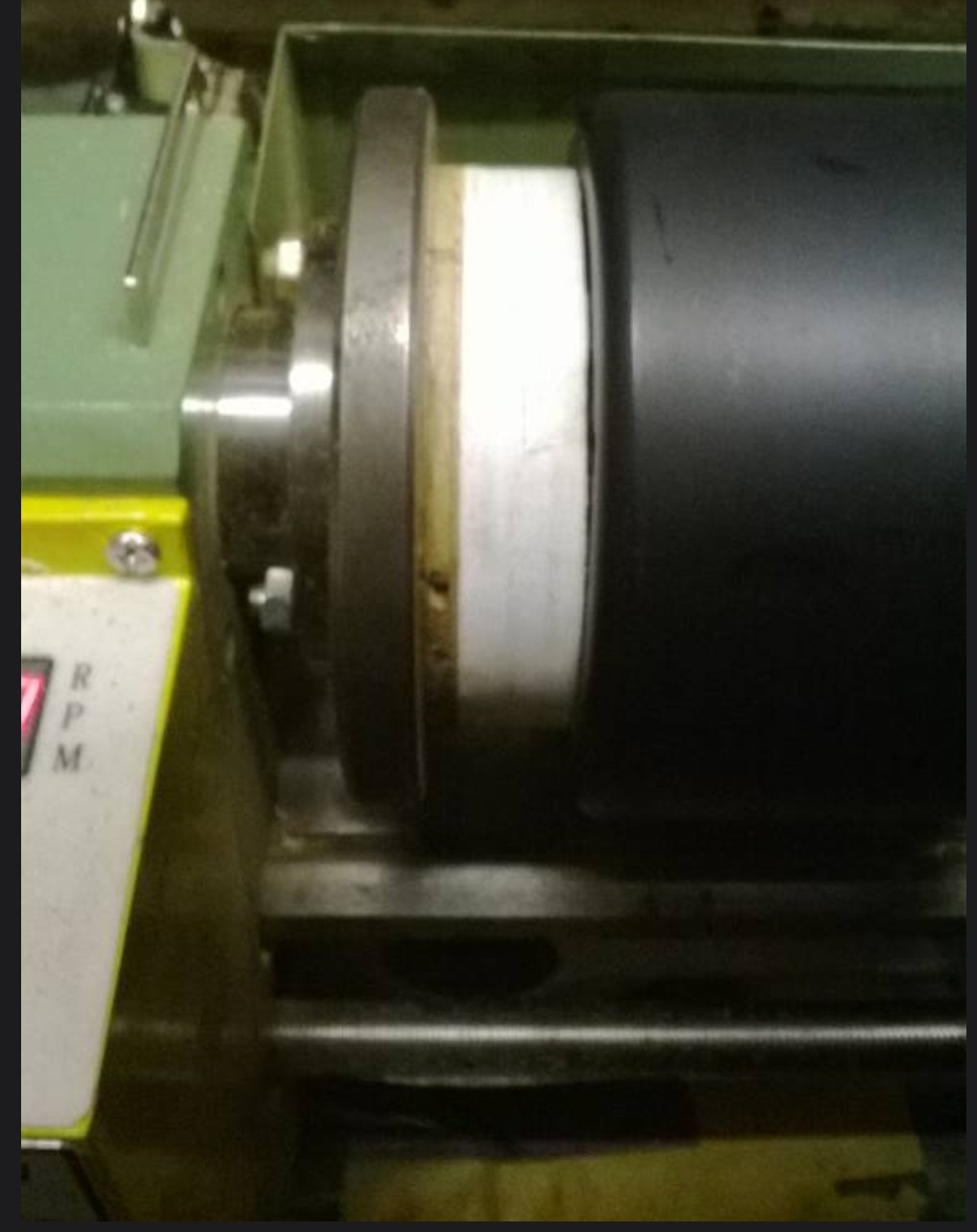

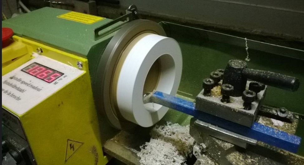

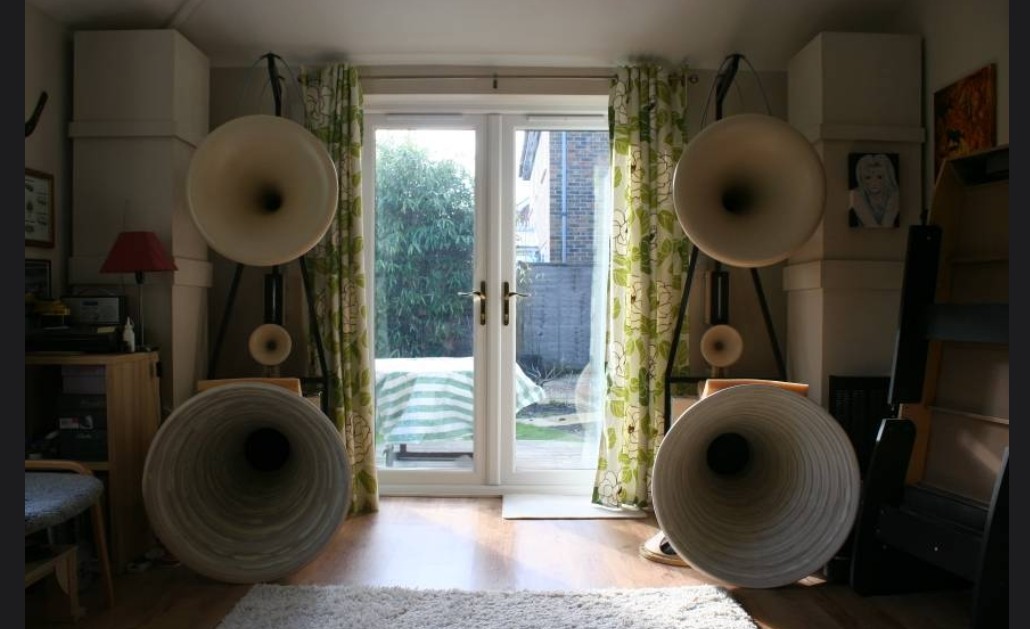

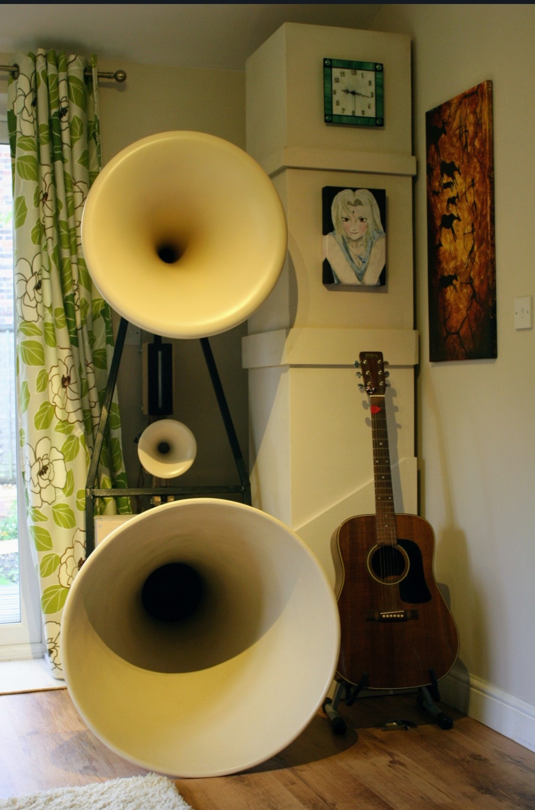

Well, 2nd one knocked up:
Much less edge smoothing needed with the angle cuts.
Not finished fully but quite smooth in there for the 100 - 350Hz waveys.
Quite an effort to get done in a weekend.
Listening now - Drottningholm Baroque ensemble among others. Great church organ use on bass and DEEP bass (Tapped H handles that pf course).
Bass vocals are nice too.

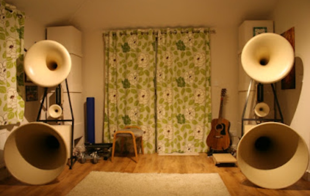

Quite different to the big conicals. More detail is audible. I can turn these up more and get a nice character to tenor and bass vocals.
I'd say they integrate better with the mid horns - others have said the same thing about round Hyper or Exponential profile bass horns. How much diff round vs square actually makes I do not know - prob not much, but I like the round look.
I have back box tuning to do by measuring (more guidance needed by maravedis on that one) - should take care of an evening or two🙂
Then I can drop the other drivers and re-time align and see how that sounds - never ends, just as it should be🙂

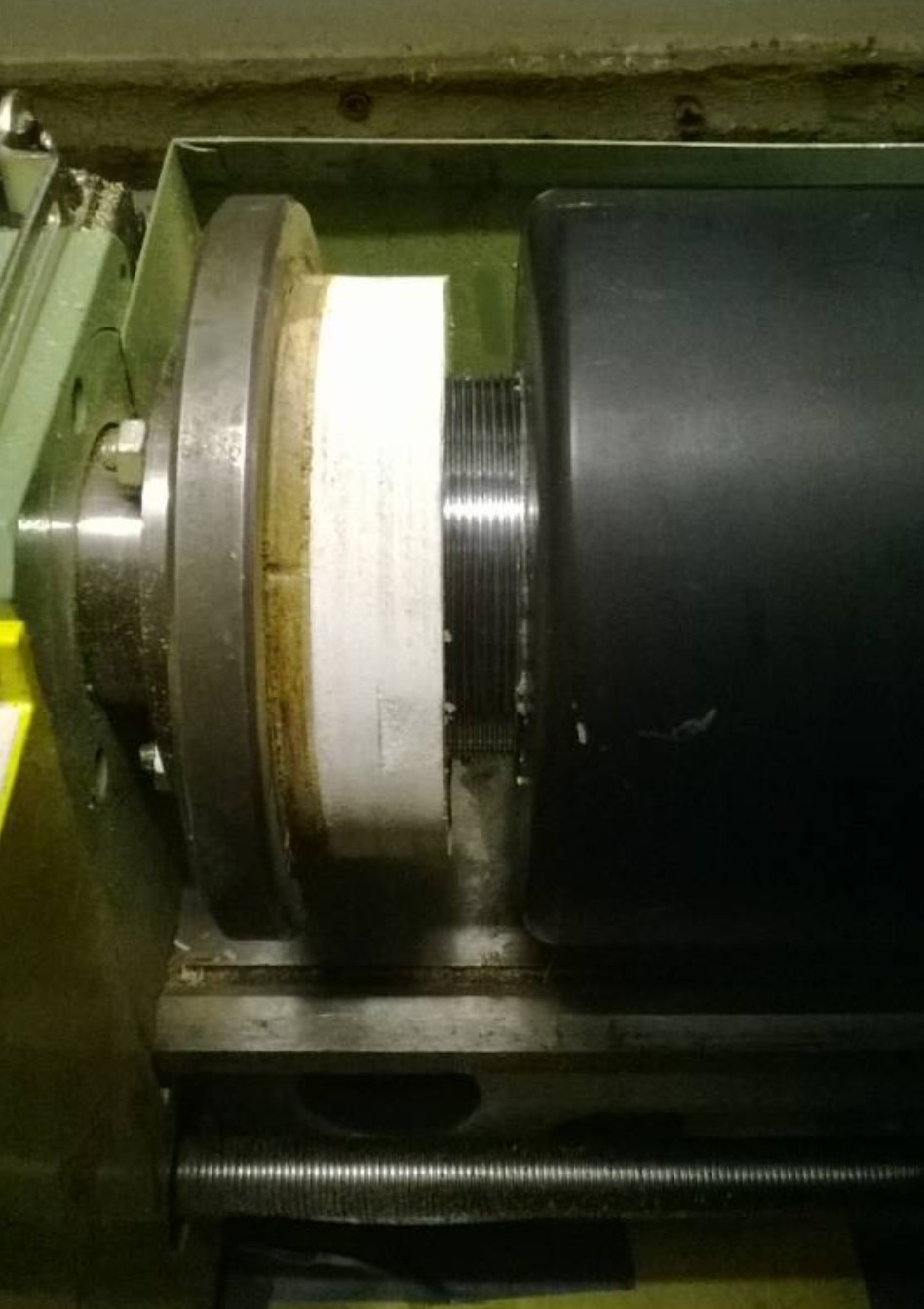

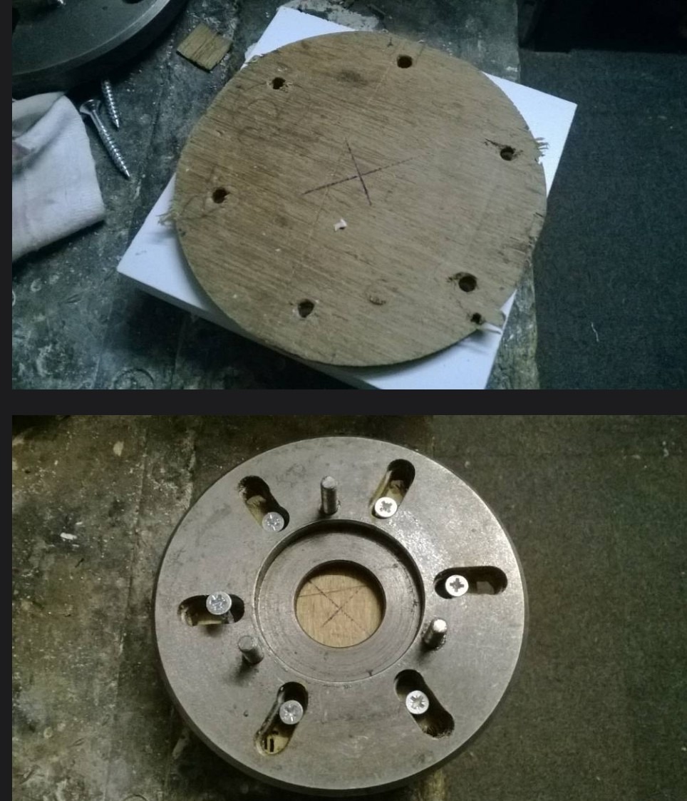

If I am reading you right, you can submerge the bags of material in a pale of water and read the displacement. That will give you the volume of the material.
P.S., are you smoothing those on a lathe of some sort???
I built a rotating platform which helps spin the piece slowly as I use a drum sander to shape and check against profile. That is what worked best for me.

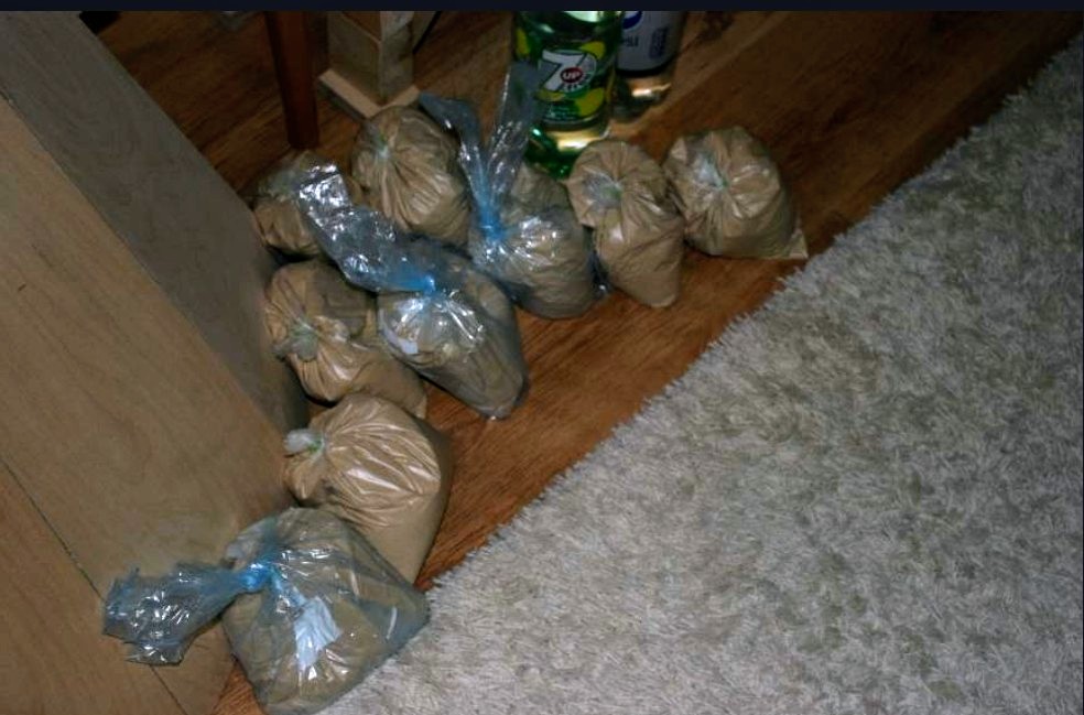

9lt less on rear chamber
Small bags filled with all the kiln dried sand I have (from block paving drive).
Packed around - doesn't leave a lot of space but still some in the corners to go yet.
Measured and sure enough it's brought the lower bass extending down to 90Hz as modelled.
Still got a bit of a hump at about 120Hz in room at listening position.
It's not bad at +/- 5dB across the 90 to 330Hz range between crossovers.
As I ran out of sand for the other side only got 8lts reduction from 2 x 2lt coke bottles full of water and some 1 lt Tetra packs.
I def need foam to get the magic 12lt or more sand and filling the bags only half full to get more compliance for the corners.
Of course it makes the horns a lot heavier to.
So it measures flatter - How does it sound? More deep bass - more like the conicals in that respect but not the boom / colouration I think.
I still have proper tuning to do yet too of course.
So I win back the depth, gain some speed and dynamics, plus can drop the other drivers on the stands. Pretty happy.

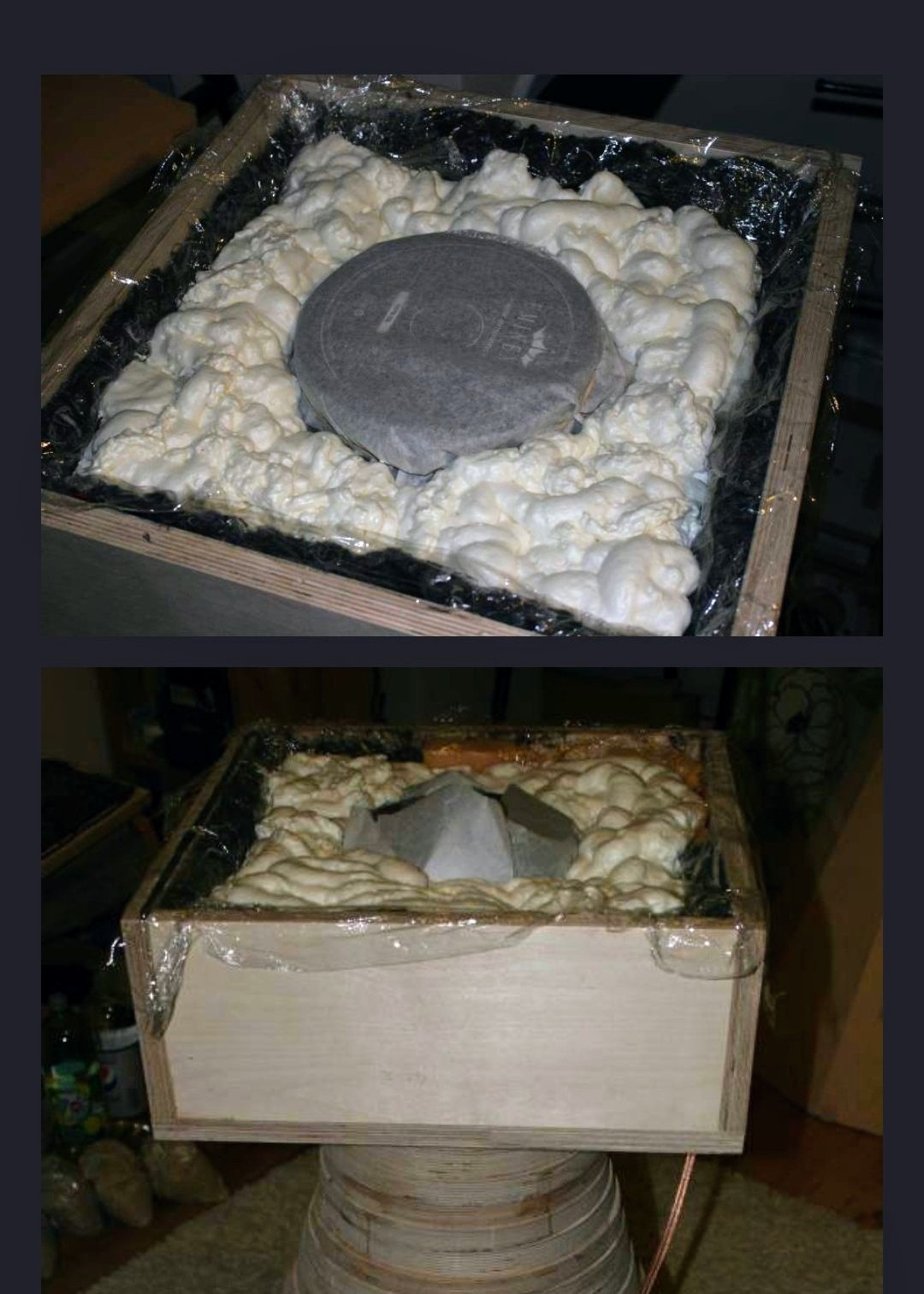

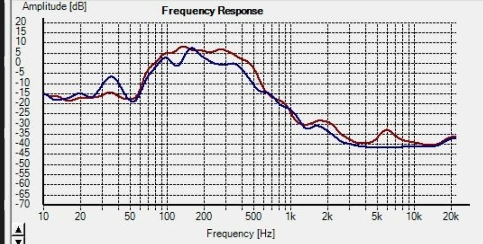

Foam filler: bass horn chamber reduction
I got some fast setting expanding foam. Lined the chamber and driver with cling film and filled her up.
As one side of the foam was sealed it took overnight to set. This morning nice and set.
This evening I trimmed the foam down and cut it into 4 pieces. Putting each piece in a polythene bag and sucking the air out I then placed these in full bucket of water - slightly tilted so the water ran nicely out of the bucket spout into my container. Then I trimmed each piece to be clear of the driver and achieve the desired 3lts of volume. 4 x 3 = 12.
I wrapped each foam piece in tape so that there is no porosity.
I loaded the first 4 into the chamber and had a measure.
The foam is great as it does not add nearly 12kg to the weight of the thing.
The Result :.
In red with the new volume
Pretty flat from 100Hz to 350Hz the crossover points. Slight rises at 140 and 290 but this is in room and from the listening chair ear position! Pretty pleased with that result.
Just got the other side to do now, before I find out how they sound.

That is a huge improvement in sensitivity and smoothness.Pretty flat from 100Hz to 350Hz the crossover points. Slight rises at 140 and 290 but this is in room and from the listening chair ear position! Pretty pleased with that result.
Are you going to try a further reduction in chamber volume?
The poorer measurement was no vol reduction at all. So driver rattling around in 26lts or so. A whole 12 lts between them. 12" lts is a lot.
I have done the other side now and they sound great as a pair.
Quite different to no volume red.
The 2nd one does measure quite as well. Could be room or other. I'll have to swap them round and see whats what.

I dropped the mid / upper and tweeters down by the prescribed amount this evening.
Makes me realise just how high up I had the horns way back with the large upper conical (the one I cut down and used the surplus edge as firewood).
Re-time aligned using Holmimpulse of course.
The tapped horn now tower over the the rest.
Much more integrated look
Moved the stacks Infront of the tapped horns - get more exciting width and instrument placement.
Sound wise - same signature sound of course. Vocals are particularly sweet though. Much listening and little tweaks coming up this weekend. At some point I'll finish and paint the bass horns... Job for spring in the sun that...
Have to lug the massive conicals round to storage too. Not going back, that's for certain.

I have joined the S2 owners club - that is working fully refurbed S2's.
It's taken me a while to track down single matching ones an get refurbed - the waiting list is quite long...
Inside before.
I got home tonight to find the 2nd one back from Mike at Vitavox waiting for me. Mike has worked his magic, demag, check tolerances (all within factory spec), remag, new diaphragm etc.
I first turned some adapter rings cutting threads into compressed poly plastic.
They worked fine on light horns
Then I made some proper ones in aluminium, like the originals.

Here's a pic of the rig taken earlier, with the conical dispatched to storage.
Inside before.
