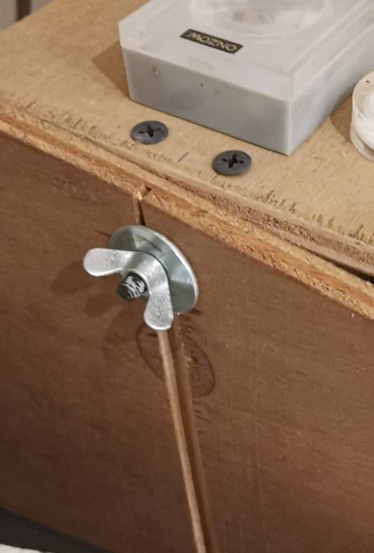

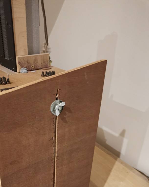

I made some tiny G clamps to hold the optic fibre rod holders in place - in a non invasive way.
The gap they cover is between 8 and 5mm. Kali plus optic fibre array holder thickness is 6mm.
Felt pads to go underside of Kali.
The Optic fibre rod was a cheap plastic type (I knew that when I ordered it), it means is easy to cut and doesn't shatter down its length like glass would if you cut it with sidecutters..
Easy to then smooth with fine bench grinder wheel and then onto 400 / 800 / 1200 / 1500 grit wet and dry.
The latter is quite smooth enough to transmit light well.
In fact even just snipped off transmits pretty well!
3mm stuff is very stiff so I heated it with a paint stripper heat gun until pliant and bent it where I wanted.
Not the prettiest I've ever done but it works fine.
The clamps worked like a dream.
The fibre push fitting into both 3mm holes in Najda and the ebony block I made.
With 3mm diameter fibre it's not that critical where the fibre is over the LEDs. Big enough hit area, so very easy to align the array block and clamp gently.

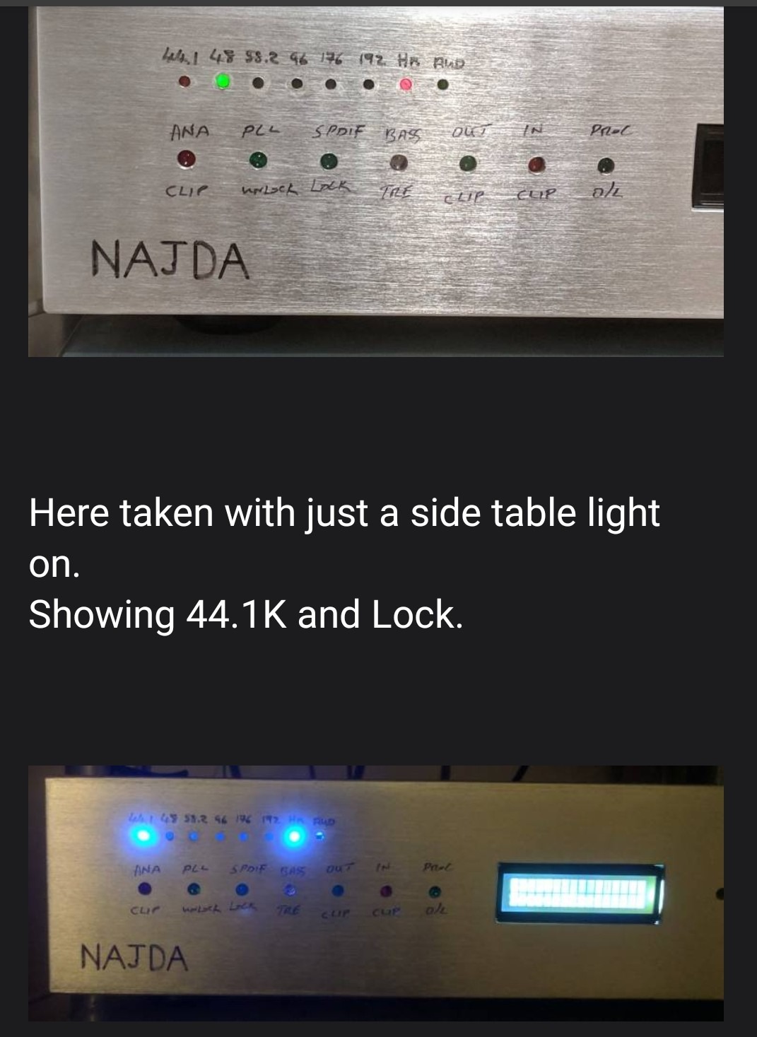

The extra 3mm optic fibre I needed to finish the job came.
I've got the 44.1K slot fed from Kali's 44.1K Family Led.
I also have another one showing Lock (blue) and empty (red) as a combined light slot.
Those two LEDs are so close together on Kali that the 3mm optic fibre covers both! So it works as a dual colour led! Quite a neat feature, if not originally reckoned for.
I made a second small block to hold the two optic fibres for this.
This pic was taken with the main ceiling spot lights on.
Showing standby, a combination of 48K and Empty Leds
At each track change on Spotify it briefly goes to the standby light combo then 44.1K and Lock Leds as the next track is cued up.
I can live with this it's perfect!
Thankfully there is no click, crack or pop between tracks.
Najda does a beautiful job of blocking all that out.

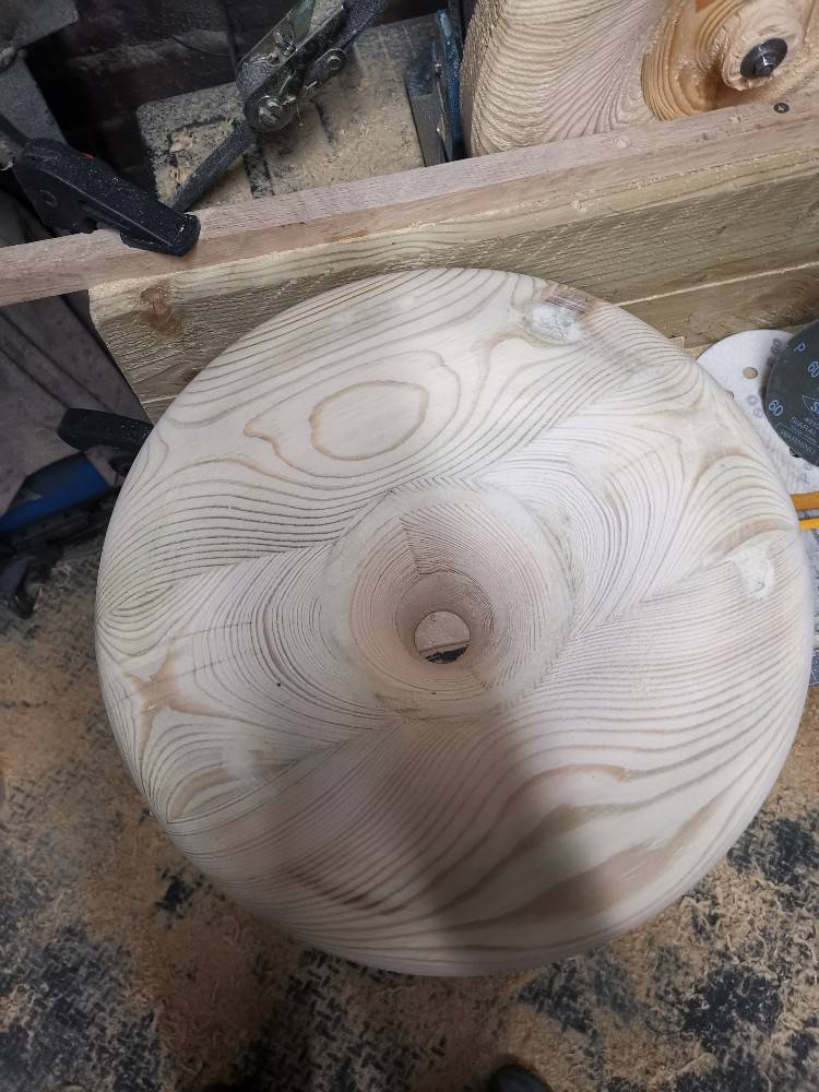

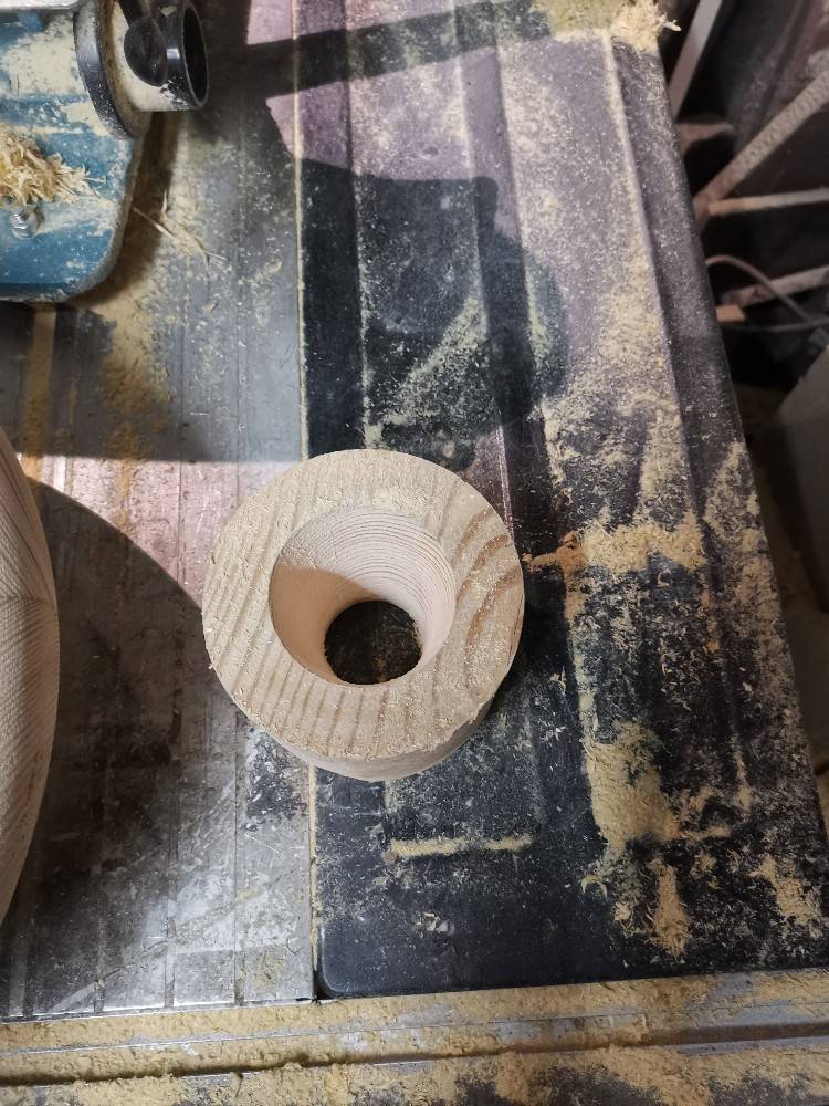

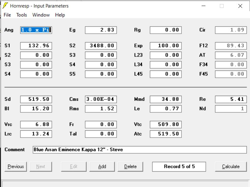

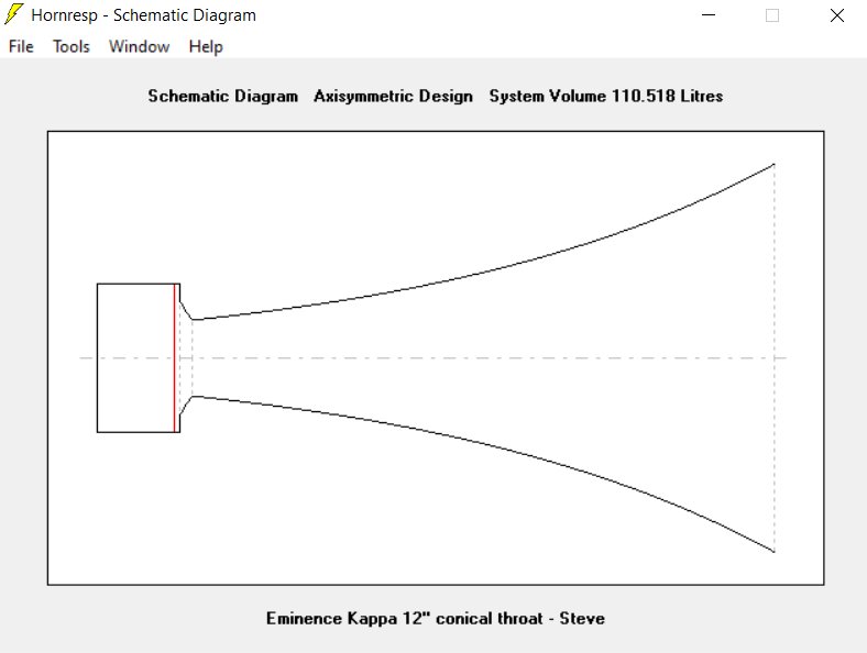

I made the throat adapters to enable the use of Eminence Kappa 12A drivers, in place of the JBL 2220A 15" drivers.
Modelling the throat / new horn that would be, gave;
I made the throat adapters out of 11 rings of 21mm birch plywood, bonded and screwed together.
Fit was very good to the 20cm big throat of the short horn (as was).
Hornresp (thanks David), gave the cutting angles and it all fitted nicely - okay a little two pack filler and sanding needed [emoji846]

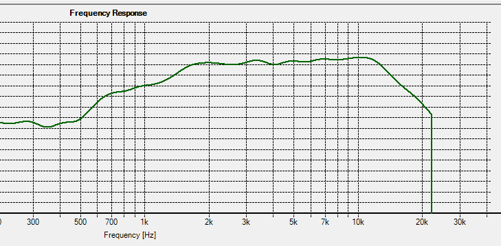

Initial listening was positive. More texture and pressure on some of the upper bass. Lost a bit lower down though!
I dusted off the measuring equipment and saw the problem!
Bass rolling off too soon.
That'll be the volume of the back box then! I was prepared for this.
The total volume of the back box is 31lts.
Driver takes up some.
Hornresp said 14 odd lts for the JBLs.
Only 7 for the Kappa 12As.
I'd made some hard non-porous foam inserts for this you'll recall.
So, I set about adding to them to account for the smaller 12" driver basket and half the volume.
Soon done!
Measurement showed an improvement down to meet the tapped horns nicely.
Listening again it's all there!
The correct compression ratio driver to mouth gives more horniness! It's around 4:1 now.
For some reason the Hornresp prescribed ratio never worked with the JBLs!
There is now a stepped throat of 8" down to the 5" one now of course (21mm long). That actually models better for the 12" drivers than without. It's bevelled in Hornresp.
I've yet to try that mod.

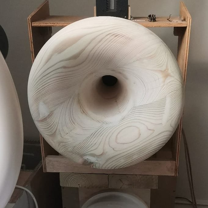

This afternoon's mucking about has been to make stands so the upper mids (Vitavox S2's on 500Hz horns) and the tweeters (Raal Lazy ribbons) could stay in the same place, with lots of air around them, whilst the mid bass horns could be pushed back onto the back wall.
This not only takes care of the mid bass horns not protruding into the room as much - they are quite a bit longer now, but also loads them better.
I re-time aligned the while lot in Najda.
The tapped and mid horns have not moved and were still spot on when checked.
Measuring the frequent Vs amplitude curve, I got a bit better bass extension and a slightly more even curve!
Listening tests revealed better mid bass directivity / stereo imaging.
The latter was a nice unexpected bonus!

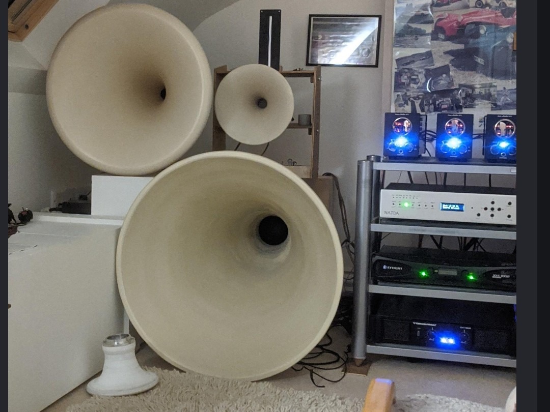

I'm back on the 400Hz upper mid horns (the smallest of the 3 in the shot below).
It's probably a change is as good as a rest type of thing![emoji3]
One of the 550Hz horns can be seen on the floor to the left.
I also been messing about with the X/O between the tapped horn subs and relatively new extended mid bass Kappa 12 horns.
Previous playing around had them at 8th order low pass on the tapped horns and 4th order upper pass on the mid bass.
I changed this to 6th order on the tapped horns.
Still on Linkwitz Riley.
This I guess allows more prominence to the upper range of the tapped horns to be heard a little more, effectively utilising the rear cone movement more as it fills in usual front loaded bass horn hole.
Or perhaps that frequency is a little lower down?
I also loaded Najda in the same but with Bessel.
After listening I could not in general hack the Bessel filter. It's just too much.
Sounds great on some tracks but L-R is just a so much more rounded performer, versatile and 'right' sounding across all music types.
Note also the green light on Najda.
That indicates optical input from the pimped Chromecast Audio.

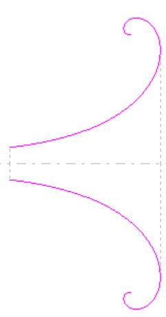

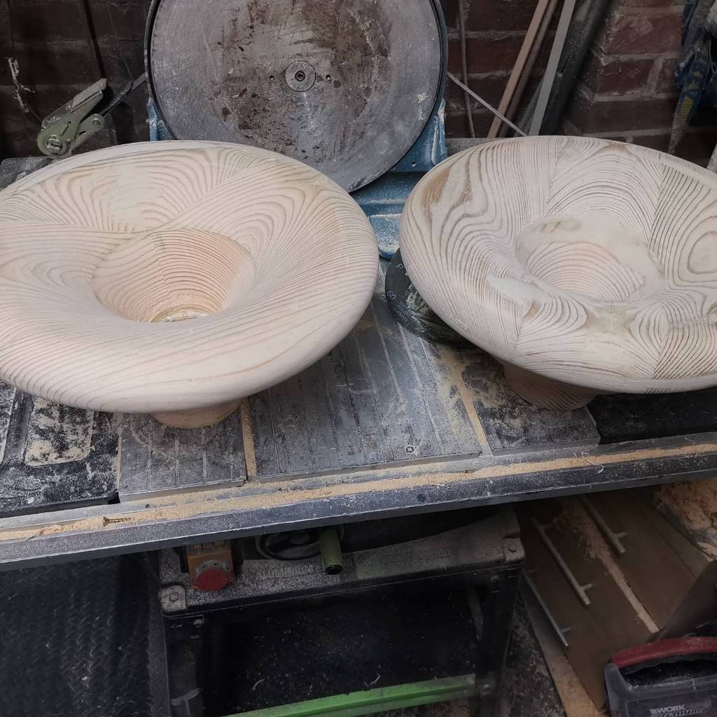

I've been Le Cléac'h horn profile curious for a quite a while.
The only place I could fit them in would be the Upper mid, Vitavox S2 channel.
I decided to make a pair of 550Hz cut off freq could.
Using Hornresp @davidbean
First I chose a T that gave the same throat angle as the driver exhibits.
I made a thin plywood template with feathered edges.

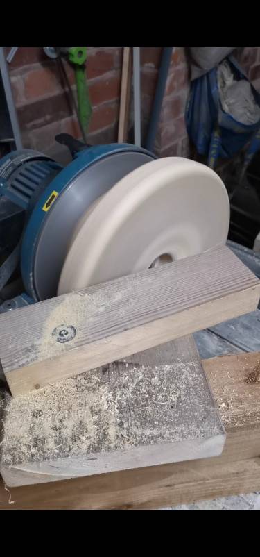

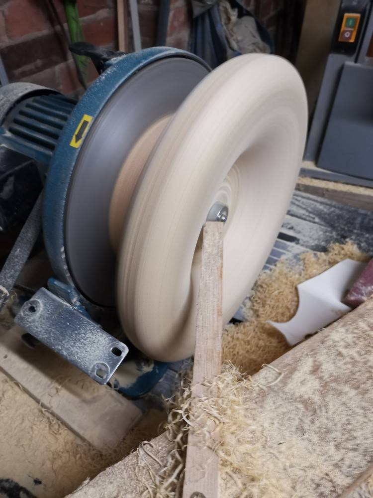

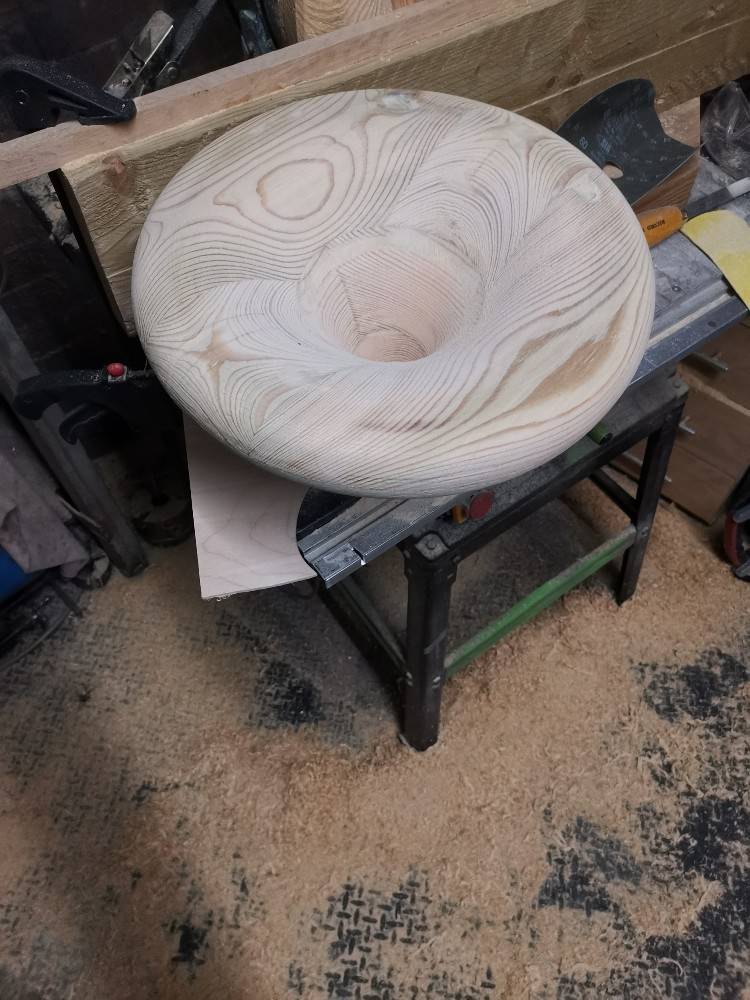

Next the problem of turning something over 12" in diameter.
My lathe is only 9" swing!

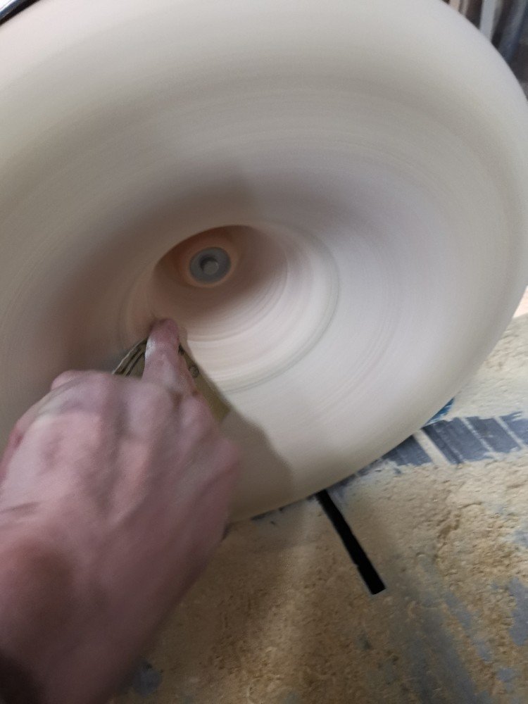

I re-purposed my end sander.
Nice fast rpm, strapped it down.
The centre bolt securing the disc on the sander doubled nicely as a fixing bolt. I made these shorter as material was removed.

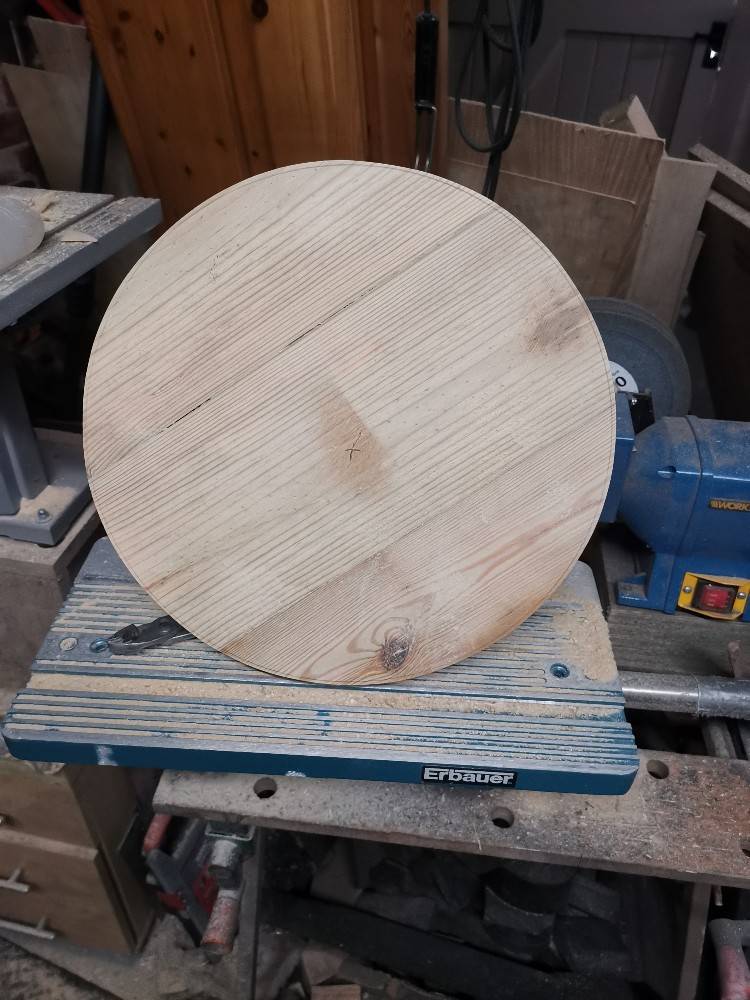

I glued up some Douglas fir softwood and made discs. As true as possible.
Even so I suffered some imbalance due to mismatches in the mass of the different pieces of wood on one of the horns. I balanced these using car wheel balancing weights screwed on the back.
I found quite crude tool rests worked. Fast rpm and the right angle of sharp chisels.
The smaller throats I turned on my lathe.
Laminated together and a bit of smoothing by hand
More to follow

More progress;
Made a pair

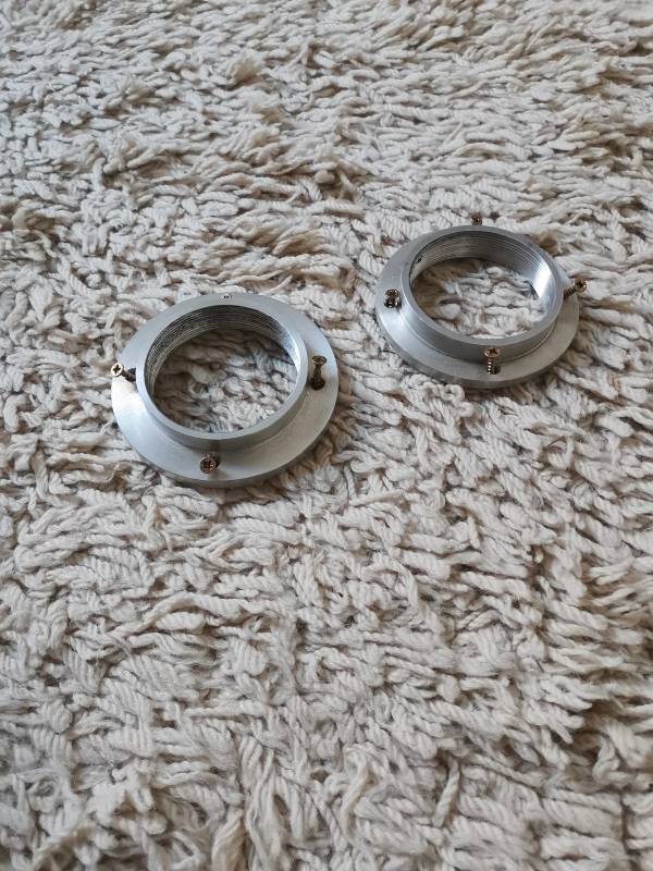

Used adapter rings I'd made up for the 400Hz tractrix horns some 6 odd years ago! Had the feeling I would not be going back to them..
Then installed
I needed to raise the Raal Lazy ribbons a little bit higher. Fortunately I had future proofed my rather rustic tweeter and upper mid horn rack.
Quick twiddle of the wing nuts and slide up.
Look quite cool!

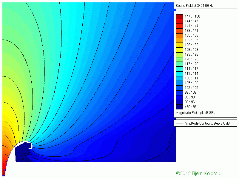

If you go to Bjorn Kolbrek's site - BEM Simulations
and run down the side of the page 'till you get to -
014 AH425 360 deg mouth sound field
you will see the radiation pattern for different frequencies on a 425Hz horn, and you can scale them to suit yours.

Here's a measurement done at the listening position.
As can be seen the S2s are ramping down higher than 1200Hz.
No matter, this sounds better than the 3uF cap by some margin.
