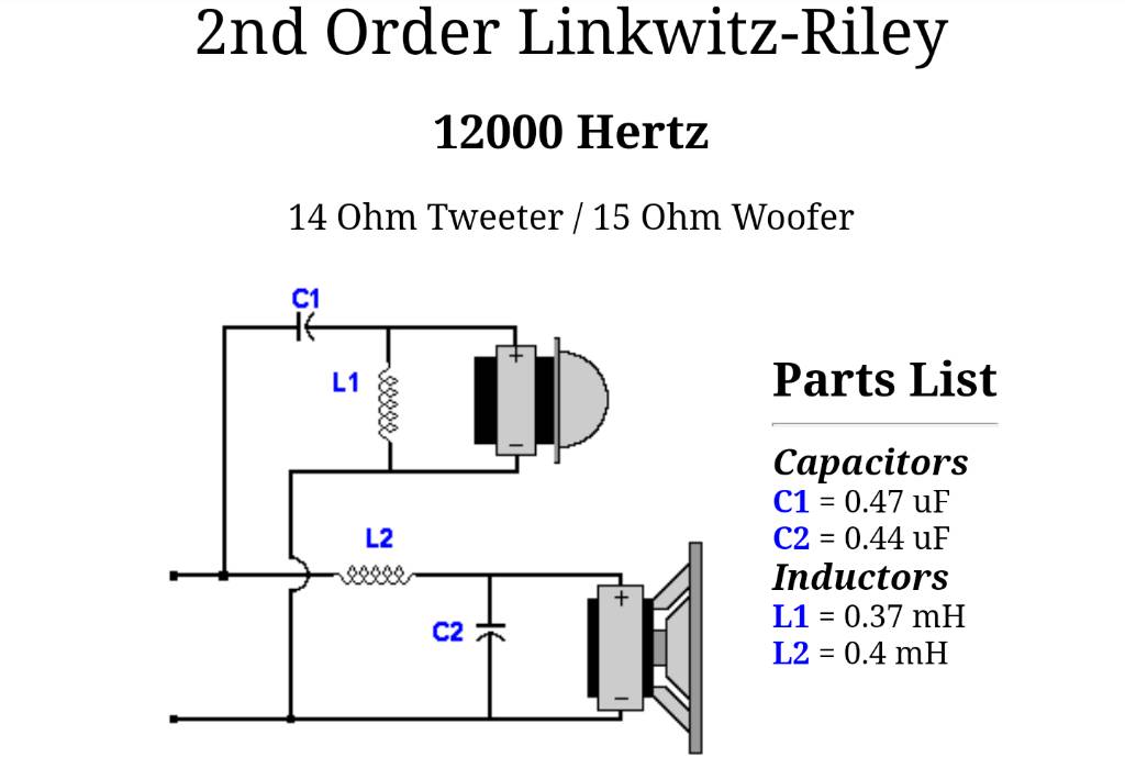

After trying 2nd order L-R crossing in points for the Vitavox S2 upper mid channels, I turned my attention to the X/O of the Raal Lazy Ribbons.
These provide the snow above 11000Hz or so.
I turned my measuring mic on them and wondered what they would sound like coming in with 2nd order L-R instead of 1st order Butterworth?
Let the S2 sound be more dominant or more alone at these heady frequencies, perhaps less smeared?
Measuring showed me that really a 12000Hz 2nd order could do better.
I've lashed up a C1 at 470nF and L1 at 0.37mH XO as below.
Ignore the S2 woofer😂
This measured nicely on its own and together with the S2.
I'm listening now to evaluate.

My previous tweeter X/O experiments peaked my interest..
In need of the 9th and 10th output (Najda expansion board that I never got to acquire), I wanted to quickly test many different X/O points and slopes on the Raal Lazy Ribbon tweeters.
I have a spare Nadja setup.
I took the paired output from the amp that drives the upper mid channels and fed it to the analogue input of the 2nd Nadja.
Then using just 1 pair of outputs from the 2nd Najda fed the tweeter amp.
Great result, no discernable loss of quality, volume was the same with the 2nd Najda on 0dB and I could mess about to be hearts content listening to 2nd / 3rd / 4th order high pass X/Os played from the 2nd Najda.
I settled on 12KHz, 3rd order.
This is both higher and steeper than I originally used and thought was fine for years[emoji849][emoji23]
I subsequently made up a pair inductors to sit and the caps necessary to do this in passives.
These worked very nicely and the 2nd Najda can go back into mothballs.
Stopping the Raals playing 1st order low has really cleaned up the upper mid sound. The S2s are not muddied by the Raals playing down over them I guess.

I've found the Raals are very flexible to cross in to taste high up.
I've gone back to 1st order on the Raal Lazy's, 11.5K. I missed the extra bite and get up and go of them playing down a bit together with the S2, in the end.
Funny game this and long term listening is the true decider.

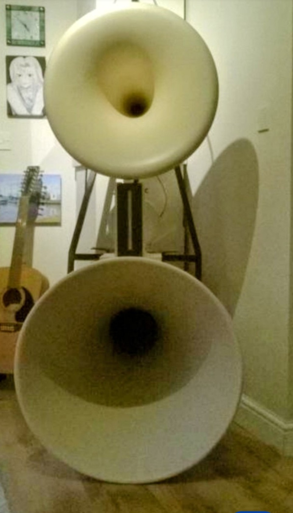

I have Le Clèac'h 550Hz horns now before that I was using either 550Hz or 400Hz tractrix.
Both had their merits.
The Le Clèac'h is smoother / more natural but vivid too. Neat trick!
I just stuck a 1.1 or 1.2uf cap on the Lazy's. Can't remember which.
They give a measurement like a 1st order or so..
When I tried 2nd / 3rd order caps & inductors, the slopes were steeper.

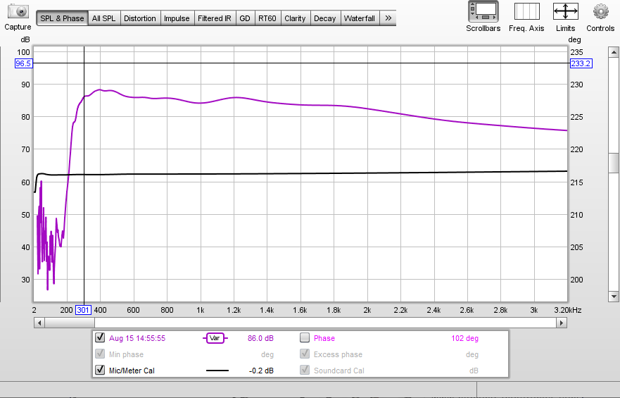

Here is a REW measurement I did on the JMLC-Iwata 220 with Umik-1. I am pretty satisfied with that!
Apparently the Iwata-300, the little brother to this one, also goes down very low, but is less good for midrange and treble. Well, I knew that, so I am using a smaller horn for everything above 2500Hz now, but soon I will use another set of compression drivers in a Iwata 1400. Maybe I should go round horn, but I just love the shape of these.
