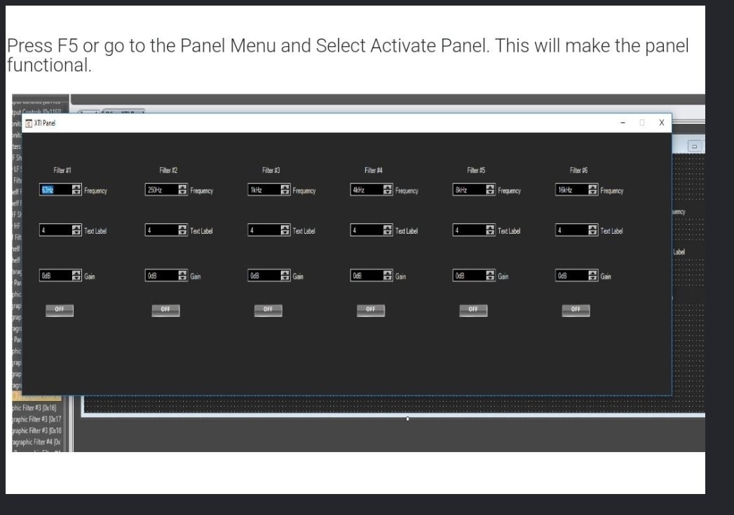

For the Tapped horn subs the
Crown XTI series could be candidates.
Plenty of PEQ possible.
I only cut at 29Hz and a little at 55Hz = room modes.
Damping factor > 500 @ 20 - 400Hz ✔️
And all the XO slopes, 1st to 4th order available.
If the Cerwin Vega ever gives up an XTI could the next.

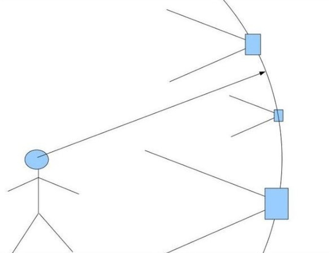

Thought I'd try to physically time align the upper channels and see where the drivers / horns end up.
Tweeters to upper mids are already physically time-aligned.
Set all the time delays to 0, ignoring the position of mid bass to tapped horn, I could not physically move the mid horn far enough back or conversely the mid bass horn near enough to align
Some 40cm out!
The diaphragm of the mid horn would end up way behind that of the mid bass horn .
Checked everything several times.
Even wondered if the Crown amp with some DSP in it (not in use) was delaying things..?
Tried a simple big topping class D instead.
Nope. Same.
Any ideas?
I moved the mid / upper mid + tweeters quite a long way back and then time aligned in Najda as usual.
With those horns farther away it's a more polite sound.

I suspect there is possibly a few effects at play here influencing the "polite" sound as you describe it.
Firstly, the phase delay caused by IIR filters creates a "high frequency first" bias, where the first part of the impulse response is predominantly high frequency energy, followed by mid, followed by low etc (I believe you already know this).
I recently tried messing around with very small delay changes on the HF of a synergy horn I have been designing, and found that differences as small as a third of a millisecond for a 1khz XO can (subjectively speaking) create a much more relaxed sound that I can listen to for far greater periods of time it's possible this setup simply has a "better" time alignment than before (I don't know the accuracy available for your DSP).
Secondly (and forgive me if I've missed something, I have followed this thread for some years now but have not read through it in a while), assuming you have not accounted for the inverse square law by simply placing the higher frequency elements further back you will lower the spl from each band at the listening position, biasing the low frequency bands which in my experience can also create a "polite" or warm sound to things.
Thirdly, by placing the HF sources further back you will increase the diffuse sound relative to the direct sound due to the side walls being "sprayed" a little sooner. This may appear to have the effect of taking the edge off of transients and thus introduce a "polite" sound.

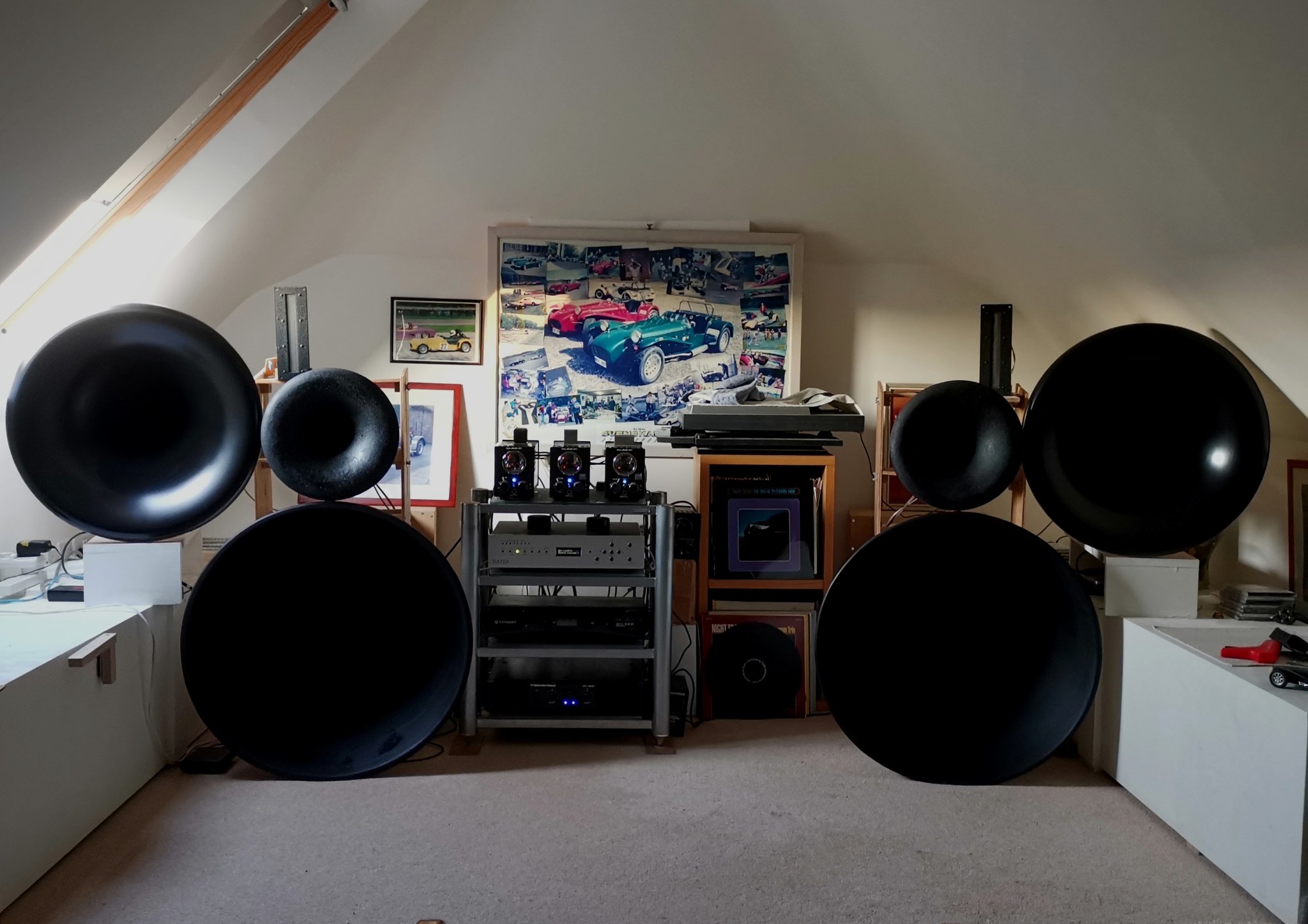

I remember physically time aligning the 4 channels (not including Tapped horns, when I had the 4 drivers all in a vertical stack.
Back then I had the classic convex shape with the mid bass at the bottom and the mids at the top nearer, then the upper mids and tweeters.
Can't get anywhere near that at the moment.
Perhaps the mids being so high were further away from me when sitting down (measuring mic), than I thought?
I only have PEQ filters on the tapped horns.
Have 3rd order on the high pass of the mid bass, 2nd order on the low pass.
The mids are 2nd order bandpass.
The upper and tweeters on 1st order high pass only.
Before, (12 years ago), when physically time aligning all were 2nd order passives..
I always measure 1st peak positive in Holmimpulse.
All help and insights much appreciated.

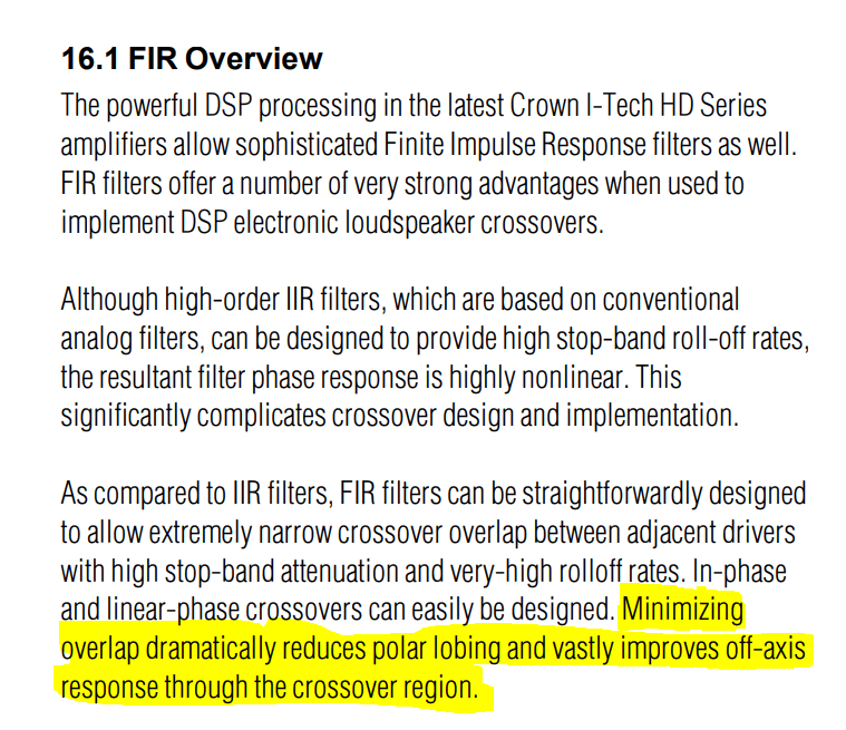

Crown I-Tech HD's have the most FIR capability I've seen in a beefy amp.Anyone know if there are beefy amps with DSP logic that might have FIR filters instead of IIR / PEQ?
Many taps at low frequencies I understand and demands huge processing power = cost.
Although I haven't canvassed the market lately, mainly because I don't think it makes sense to bundle a great deal of FIR capability in a prosound amp, given the typical inability of prosound to tolerate FIR delay.
Since you have such a high count multi-way system, I strongly believe you are one of the best candidates to take advantage of FIR xovers.
Here's a snip from a Crown I-Tech manual...https://www.crownaudio.com/en/site_elements/i-tech-4x3500hd-manual-english
Not only that for helping out a single xover region.
But also helps In a high-count multi-way, because how on earth can you keep low order xovers from spilling into sections past the two primary sections used with the xover?
In my experiences with 4, 5, and now 6-way builds, steep complementary linear phase xovers simply work.
And are much much easier to implement than any order IIR xovers. Ridiculously easier...(if the FIR delay is no problem.)
Cheapest, and perhaps best way to start experimenting, is to simply make lin phase xovers with rePhase, and put them into JRiver.
And also add min-phase EQs into the same rePhase xover files, for driver corrections.

The Crown manual I linked gives examples, showing how the width the lobing range shrinks down to a narrow sharp dip with steep filters.Any lobing remains completely at and around the crossover frequency, so this is an ambiguously misleading statement.
The narrow sharp dip occurs with either low order or high order xovers, so it's all gain/no lose with high order (other than delay)
The only thing misleading about their example imo, is that they use a full polarity reversal for the example
Otherwise, it's pretty much simple fact steep xovers narrow the frequency range of lobing...

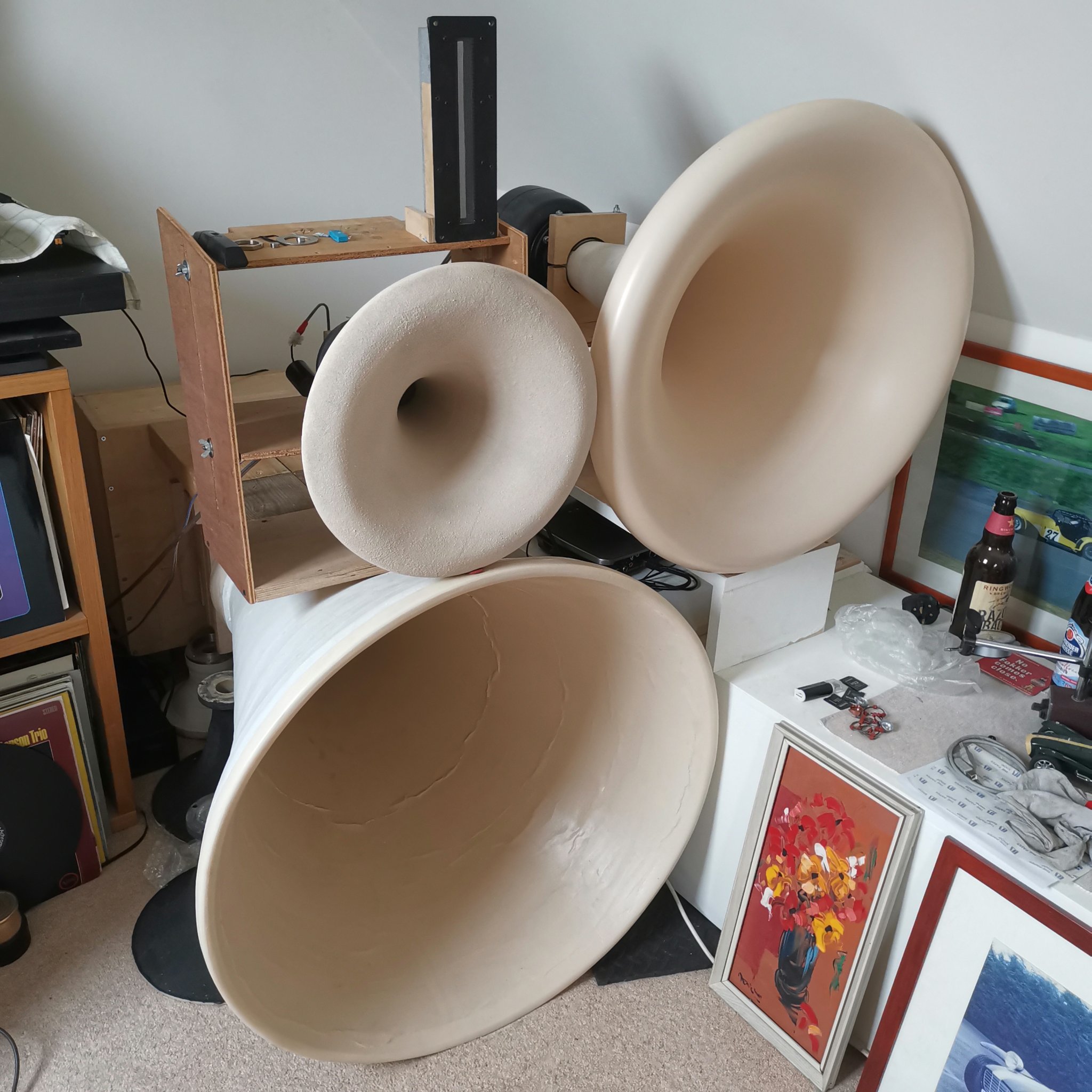

I've moved the mid / Upper mid / tweeter drivers to where they sound best time aligned - took a while with iterations.
Then listened with it all time aligned.
Then removed all alignment and switched between the two setups in Najda.
I've done this before years ago.
I'd forgotten the profound effect of totally aligned vs not!
On simpler music it's almost fine un-aligned.
Complex stuff mostly sounds a bit boxed in and disorganised.
Instrument placement is odd. Mid bass has less punch / tone. Vocals are positioned differently and almost of different character on some tracks.
It's like un-aligned, the mixing / master production was not done quite right 🙂 Not that of course, but it's the effect.
Time-alignment is definitely necessary 👍

Then I leaned from @hornydude about time aligning the mouths relative to horn length Inc driver distance to diaphragms.
This was a revelation.
Much preferable to usual alignment diaphragm to ear method.
Then learning about the interaction and interference of room and horns relative to one another.
This spurred me to physically align all the mouths.
Basically as they would be mounted in a speaker front panel.
This meant bringing the mids, upper mids and tweeters nearer to listening spot by 40-50cm or more.
A bit of carpentry required for the supports.
The tapped horn subs and mid bass horns stay where they are..
I then retimed the drivers as usual.
A lot more delay required on the drivers I'd moved nearer of course.
I then applied the horn length algorithm (have created a spreadsheet so it's quick to get the new delay sample values for Najda), so the sound leaves the mouths at the same time.
This last critical step is the difference from my previous trials with physically aligned mouths, some 8 or 9 years ago!
I can now flick between usual alignment and the new way, but this time with nearer field mids/upper mids and tweeters.
Initial listening
- usual time alignment, help get me out of here and back to the old way.
Sounds harsh and hard.
- new horn length mouth exit alignment. Hmm that just sounds right, so uninterrupted and distortion free.
Lots of evaluation required, but marrying these two ideologies (aligned nearer field upper frequencies / horn length exit delay alignment) seems to bring both of their benefits!
The sofa being far away is great for bass punch, bringing the drivers right to the front of the mid bass horns essentially brings them near(er) field again.
Also interesting moving around the room - there are little or no variations in sound?! It's very uniform.

Hi LewinskiH01,
Yes I have two tapped horns.
The mid bass horns (seen as the largest round Exponentials in the pic), are on 2nd order L-R X/Os.
Cross at 100Hz and 300Hz.
The mouths are 12cm diameter.
Horn length just over 1m. Mouth is 66cm diameter.
F12 in Hornresp is 89.43.
Don't require any EQ.
These horns were originally shorter with a 15" driver in.
Something I tried - wanted a bit more compact vs the original huge 12 sided conical horns I had in the beginning.
I made a 20cm throat adapter to extend and get the same lower frequency from the 12" as the 15" drivers.
The longer horn also gave more punch and better higher frequency tone.

Finally got around to changing the colour🙂
"Any colour you want, as long as it's black"
It's like looking into the abyss, esp the mid bass horns.
