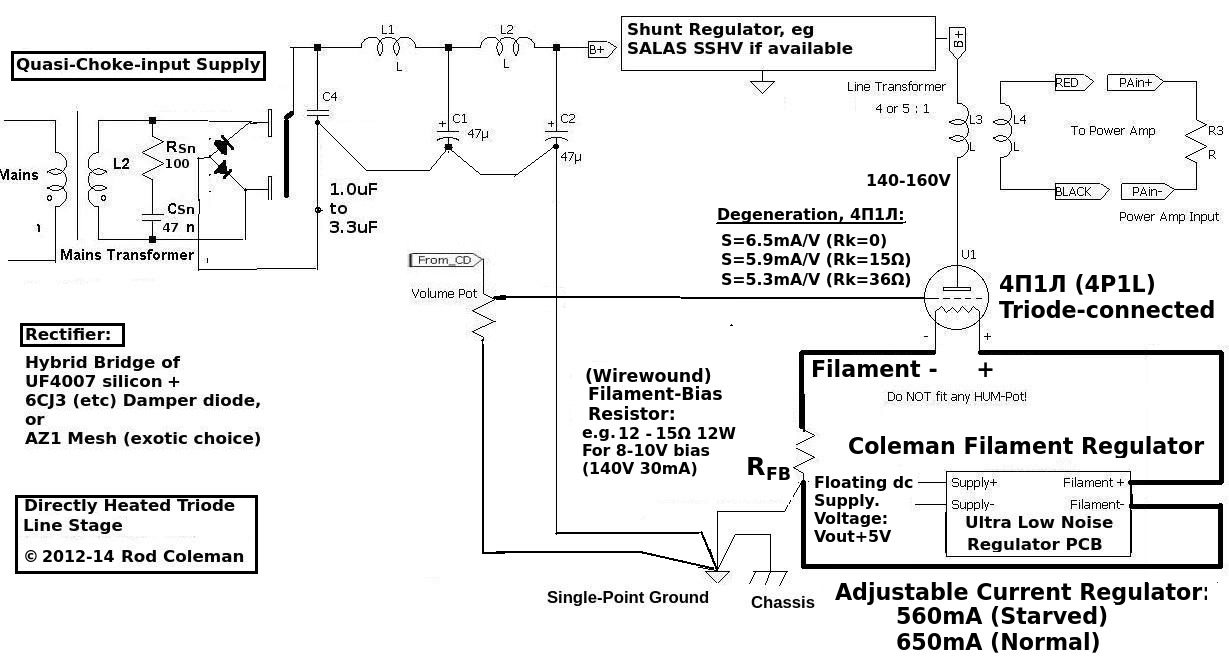

For reference, I have attached a serving-suggestion for the 4P1L in filament-bias, transformer output version.
You can see the degeneration effect of the bias resistor: about 10%, if you choose 15Ω - for a typical bias of 8-9V or so.
4P1L is an excellent choice for experimenting with filament bias. It looks a bit wasteful of power, at first glance - but to get the same level of performance, you would need a separate transformer, rectifier, caps and a very low-noise regulator to generate a fixed-bias supply of equal quality to this circuit. The 3-terminal regulators would be fairly disastrous for this function, too!

Thanks Rod. That circuit is almost exactly what I use, including the power supply. I use the transformer in 1:1 because this input stage is actually in my integrated 2-stage PSE 4P1L amp.
