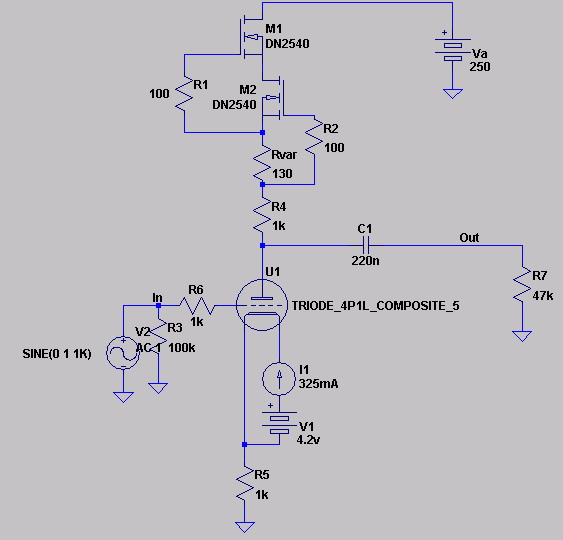

Try to draw the schematic in LTSpice.
Hi Ale...
I'm trying to draw your schematic for the 4P1L in LTSpice.
Doing the hard way, but learned a lot.
I'm really far now so I just have one show stopper...
Your current source limiter , think it's a gpoly is my show stopper.
I got this error G§I1 - missing note(s).
My Netlist is

I'm a little lost. Can you point in the right direction :)
/Thanks Michael.
Hi Michael,
That is a very old diagram. You ought to run the 4P1L with paralleled filaments and starved at 550mA instead of 650mA to reduce microphonic noise. Also helps to keep the filament resistor value low to provide the negative bias.
I'm not around my workshop so can't access the spice files. You can check on my blog where you will find the Siberian preamp diagrams. If you are planning to load it with a CCS or gyrator you better run it at 20mA. That is where 4P1L performs at its best.
Ale
Michael,
Please beware of the reduction in S (gm, mA/V) of the 4P1L, if you use 1K cathode resistor, with no bypass cap. This will reduce the gain to a low value.
You can bypass the cathode resistor (this sounds bad, if electrolytic capacitor is used), or you can use Filament Bias, like Ale does.
