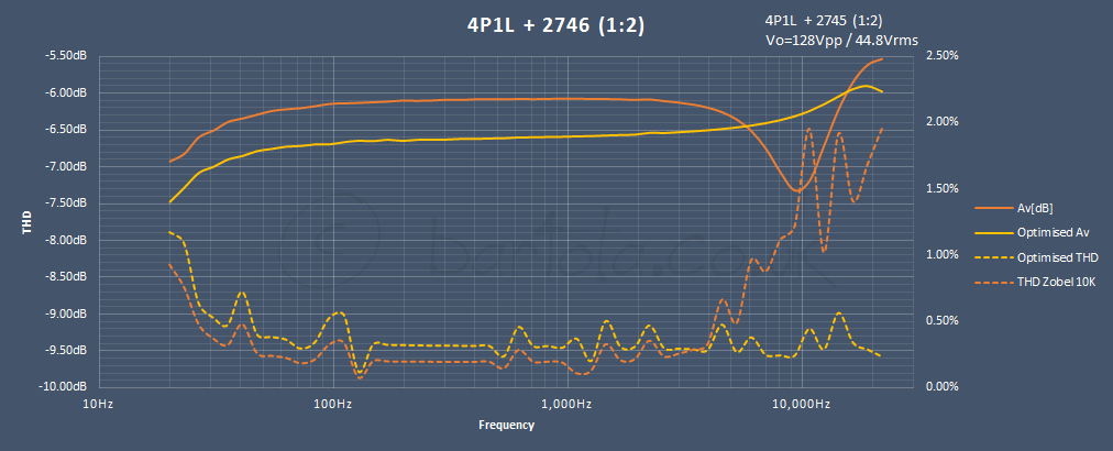

I know, but couldn't help myself and went and run the tests:
All test details here: 4P1L – LL2746 driver test | Bartola Valves
Not bad at all, but not as good as other drivers like triode-strapped pentodes. However, this is a DHT in filament bias so I'd be tempted to use it as I love the sound of them. I will have to do final build and let my ears to judge it!

You can try I Ale but that Lundahl doesn't look good as other models. I cannot see an advantage in comparison to a 6H30 with 1:1 interstage. Your Zout is also 4x higher...so no chance to get even near the onset of grid current. Maybe you will not need 200 V p-p.
I would have done it differently as don't like Zobel networks at the driver stage. In a low signal area is a different story. An alternative to the NC20 could be the Sowter 9525 which is ideal for source impedances between 1K and 3K. You get minimum 75KHz bandwidth. It has 50H for 50 mA primary DC and I guess it could be specified for 20-25 mA for even higher inductance.

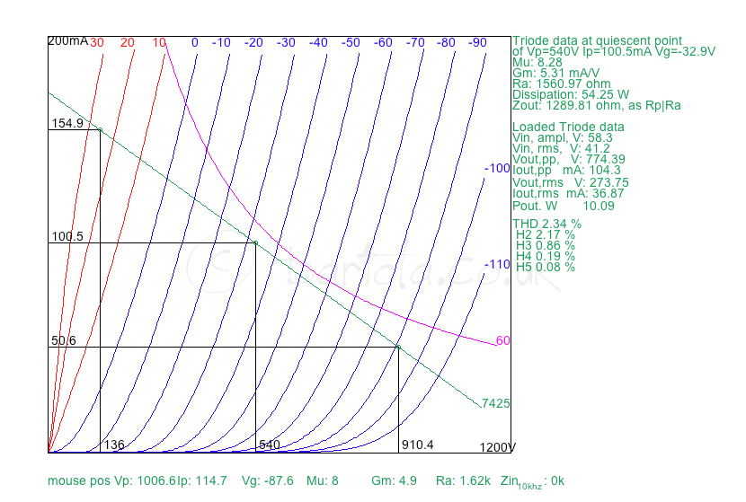

Yes - of course my system is happy with around 5 watts output. But I can add more 4P1L - next amp will have 3 in parallel to continue the experiment. Bear in mind I came from a 3-stage amp with 300b outputs and I prefer 2 stages of 4P1L. I'm quite happy with the extra supply needs of filament bias - it's easy to implement and also sounds better than all the fixed bias experiments I tried. No doubt I could have continued to optimise fixed bias, but since I already have a solution with no coupling caps, no cathode bypasses and 2 stages, what's the point?
I don't believe it is able to do 5W with reasonable distortion even if you run them hot. If you run them hot I don't believe they can sound good. A 4P1L is not a 845.....Yes - of course my system is happy with around 5 watts output.
You can only get that power in class A2 which is not possible with filament bias and 1:1 IT coupling with another 4P1L unless you like a lot of distortion. Otherwise I can tell I can get 6W from a single 2A3 without breaking its 15W plate dissipation limit?
With the primary load you are using (more than 6K per valve) the grid current increases rapidly and the driver will not be able to cope with it even if this is a 4P1L running at 20-25 mA.
I don't care! The discussion was about a driver for the 300B. Using a 1:2 IT for driving the 300B might well result in a better performance of the 4P1L PSE. But this doesn't mean that the latter is better in general. Can you bear this in mind?Bear in mind I came from a 3-stage amp with 300b outputs and I prefer 2 stages of 4P1L.

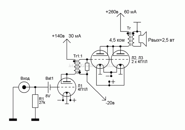

Did you mean on this forum.Nobody ever used a 4P1L as a line stage because of microphonics - we've moved forward to starved filaments, filament bias, DC regs that work in filament bias, using a 4P1L as a driver stage, active loads, constructing chassis solutions to minimise microphonics and so on.
In Russia, many gathered similar to this scheme. The results are good. Lamps in pairs can not pick up enough food separate glowing.
