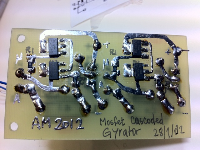

“The Siberian” (4P1L DHT Pre-amp) suffered an amputation during last Christmas, as needed the gyrator board for my 45SET amplifier. In the end managed to build a couple of cascoded mosfet gyrators and decided to bring back to life the russian pre-amp. But curiosity took me through a different path yesterday, and removed the 4P1L and tried a couple of nice Ken-Rad 71a triodes.
After playing a while in my workbench, I found a low distortion operating point at about:
The pre-amp circuit has not changed from my previous designs. In fact, the gyrator now is composed of a cascoded depletion mosfet using the BSP129. These are easy to find here in the UK, and my SMD soldering skills have improved so why not use them? Their characteristics are quite similar to the DN2540s (VDS=240V, IDSS=350mA, PD=1.8W, Gfs=0.36S, Ciss=82pF and Coss=12pF).
As filament resistors I used NOS russian power wire-wound 51 ohm resistors which probably can handle 10W or more.
The pre-amp performs beautifully and distortion is only 0.02% at Vi=1Vrms.
M1 gets really hot dissipating more than 1W, but so far is performing well. You would probably want to use a DN2540 in TO-220 case here instead.

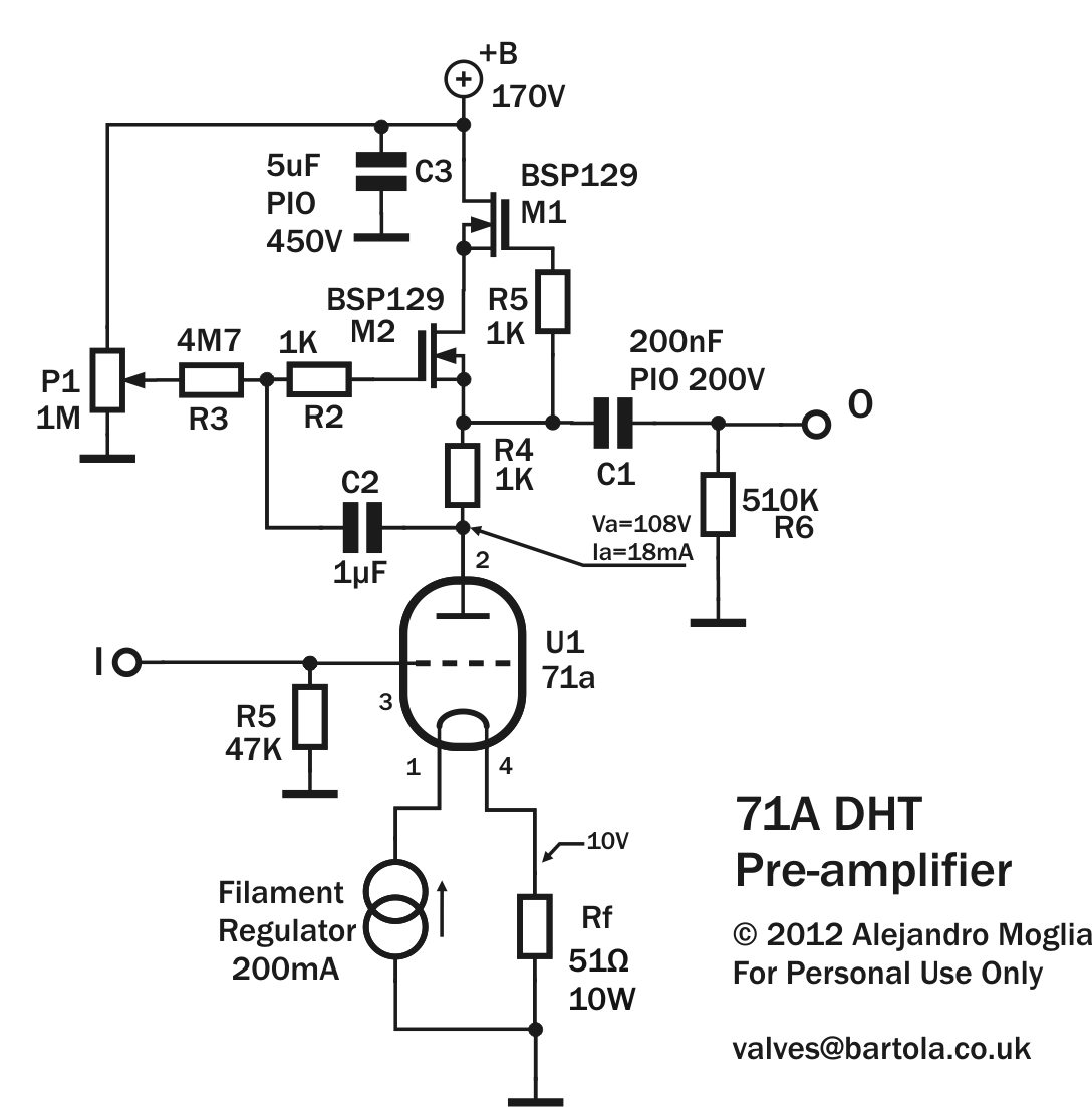

- Anode voltage: 108V
- Anode current: 18mA
- Bias voltage: -10V
Last night I hooked up the pre-amp and listened to some classical music.
Impressions so far? Well, it sounds superb. Another good DHT valve to be added to the top ten chart. Bass is good, treble is clear and overall tone is warm and pleasant.

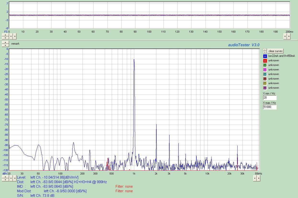

Today I did some experiments back again with the 6P21S. This little chap is not microphonic at all. As per my previous post, it shows to be really linear. When did a listening test a couple of months ago, I remember it to be very clean and warm.
Starving the filaments provides an interesting impact on the harmonic composition. When lowering the filament current it changes the amplitude of H3 in comparison to H2. See attached diagrams. The minimum distortion is achieved at 440mA (THD=0.01%), however when increasing filament current to further 410mA, distortion increases again due to mix of harmonics, becoming more pentode like. At 450mA you get 0.06% but a richer harmonic mix....
All tests were done with the following setup:

What means did you take to compensate for the shift in effective bias since you are using filament bias? When you vary the filament current the operating point of the tube also shifts by virtue of the change in filament derived bias. (Less filament current means less bias voltage as well)
I suspect it is very difficult to separate the effects of filament starvation from shifts in the OP when using filament bias. It would be very interesting to apply fixed grid bias and repeat the experiment.
As designed IMHO it would be impossible to separate the effects of the two variables that change as a result of shifting the filament current.
The results you show are very good however, and I also suspect you meant 410ma, 440mA, and 450mA in that order for the filament currents? (Can you clarify?) 😀
Yes I did compensate for the effect i.e. had to readjust the anode current. I wanted to see the difference at same operating point despite knowing that the valve characteristics are impacted overall when the filament is starved....

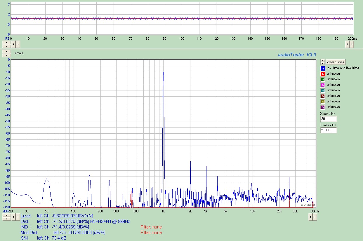

Sorry Kevin, forgot to answer your last question.
What is surprising is that the distortion is minimum at 440mA and not 410mA. Below 440mA the distortion rises again as the profile of harmonics changes as well. I've seen this in 4P1L (another direct heated tetrode -triode strapped)

Interesting, it seems like there is some sort of minima, I've no clue as to what might be the cause.
See post 216 for the plate curves at If=410mA - clearly the DHT behaves differently at a certain point of filament starvation. Perhaps an expert on valve physics and thermionic emission can shed some light here 🙂

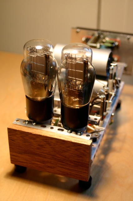

Right - my first listening test with the 4P1L. I have them as a differential pair driving PP 2a3s. Right now I have 170v on the anodes with a plate choke made from the 90K side of the Hammond 124b and FT-3 coupling caps. OPTs are O-netics 6.6K. 600 ohm shared cathode resistor unbypassed with 13.6v on cathode, so about 11mA each tube. I should do something with the cathode arrangement like a negative supply - I have -57v available. Or a CCS. Slightly starved filament - 3.8v. Screen and grid 3 connected to anode
Anyway listening tests. It's a very detailed sound with good bass. But I have what is a real problem for me. I'm all about timbre - woody clarinets and bassoons, breathy flutes, real sounding French horns. I'm getting quite poor timbre - the strings are OK though not very silky smooth, but the woodwinds are nothing like my 300b SET with 46 inputs. Sound is rather thin and unmusical - woodwinds are only half recognisable as the authentic acoustic sounds I'm used to with DHTs. I've seen that Klaus said the same, like "Curves are nice, although my experience is not as rosy: i tried it with 60..80V on plate, battery bias, and the low-current versions (3..6mA) were thin-sounding. Increasing Ia to 15mA (Vg=-3V) added 'body', I suspect the tube likes generous currents" Baby of Camel - All DHT PP
So my question - what am I hearing here? Can others confirm or deny that that this is a bit thin sounding and lacks timbre? Is it possible I'm getting too much 3rd harmonic from starving the filaments. Any ideas? I want to try and rescue this project, but disappointed right now. My experience with the 46 has been really excellent timbre.
What can I try here?
