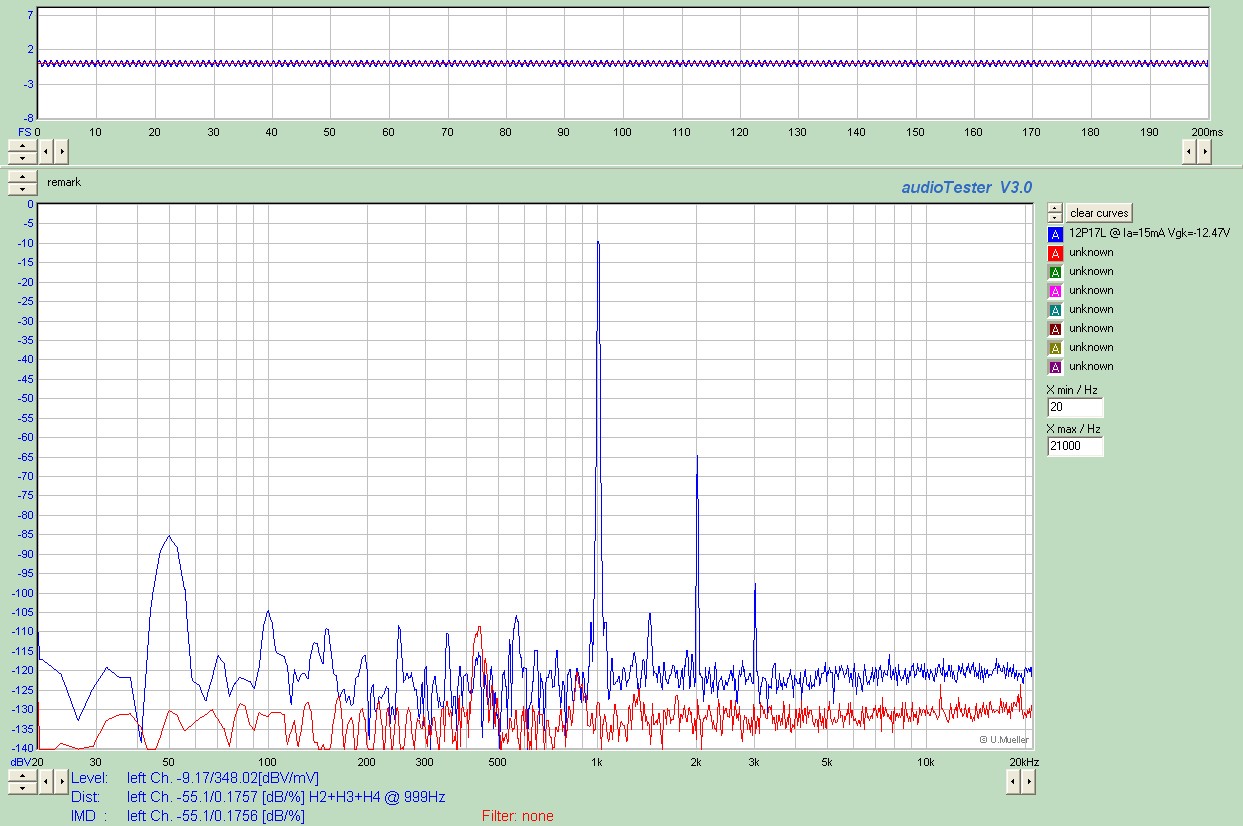

Surprised with my first test results. Measured a simple 12P17L stage with a CCS load.
I played around to find the best operating point at Ia=15mA (or higher current) and biased at Vgk=-12.5V (LED array). Va=178V
Stage gain is about 10.5.
Interesting to find was that THD wasn't as good as a 4P1L. Got minimum of 0.17% (other DHTs perform far better than this)
I may need to do further testing to find a better sweet spot for this tube...

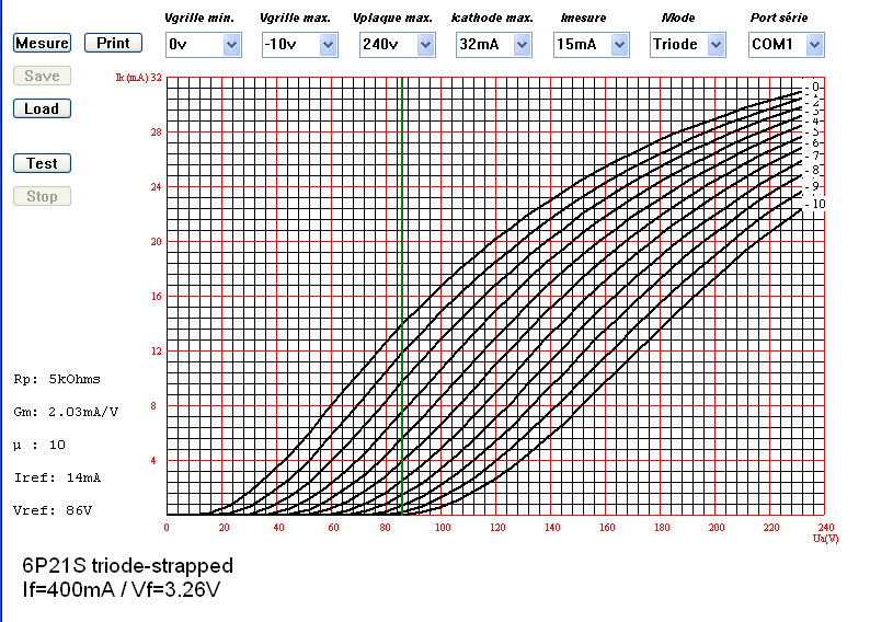

Went back to revisit my 6P21S tests. The 6P21S is a very nice power directly heated tetrode on an octal base. The heater is designed to run on 6.3V supply, not cheap at all, but a great candidate.

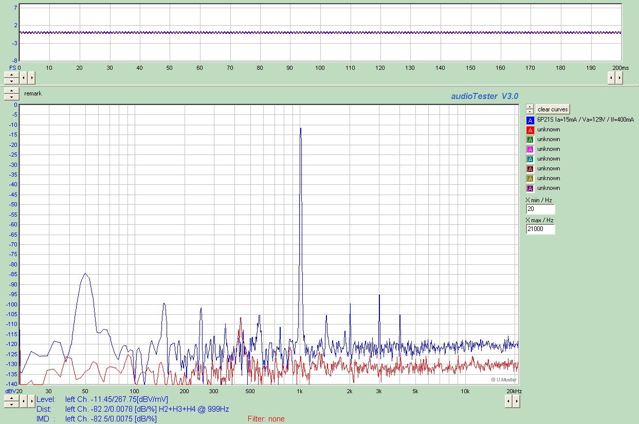

I believe I found a sweet spot in terms of distortion for this tube. I reduced the filament current to 400mA and got the following results:
Lowest distortion at:
Ia=15mA / Va=129V and Vgk=-4.9V (LED array bias)
THD=0.008% when loaded with a 47K resistor. Really linear. See attached frequency response diagram.
This is not a high microphonic tube, so should rewire my preamp to what this big fellow to perform again!
Edit: interesting to see how the third harmonic rises a bit over the second when running the tube at this low filament current. Keen to listen to the change in tone (if I can notice the difference though!)

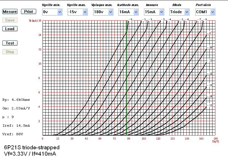

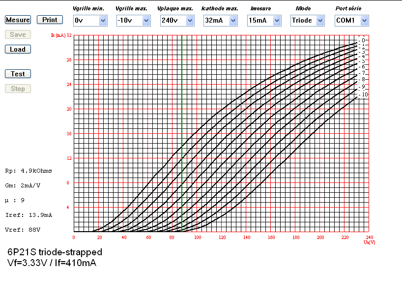

Some more tests on the 6P21S. The third harmonic components is explained when you plot the anode curves for that filament current. See attached.
Proper triode curves appear when If=450mA.
Went back and did further tests with If=450mA and distortion is around 0.10%. When lowered down to If=410mA got a superb 0.04% which is the best I can get out of a 26/226 stage at the moment.

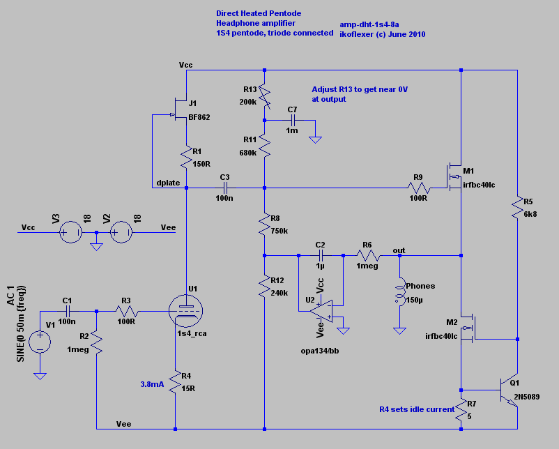

My planes are to use the 4P1L with ikoflex's output stage. Cheaper than an OPT and can have a direct headphone output.
As far as microphonics it may be an problem without an OPT, but I think its worth a shot, see any issues?

Now traced curves with filament at 410mA. See attached. They are really linear within the quiescent point tested before
I may try this configuration in my Siberian instead of the 4P1Ls....

Very interesting design. I was looking at trying out this very simple circuit based on Broskie's hybrid CF+:
http://www.diyaudio.com/forums/tubes-valves/202283-dht-headphone-hybrid-cf.html
I will run the 4P1L at 20mA, lower filament current as stated below in my previous posts and suspend the sockets. Specially if you are planning to use them in a headphone amplifer. Why not changing the current FET CCS with a gyrator Mosfet?
I need to study the circuit to understand how the servo operates with the output mosfets

Honestly don't have much experience with the gyrator design.
I have a LTspice simulation of the buffer portion of Iko's schematic I can send you, I can't find a flaw in it. I did some intensive Gootee analysis of the servo and it stays well out of the midrange in the simulations.
