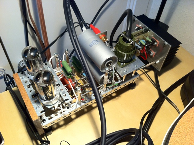

Got the 4P1L "Siberian" preamp hooked in my 45 SE. Of course as expected something always goes wrong and I damage the Salas HV shunt regulator so had to remove it and power the pre-amp with the raw supply. Not ideal, but it's well filtered though. Will need to repair the Salas shunt regulator now.

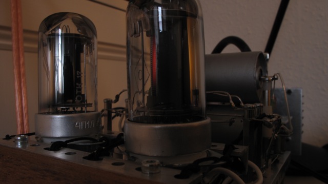

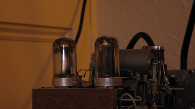

Have been running for 30 min or so. Now playing Beethoven's violin sonatas. It's getting better now! Any idea of any burn in time for these valves?
They don't glow too much, especially if you run them at low filament current like in this case. A dim glow from the filaments. See attached

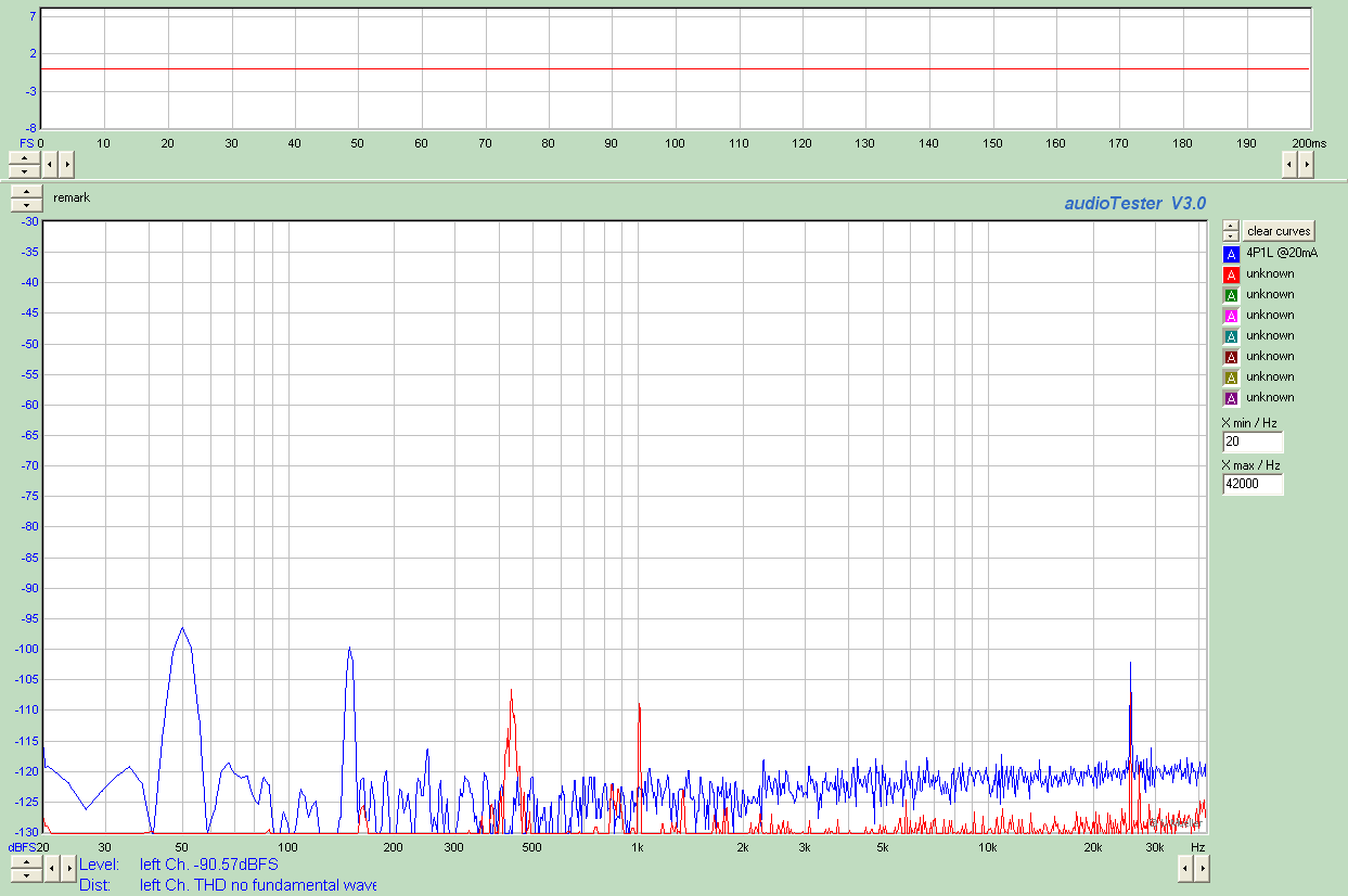

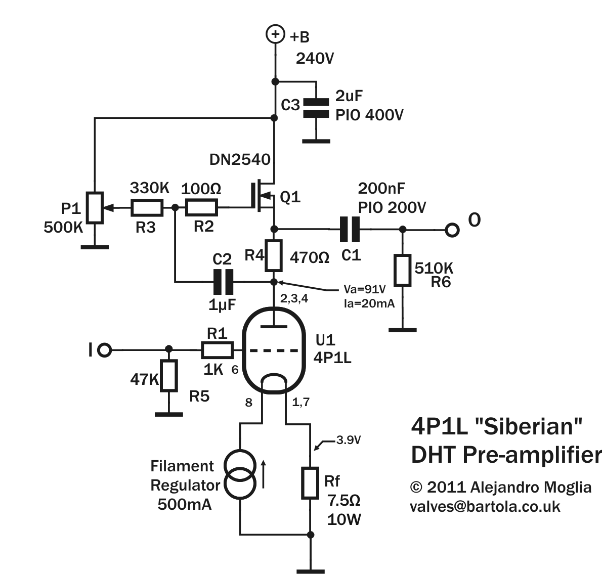

THD response and updated schematic attached.
Looking at increasing the value of R3 to improve the gyrator frequency response. Haven't updated the LTspice simulations, but before doing so, any recommendations around the practical value of this resistor? 1M or even higher? I've seen this to be around 4M7, but then Rod recommended a lower value. Bearing in mind the capacitor is already 1uF 😉
Thanks for the help
Ale

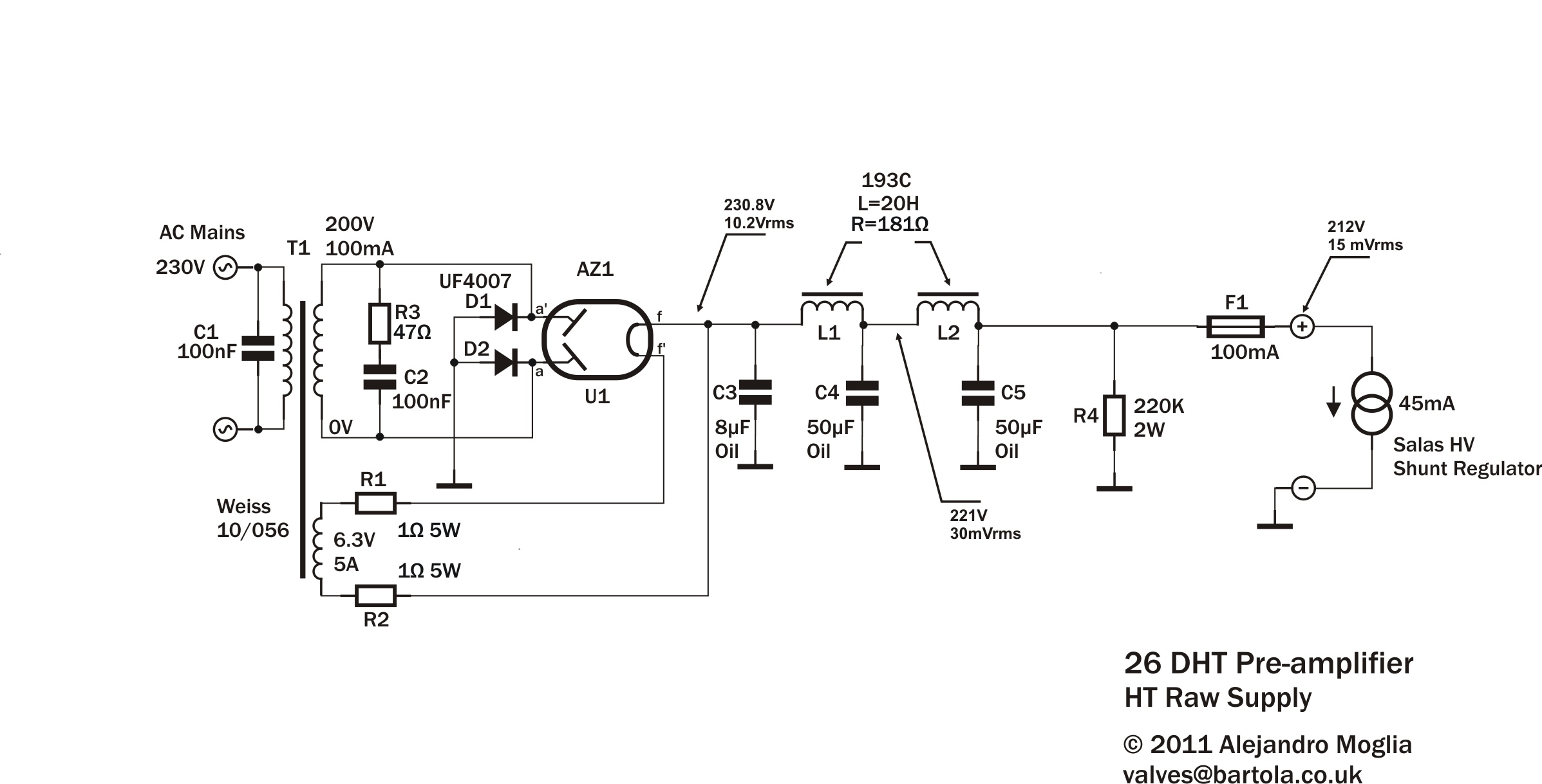

Ale, is this still with the dn2540 gyrator plate load? What psu filtering are you using at the moment?
Iko,
Yes. Gyrator loaded. See previous post. Added a 2uF capacitor on the preamp chassis. Blew up the salas HT shunt regulator so I'm using the HT raw supply. Is a CLCL stage using a hybrid AZ1 rectifier.
See attached

Amazing FFT, is this without the Salas? Espect the 60hz hump will go away with the salas or is this a groundloop. You mentioned measuring without the B+ only the coleman supplies, can you post this FFT ?
Awesom job BTW, it sounds like the cord you found for suspension is doing the job. Only thing is you said average gain of 9, I thought that with a ccs/gyrator this tube should be close to a mu of 15 ?
Hi Regal,
Doesn't seem to be a ground loop to me. I need to turn the volume up really high to listen to the hum. See attached the filament noise FFT - highly recommend Rod Coleman's supply boards!
The suspension seems to do the job BTW. Gain is 9, where did you get that the mu=15 triode strapped? As I didn't have the data at hand, I had to trace the curves. See attached....

You are right I was thinking of a different tube, the file trace I downloaded from somewhere shows a gain of 8.
For a headamp the 60hz bump at 90 may be an issue with these sensitive headphones, but I doubt it.
What was your output Vrms with the previous FFT? The complete absense of anything above 2H is really cool.
I guess I need to let you get back to restoring that Salas reg, if its any help I've found that the MJE350 is the one that usually goes (but I have protection diodes on the mofsets.)
Input signal was 1Vrms and output 9Vrmsvc😉

Given the cost of this preamp, it blew me out so far. I started playing with a breadboard using Thomas Mayer's aluminum rails, but liked its look when it evolves.
It has a minimalist look, very simple. Have shielded all connectors so left it without fitting it inside a proper aluminum box. So far so good

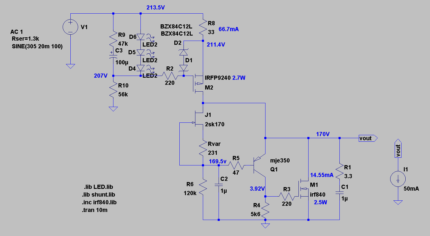

Ok, just tweaked the Salas shunt regulator to get about 67mA across the pass mosfet. Not sure if measured correctly the internal resistance of my HT raw supply but must be around the 1-2K based on previous measures.
Adjusted R8 to set the shunt current. Will 67mA suffice?
