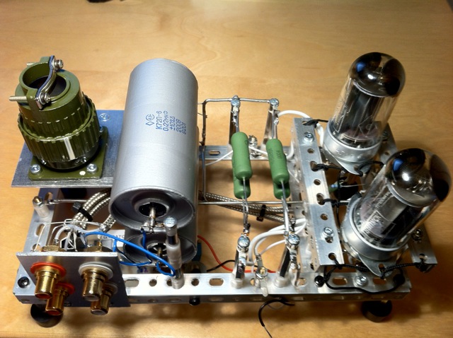

Rearranged the layout to fit the RCA connectors and the power connector. I left space in the back to bolt the heat sink and the filament board.
I quite like the minimalist look of this preamp. I want to see if I can avoid fitting it in an aluminum case. I have shielded input and output cables, so hopefully that will do the job. Will test and report.
I realised that by lowering the filament current to 500mA I need to change the filament resistor as well. Keen to see if I can notice the difference by changing slightly the quiescent point though...

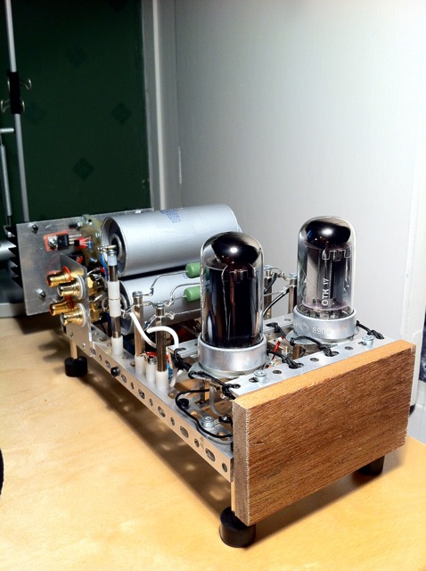

I completed the pre-amp work today. Got the filament boards, heatsink and wired the multipole connector. My HT supply has a Salas shunt regulator optimised for the 26, so need to tweak the supply to enable driving these 4P1L.
Yesterday was looking at the preamp and realised that most of its parts are Russian: sockets, valves, filament resistor, output capacitors and connectors so decided to name it "The Siberian" 4P1L pre-amp.
Hopefully tomorrow will be able to do a final listening test!
