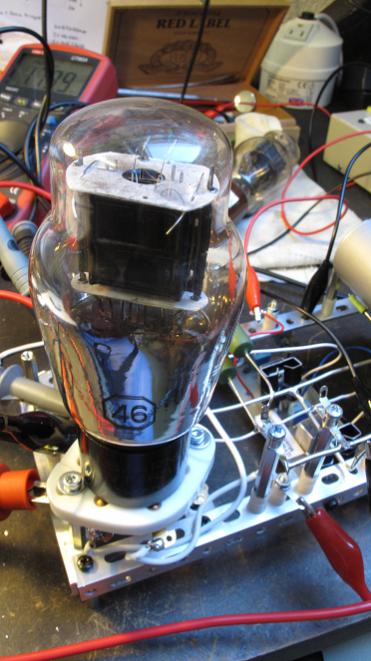

Went back to revisit the 46 triode-strapped. This is a great valve indeed. Running filaments at 1.266A, anode current at 18mA/Va=139V. THD is 0.08%. Half of my previous test at an expense of running the valve at 80% more current.
It sounds superb. Comparing to 4P1L, the 46 is not microphonic but less linear. Both sounds amazing: hard to make a difference in my workbench with the old solid state technics amp I have. Not the ideal testing scenario, but it is what it is...😎

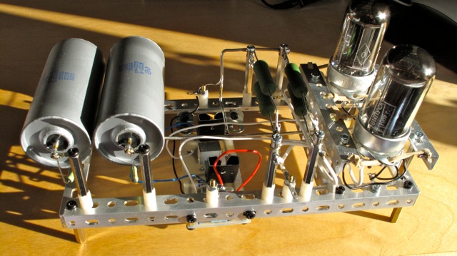

Thanks Thomas. I realised that testing some of all I have learned so far is the best way of improving 😛
Yes, I have considered TVC. This DIY hobby is dragging me down to the financial bankruptcy. TVC are expensive though, any one you would recommend for a tighter budget?
BTW: the aluminum rails you sold me are fantastic. You can build up quickly any setup and is like playing with meccano

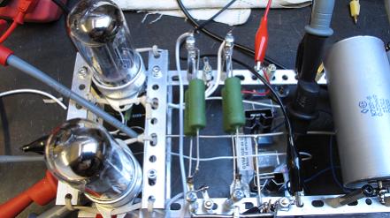

Re-assembled the preamp to fit the 4P1Ls suspended with a couple of rubber bands . This works great, you have to tap the valves significantly now to get an audible ringing. No feedback perceived to me due to microphonics.
The minimum filament current to run these properly is 500mA. Below this, distortion increases, etc.
Got them now running at 29mA and 105V. At this quiescent point the THD is 0.027% - really low. The HT supply is set to 200V which is what I have on my 26 preamp supply. So could use same supply now.
Need to get the LT supply done now....
Sounds really nice
