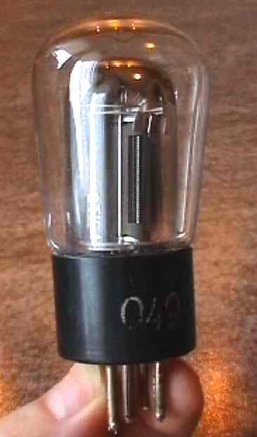

Anatoliy, any idea why there might be an envelope within an envelope? Could it be for high altitude use? 😀

He made it for a vintage radio, to match shape and size. I once saw "golden" 6SL7 with soldered inside 6N17B-V tube.

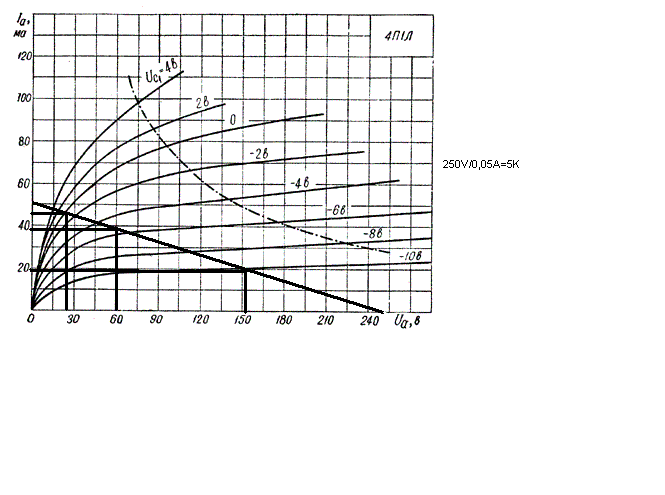

I drive them in output stage up to +12V on G1, with 5K load each. 2 in parallel, 2.5K load, +250V B+, 5W output.

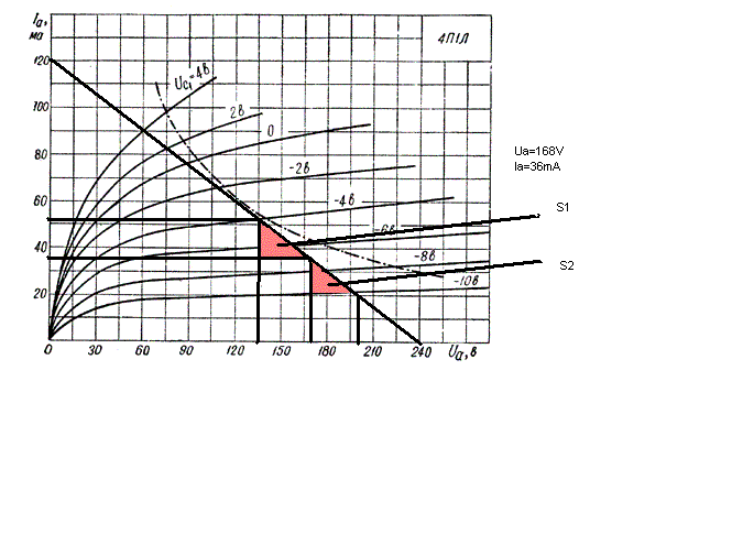

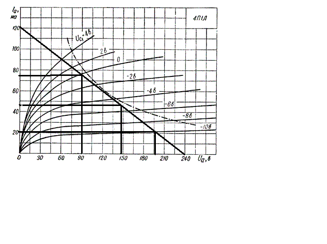

This VA characteristic correspond tube made in USSR. Tube is very best!
You must correctly choose working conditions. In SE this tube return 1VA,
for extremely sensitive acoustics .

Those curves are for pentode mode and I'm planning to run the valve in triode mode. Have plotted the triode curves before but don't have them here right now. On previous distortion measures some of us found that THD was minimised at 80V and 25mA. Haven't tried how it sounds at different op points yet....

Hello, I don't translation many. This tube in triode mode is good, but out power smaller . I is opinion by VA characteristic. But and pentode mode is super (S1=S2).

He In SE this tube return 1VA,
I was getting, as I said before, 5W from 2 tubes in parallel, in triode mode. Load was 2K4, that means about 5K per tube. However, I was driving them with cathode follower, up to 12V positive peak. For preamp that is discussed in this topic such power is not needed, so the higher is dynamic load resistance, the less distortions you are getting from it. That's why we discuss gyrator load here.
