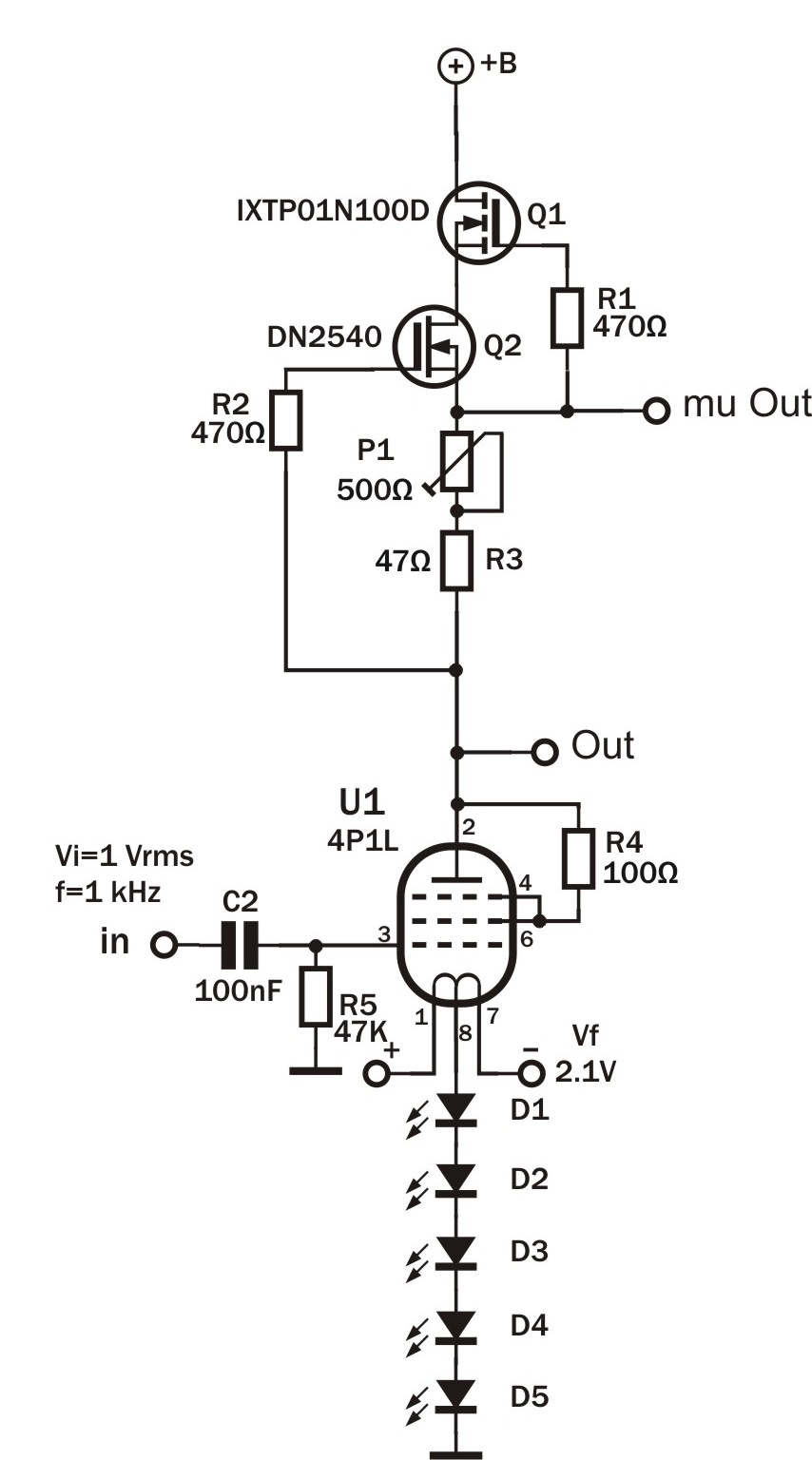

Again. Have done some testing as I posted in the 26 pre-amp thread.
Attached is my modular test bed using Gluca's board for the IXYS Mosfet CCS. Filament and HT supply is regulated from my lab power supply.
So, after a testing several operating points I came up with the best one in terms of distortion:
Ia=25mA, Va=77V, Vg=-5.8V (LED array combination of amber and red ones)
THD = 0.019%. Slightly better compared to my best 26 valve measure. I just tested one 4P1L which I had at hand, may need to check if there is a more linear one, however, as it stands the result is really good compared to other valves!
Any suggestions around trying a different op point? What about biasing around -15/-20V and increasing the anode voltage? Will improve distortion?
Ale

Ive played around with the 4P1L....
Wow! Incredible Microphonics! That things ring like a bell if you make any harsh vibration, and if you tap 'em they ring for many seconds!
I was running about 80V anode and around 25mA with a MOSFET on top, and std cathode bias un-bypassed.....
Hi Alistair,
:-( that doesn't sound very encouraging though. I did tap it whilst driving it with a 1kHz sine signal and couldn't see any traces of ringing in the scope...
Well, I got very close with the operating point anyway!
Will have to build and test this on a real amp...
Ale
Maybe its the tubes I was using, I have 4 'svetlana' ones and 4 of some other make, They all rang like bells!--Although slightly different tunes!...
I had arranged the test as the first stage in an amp just to see what they would be like.
I was using a SLA batt to supply the heaters via current limiting resistor, and had it triode-strapped....
I think that in a power-amp, the step-down ratio of the output transformer probably lowers the level of the ringing considerably. (At leaast I hope so! as I intend to build one soon) As a preamp, they ring if any loud noise is made in the room, although admittedly, I have done nothing in the form of damping for them, as this pre is still an experiment.
The idea of putting leds in the cathode is to give it constant voltage. But leds have rather high dynamic impedance. I did some measurements to determine the Rdc of leds by changing the current through them and measure the voltage difference and found the following values: Red 5 Ohm, Green 15 Ohm, Yellow 18 Ohm and Blue 37 Ohm. When you put a string in the cathode these Rdc values add.

Hi Peter,
Will try bypassing the leds. Have some PIO around and will give them a try...
thanks
Ale
Unbypassed leds will sound a lot bettter bypased. Even when you use 4.7uF MKT. Let us hear what you think of it!
Peter
Hi Peter,
Your experience with LEDs somewhat contradicts my own, although I have run into some red leds with a dynamic impedance that was much higher than I expected. Just wondering how you measure the dynamic impedance of LEDs - might be something I could replicate here. I have not measured anything but bad red leds, (>10 ohms) and IR leds which had very low impedances of only an ohm or so..
I also haven't found bypassing them with capacitors in most cases to be of significant benefit, so I am wondering what in our experiences makes our two conclusions so different.
Just curiosity on my part, seeking to understand something I may not understand as well as I thought..
Thanks, Kevin
The way I measured the dynamic impedance is not really scientific, but what I did is change the DC current trough the leds (bench power supply and 1k resistor in series with the led) and measure the change in DC voltage across them. Rdyn.= ΔU/ΔI.
First I have tried bypassing them with Elna Silmic but with no positive results and later with foil capacitors with good results.

Pretty much what I do, but I am wondering as the results I get are always significantly higher than the data sheet values.. I'm thinking about making a jig where I modulate the DC constant current with a defined AC current and then measure the AC voltage component developed across the LED..
