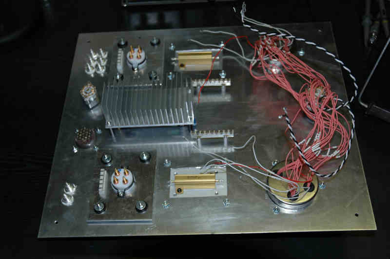

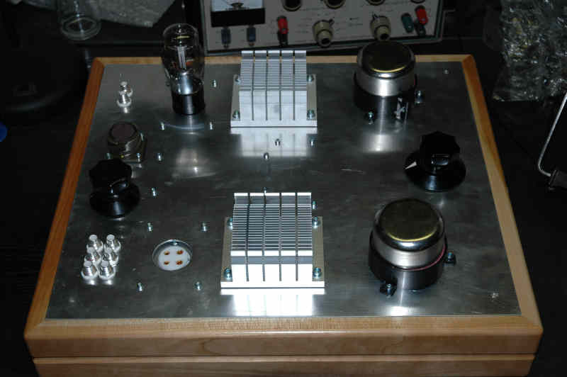

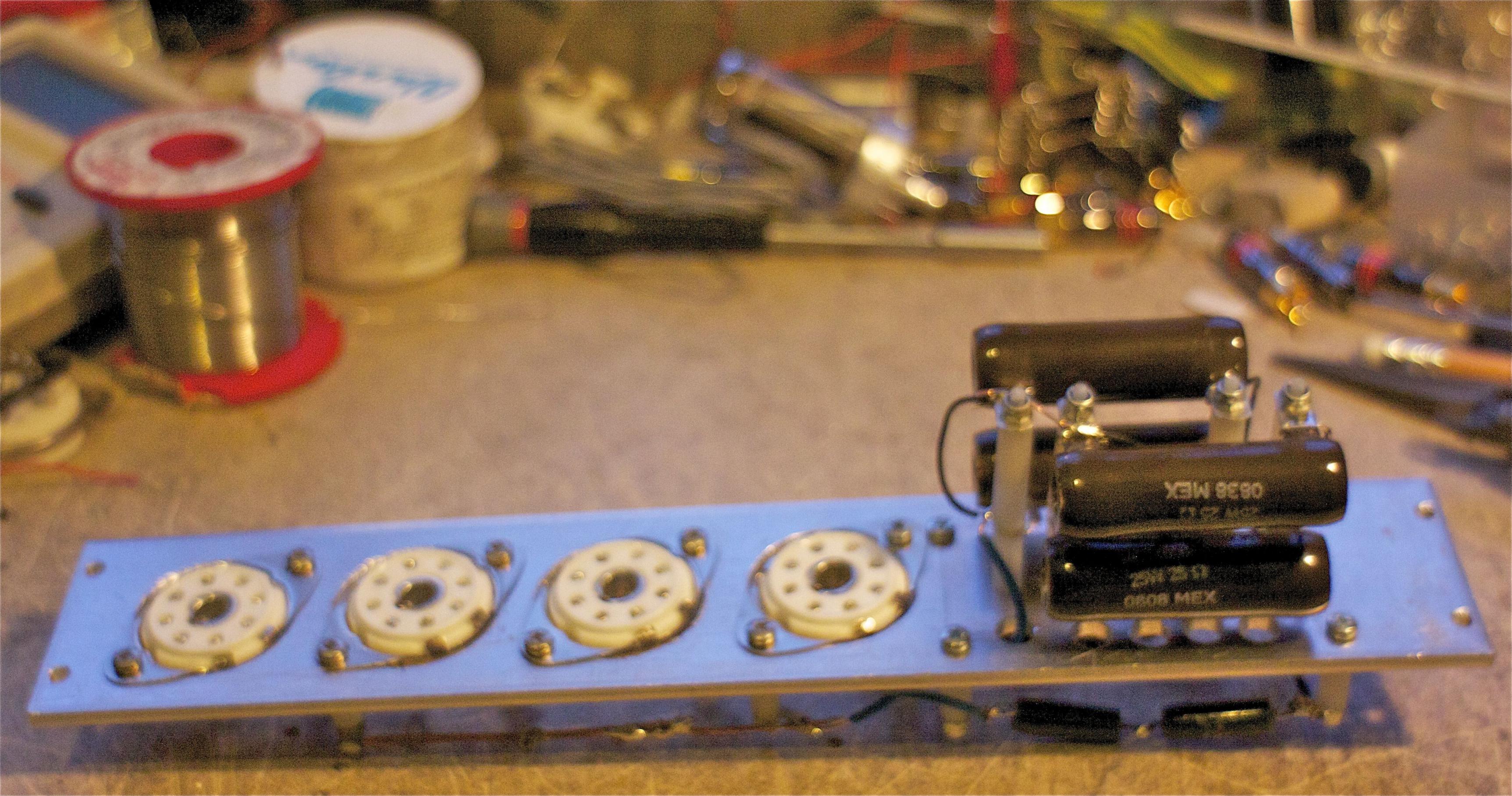

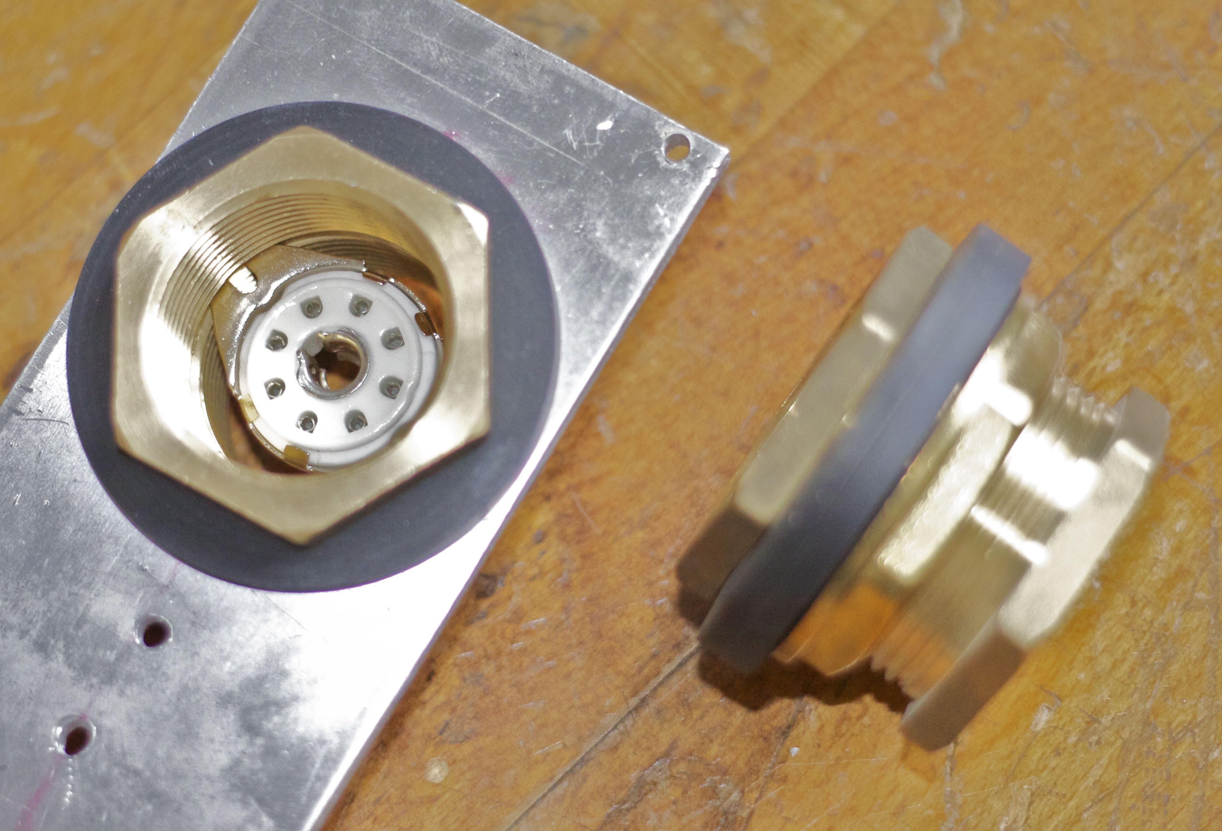

Here are some methods - my current line stage and proposed "overkill" arrangement with plumbers units. Top plates are 4mm aluminium.

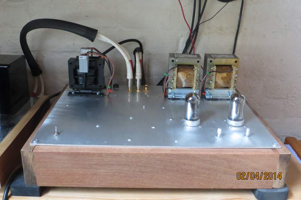

Hi.
Thank you for your suggestions.
I have my amp in a homemade chassic made of azobe "iron wood". This helped on
the microphonic, and I have ordered the "silent blocks".
Will try to add the "silent blocks" when they shows up.
I have 25 hours on the beast and its getting better.
Michael.
Hi Michael,
Try to use suspended sub-chassis.
In the sub-chassis mounting holes I use rubber grommet, and between the sub-chassis and the socket I put rubber sheet.
Hi Euro21...
First i would like to suspend the sockets from the aluminium plate.
Then I'll suspend the trafos from the chassis. Tried with some rubber which
turned out to be quite efficient.
The Silent Blocks would be my choice here.
If I don't play to loud "normal listening level" it's quite okay now.
When I started it was a disaster. Now it's much better.
I really like the sound of the 4p1L. Bass response is way over my wildest
expectations. Midrange and top is starting to be a lot better.
My speakers is a pair of tannoys 385-HPD alnico, in a 303 liter internal volume enclosure. Running on a 2a3 loftin-white amplifier.
Michael.

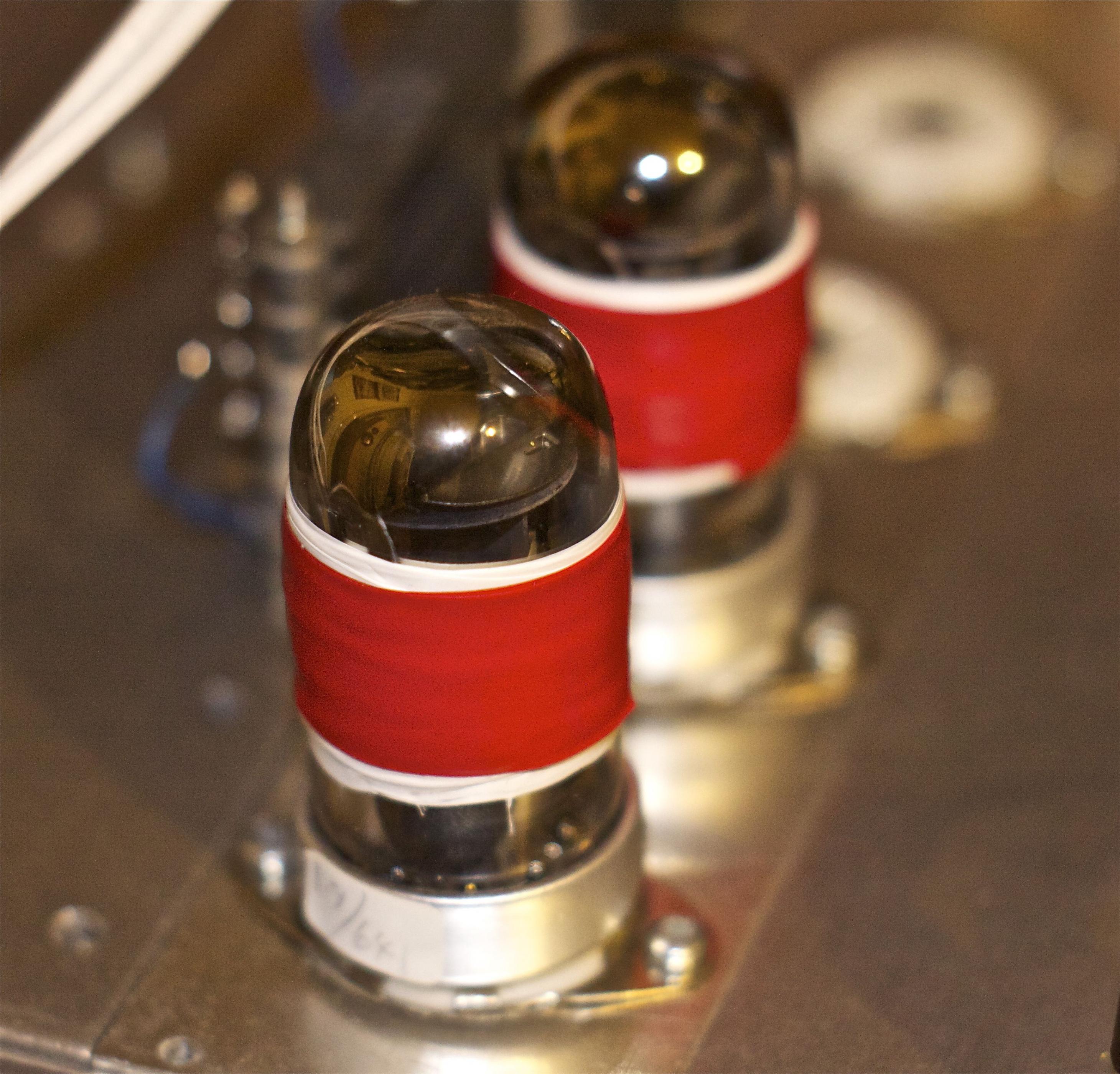

Before you do any drastic rebuilding, put the chassis on something really soft and spongy. And wrap teflon plumbers tape round the bottles several times. Remember that there is both air borne and structure borne vibration.
I don't know why you want to suspend the transformers - surely they add mass to the chassis which is good? It's the glass bottles and the filaments in the tube that vibrate.
You could make a subchassis for the sockets - may be overkill. In that case mount the sockets on a double thickness alu, like 8mm. Mass is your friend. You may prefer to use bendy springs to decouple - think Linn turntables.
You need to think a bit about what you are doing here. I know Ale uses the rubber decouplers, and I pretty much have faith in anything he does, but I think it's possible to achieve better decoupling than that by imitating turntables. There's also the SME turntable which used multiple rubber bands. Like the Linn they use gravity to suspend the sub-chassis. And because gravity works better on heavier objects, the mass of the sub-chassis should be robust.

Where do you buy your "teflon plumbers tape" ???
Will try it, just in case... It looks nice on the tubes 🙂
