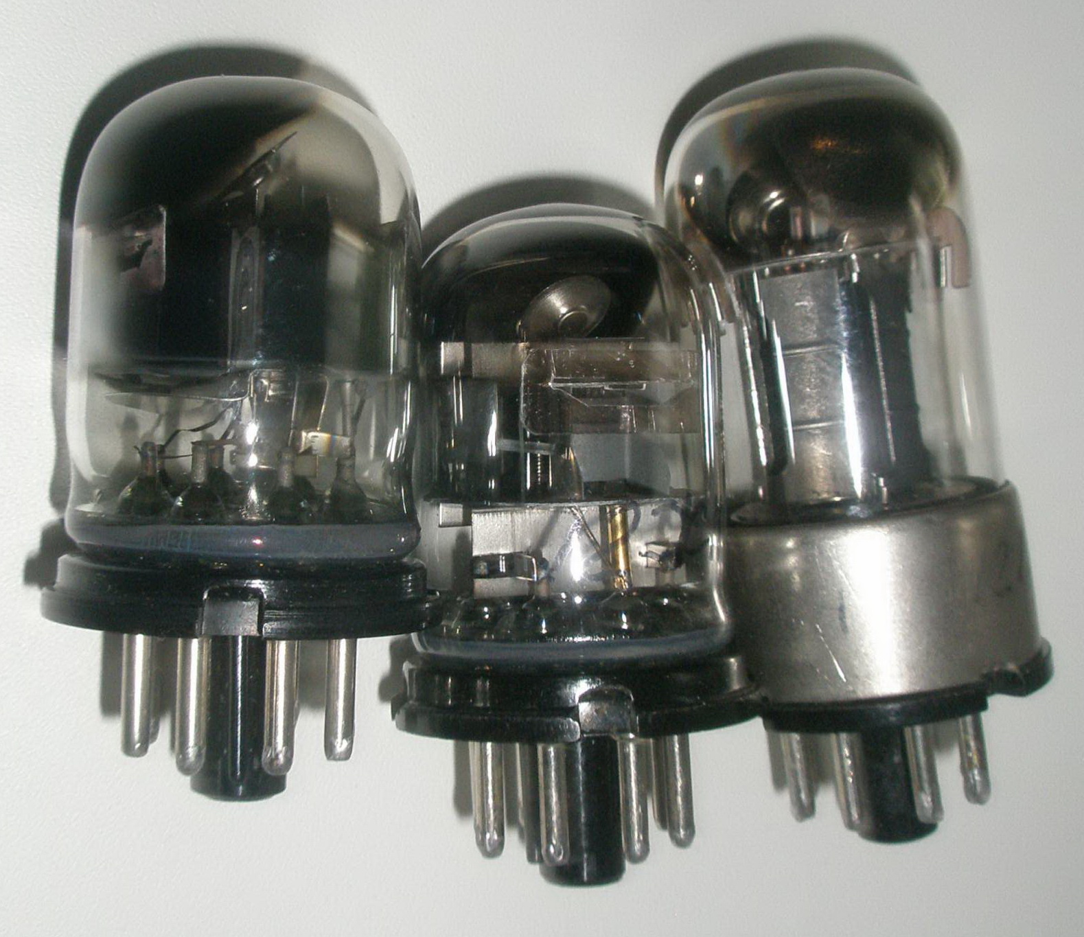

I want to start getting parts for a 4p1l preamp. Do you have any suggestions on where to get the tubes?
Hi Merlin,
Well that is not so difficult;-) I am looking for experiences with tube vendors both indside and outside ebay
Hi Merlin,
Hi Nightpuma,
I bought them from different vendors. I started with gstube.com where they have nice sockets too. I bought also from tubes-store.com and siberian shop. Recently I had un unpleasant experience with sovtube.com. They sent me nasty looking tubes ( all tested good but a lot of dents and aluminum oxide). Never bought from ebay.

I used this seller NOS matched pair 4P1L directly heated output pentode f.tube amplifier same Year | eBay
Hi!
You guys convinced me and I just got a bulk pack of 100 of these tubes before prices skyrocket because of all the hype 🙂
I never really used loctal sockets (these are loctal bases, right?) Anybody have a recommendation for some good loctal sockets or wants to swap some sockets for tubes?
