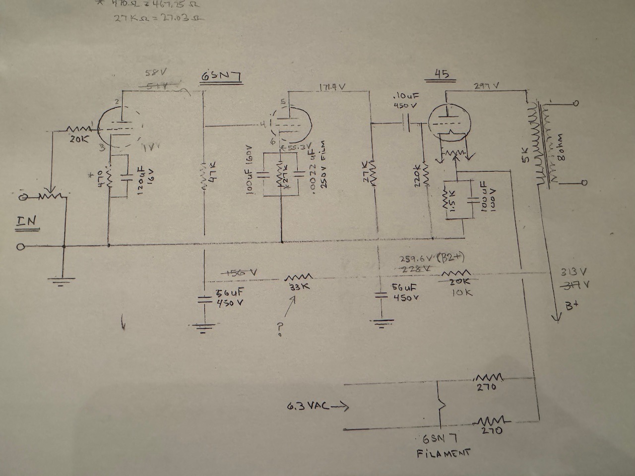

Looking at schematics posted in my first post.
There is a 20K resistor dropping B+ from 310V to 225V(B+2)
That would give 4.25 mA?
Based on that, if I change the 20k resistor to 15K will that bump the B+2 voltage to 246V…Putting 192 V on the plate after the 27K plate resistor?
Did I do this right?
if I haven’t screwed this up yet, will the other voltages rise proportionally leaving the same bias on the 6SN7 tube?
Hmmmm. No analyzer no simulator software. I was hoping for a nudge in the right direction.

Changing the 20k resistor to 15k will raise the B+ on both 6SN7 plates.
But how much depends on a couple of factors:
The plate impedance, rp, of the 6SN7 with the low current that you have might be 9k Ohms.
You would think that increasing the B+ by 10Volts would increase the plate current by 1.1mA (10V / 9000 Ohms).
The extra 1.1mA will cause more voltage drop in the plate load resistors.
And the increase in plate current will cause more cathode current to flow in the self bias resistors, so there will be more bias volts.
Just for fun,
First try 15k, measure the plate voltages, and the cathode self bias voltages.
Then try 10k, and see if gets the plate voltage and bias voltage you want (This might be more like you were planning).
Otherwise, you have to look at the 6SN7 plate curves of plate current, plate voltage, and bias voltage, and figure it from there.
Yeah, there's not an algebraic solution, because the valves' current draw isn't like a simple resistor (sorta/kinda close, but not exact). Fortunately, it really doesn't matter much. More voltage is more better. If you have adequate decoupling, you want as much B+ as possible, thus as small a dropping resistor as possible. Decoupling can be maintained by making the B+ bypass caps larger and/or by dividing the resistor into two (or more) parts with another bypass cap in between.
An exact answer would require an iterative process of taking an estimated total current drain, drawing loadlines for both valves, finding actual current draws, calculating new B+, and drawing new loadlines, etc. Spice would do this for you, but the gig isn't all that critical. I'd personally do it like 6A3sUMMER suggests, try a dropping resistor, maybe try another one.

6SN7 measurement before and after changing B2+ dropping resistor
Maybe I’m doing something wrong, but this seems ridiculously low. Is my math good? Thanks!
20K B2+ dropping resistor : B2+ = 228.4V. (B+ 313V)
1st half / 2nd half
V drop across cathode resistor (R = 467.25 ohm): 1.03V. / (R= 27.03Kohm) 55.3V
V plate to cathode: 49.8V / 117.4V
= 2.204 mA/ 0.109W. / = 2.046mA/0.24W
10K B2+ dropping resistor: B2+ = 259.6V (B+ 308.5)
V drop across cathode resistor 1.174V / 63.23V
V plate to cathode: 57.0V / 133.1V
=2.512mA/0.14W / =2.34mA/0.311W

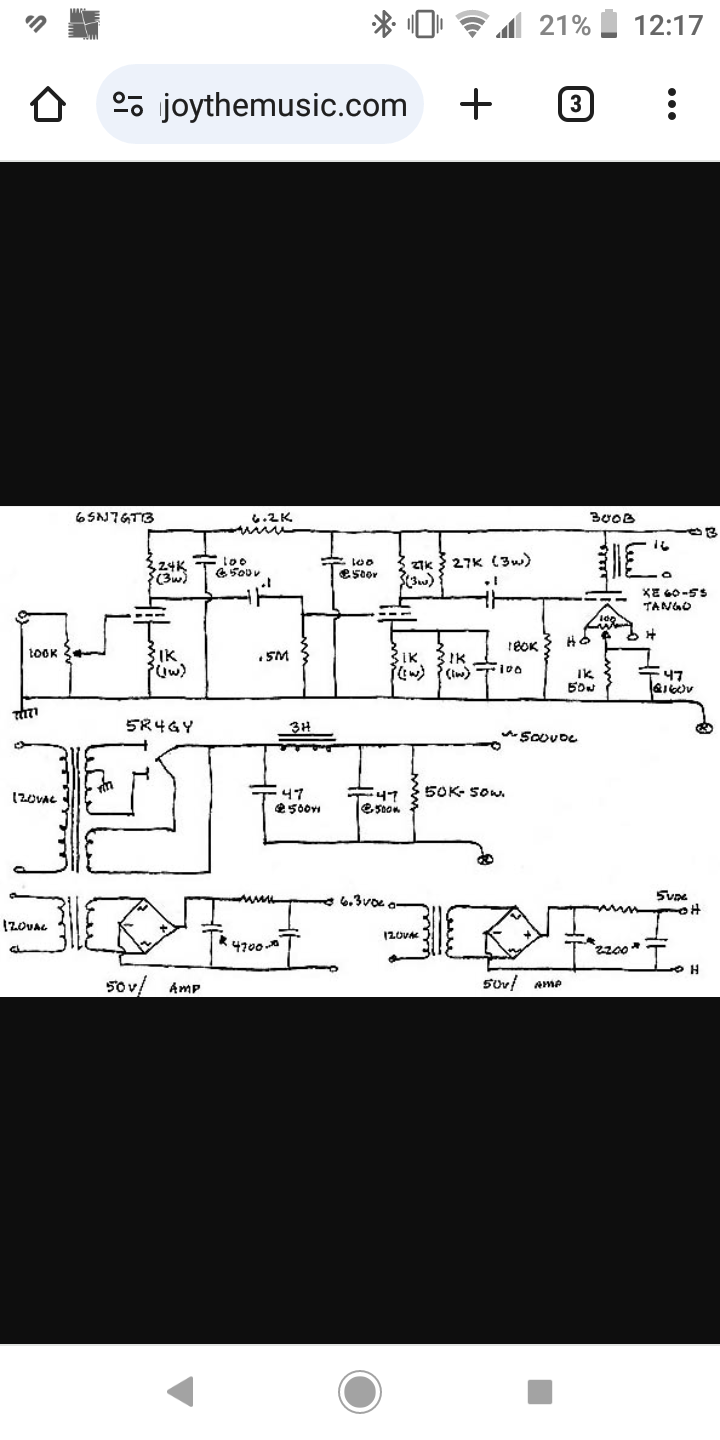

Rob7,
I forgot that the cascade (not cascode) input and driver tube are DC coupled (your schematic in Post # 1).
A single 6SN7 stage with the right plate load and cathode self bias resistor with bypass cap would give a gain of perhaps 15, and lots of bias voltage;
and give a linear peak to peak voltage swing of about 80% x the new higher bias voltage x 2 x 15.
Or, change the circuit to use RC coupling between the input and driver stage. That lets you use some real current in each 6SN7, lots of plate volts, lots of gain, and good linear peak to peak voltage swing. Just change the resistors for the 6SN7 cathodes and plates, and you will be there.
I seem to remember a good amplifier that used the 6SN7 in Cascade, Not Cascode. If I remember correctly it was Herb Reichert's "Flesh and Blood". There was no negative feedback. It had enough drive for a 300B, so it should work very well for a 45 tube.

Any thoughts on the 6SN7 in cascode , as used in 300B modded “Morrison”, for the 45—with appropriate power transformer?
Rob7 attached Flesh & Blood schematic as suggested for 6A3sUMMER

Results of changing out 20K (B2+) with 10k
I did the math on the biasing on earlier post. I believe I did it right, and if so, the triodes are biased extraordinarily cold. Maybe some further resistor changes will help both this and the voltages.
A few questions.
1. What is the likely reason the designer put the 33K resistor (arrow) there instead of just increasing the plate resistance on the first section? (Possibly too much voltage swing?). Any thoughts on reducing the value of the resistor?
To what value?
How about eliminating it altogether?
2. If I reduce or eliminate that resistor, what are the effects on the bias on the second half?
Should I:
a) increase the 47K plate resistor accordingly to keep the voltage relative to the cathode on the second half the same?
Or:
b) decrease the value of the cathode resistor on the second half to bring the cathode voltage up to compensate.
Or:
c) some combination thereof?
Looking for recommendations on specific voltages along with cathode and plate resistor values to get there. Not to forget about the 33K resistor and what I should do with that and it’s effect on the voltages for the first half.
