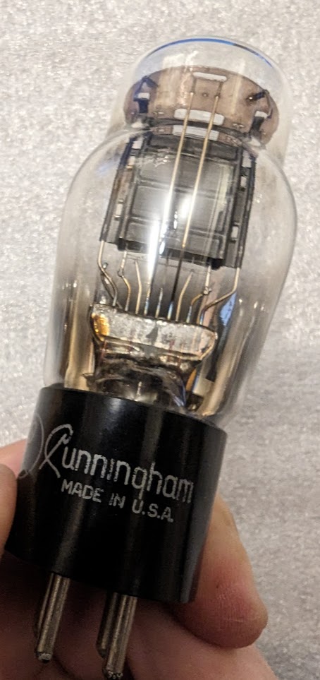

The physical construction of the 45 is interesting:
The grid spiral extends beyond the top of the plate, and beyond the bottom of the plate.
(I have National Union and RCA Cunningham 45 tubes).
The only other DHT that I have with the grid spiral extending above and below the plate is . . .
The dual plate Valve Art 2A3.
Your DHT grids may vary.

Double plate 2A3 is not correct in my opinion. The plate is still one but it has different shape (H-Shape) respect to the original single plate. The only double element is the filament (2 V-shaped filaments that form a W). The 6C4C (and the rare 2C4C with 2.5V filament) is the best technical implementation of the concept. Stronger, very durable and high performance. The Russians just made it better.

I am not sure what 2A3 tubes you were talking about in Post # 75.
Perhaps I misunderstood your statement "Double plate 2A3 is not correct in my opinion. The plate is still one but it has different shape (H-Shape) respect to the original single plate.
A 2A3 double plate may be made out of only one continuous piece of sheet steel, true.
But, that sheet of steel is first folded over one filament structure and one grid; and secondly folded over another filament structure and another grid.
In my book, that is 2 plates, even if they are made from only one sheet of steel.

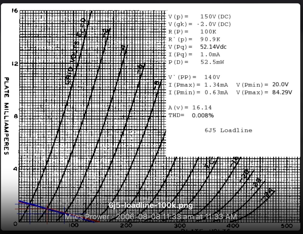

Researching 6SN7 operating points I came across this on another DIY audio post:
I believe the 6J5 is electronically equivalent to 1/2 of a 6SN7?
.008% THD. Seems this tube can be operated at fairly low voltages with pretty good results? Am I missing something? I am learning and much of this is still foreign to me. Hoping somebody can help break down some of these numbers for me…ie V(p) vs V(PP) and the rest.
Thanks all.
Thanks all.
It's worth remembering that valve curves are unreliable down near the edges. They weren't really measured down there, just sketched in with a French curve. You really can't believe them. Secondly, operation with the grid near 0 VDC means that some grid current will flow, more dramatically the nearer it gets to zero. Unless the valve is being driven from a zero impedance source, that very non-linear grid current will appear as a very non-linear grid voltage adding itself to the signal voltage.
Type 6J5, 6(and 12)SN7, 6CG7/6FQ7 are very linear amplifiers, but need to operate in their best range, which is much more volts and current than the drawn example.
