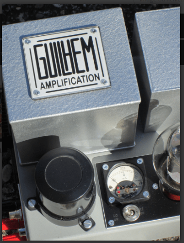

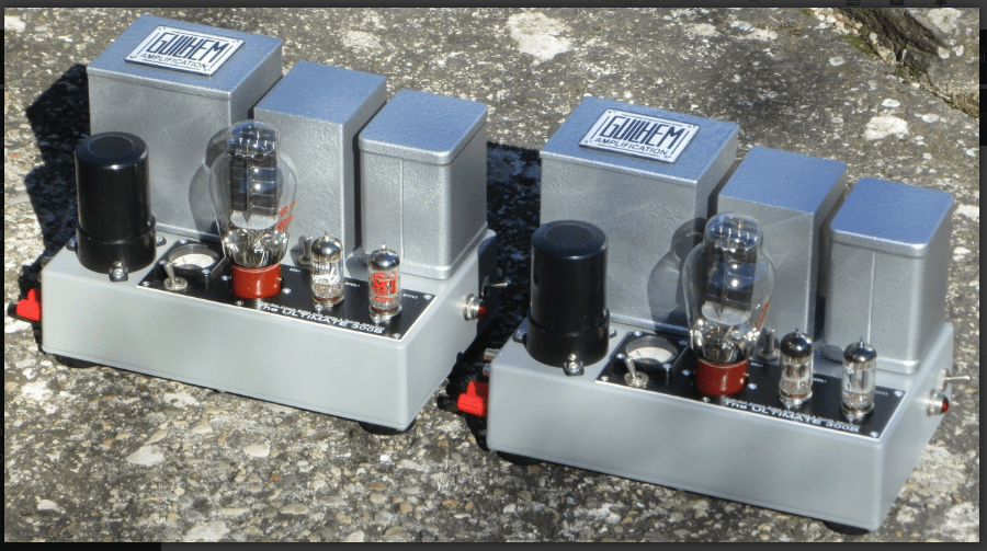

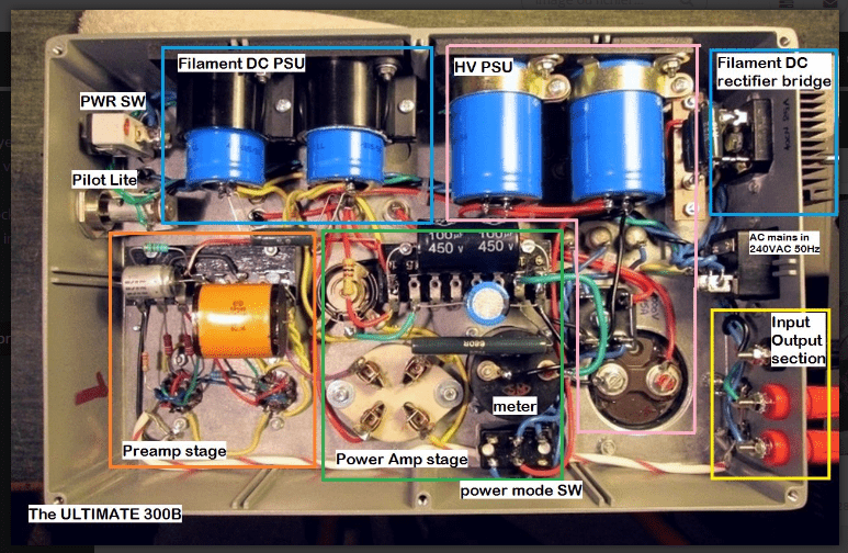

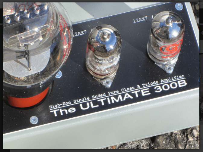

Really nice construction/wiring style. Will last for decades with once in every five year some new tubes.
Greetings Eduard
Thanks @eduard !
Yes, I built them in 2013 and the tubes are still the same today... The circuit supply offers two modes : Hi=8WRMS with B+=400V and Lo=4WRMS with B+=300V. Most of the time I use it in the Lo mode, hence the long life of the tubes.
