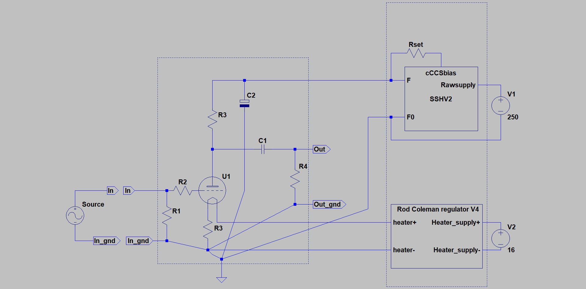

I would argue that audio analyzers are grounding, and help keep us honest, and that the fault is not in our stars Horatio, but in our assumptions and interpretations. We are a modelling species (and maybe all species are); we don't live in a "real" world, we live in our internal model of the external world. Keeping our models honest is a lifelong pursuit.

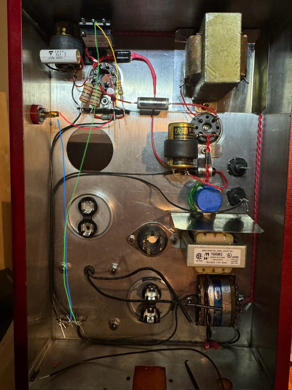

After installing 60uF motor run cap B+ dropped 6V. I know there’s no free ride, but this seems excessive.
I then paralleled the motor run cap with a 56uF electrolytic. B+ held steady…No measurable gain or loss. (Ripple at the speaker did drop another 0.2 mV)
I enjoyed the tinkering, however, would not likely do the motor run cap again. (May have been OK if PS voltage weren’t right on the edge already) However, I now have a one and three-quarter inch hole in the top of the chassis and seems stuck with it!
Wondering if going to a smaller value motor run cap, say 10-20 uF, and a larger electrolytic might help bring B+ back up?
Not an easy swap out, have to do a fair amount of disassembly to get to the motor run cap so hoping somebody here might offer some insight.
In the big scheme of things, B+ is still slightly up from where I started after swapping to a lower resistance choke, but would be willing to put a smaller motor run cap in if it is worth the effort.
Any thoughts?

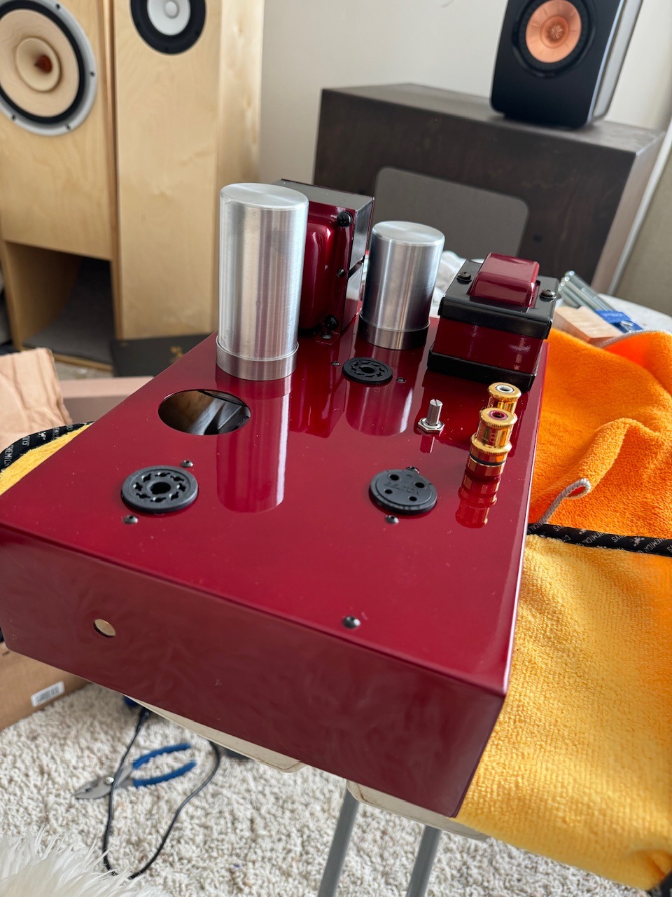

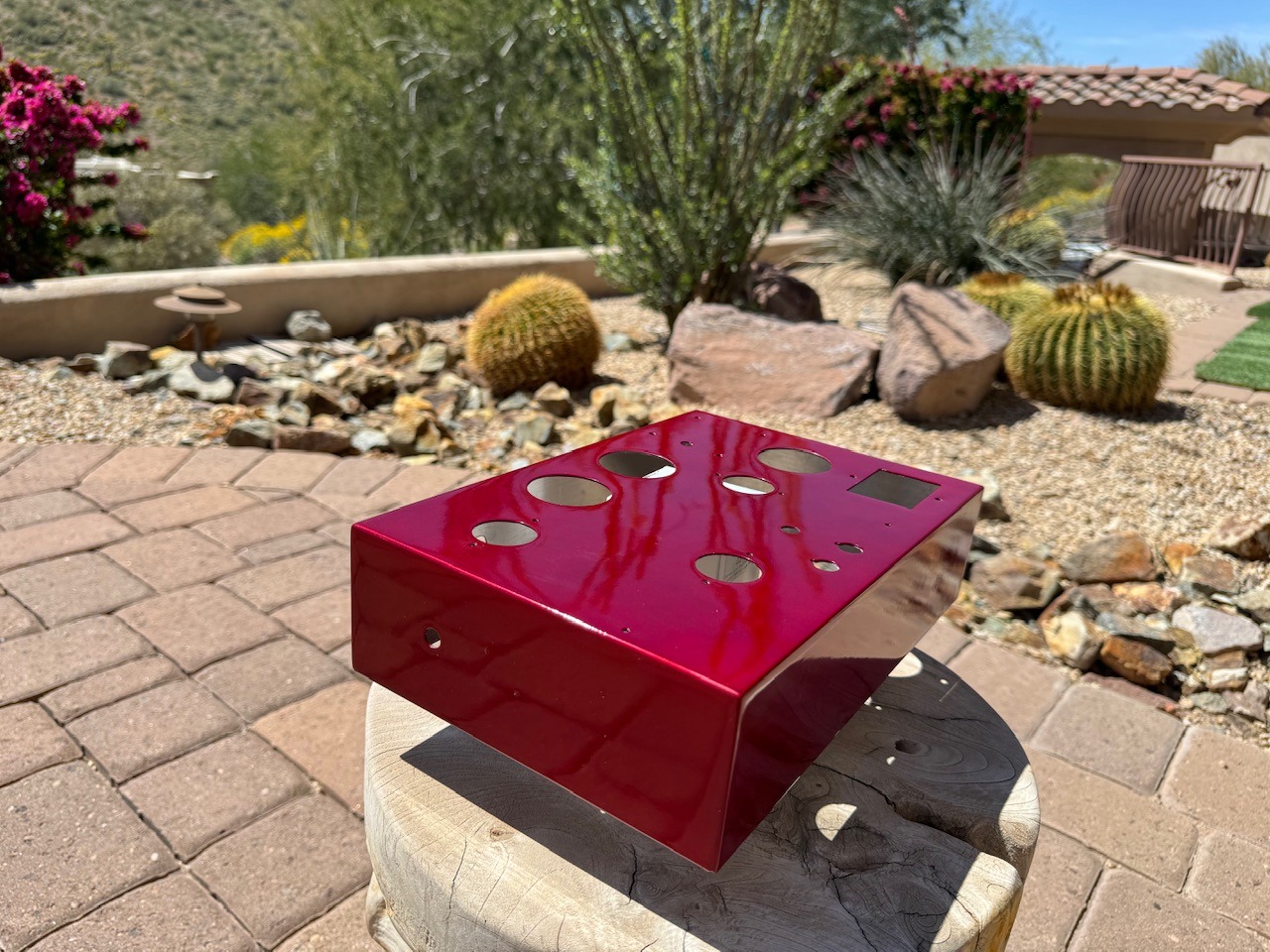

First off, I guess I’m a traditionalist when it comes to tube amplifiers. My preference is black in flat or hammered.
I went down the YouTube “auto paint” rabbit hole and wanted to test my DIY chops with something I had never attempted before…
Candy apple red with a 2K clearcoat… All from a rattle can.
I would advise against doing this unless you already have the tools, equipment and experience (or you just want the experience like me).
I probably spent more than it would’ve cost me to take this to a professional auto or motorcycle paint shop.
Still, not too bad for a rattle can and some buffing:
Some very minor flaws in direct sunlight, not perceptible at all inside. I still have one final stage of buffing to do which should clear even that up. (There are a couple of lint bits here and there in the photo. Those are on the paint… Not in it.)

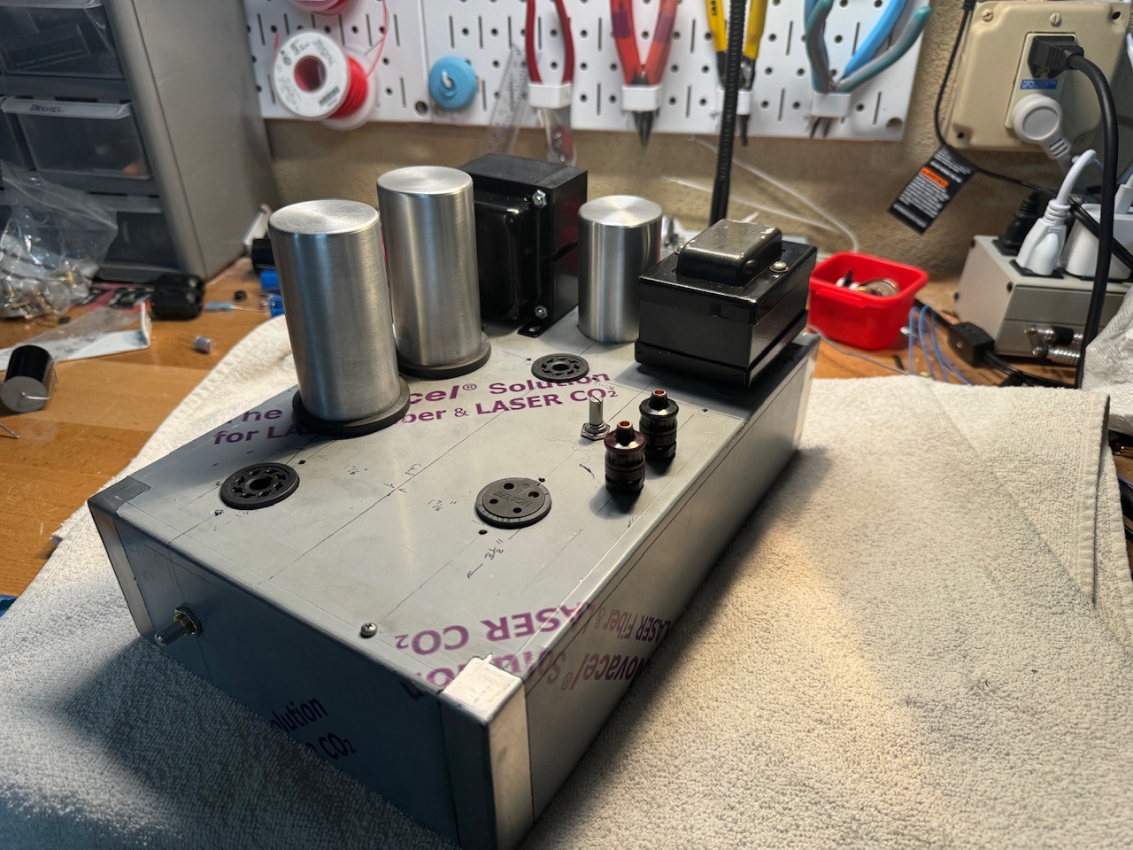

Hi all. working up to a 45 type build and hoping for some assistance.
Some background. I have built Elekit 8900 and 8600 kits. I have been wanting to build my own amplifier from scratch for sometime now. I’ve been watching online videos and read several books on tube amps. To be honest, having no electronics background, my head starts to nod when reading the books—much of it remains over my head. I have a long way to go but I’m slowly getting there.
Time to get my hands dirty and do some building. I learn more by doing than reading. Hoping the book info will make more sense as I go.
To ease into this project, I bought set of 45 mono blocks locally from craigslist with hopes of some simple upgrades and modifications. After this, I will embark on a new build from scratch.
Again, my knowledge is extremely limited, but I’m working on it. Please be patient.
I have poked through the amplifier and drawn up a schematic and measured the voltages. This looks like a possible 45 variant of the JC Morrison 300B design. Even with my limited knowledge, a few issues have already jumped out at me. The first cap in the power supply concerns me and the voltages on the 6SN7 seem low. I would like more voltage across the 45. Also the way the 6SN7 heater voltage has been raised seems unusual.
The knowledge in these forums blows my mind! Hoping to pick up just a little bit of it and enjoy this hobby. Looking for some specific recommendations on voltages and required resistor values to achieve.
Thanks!
EDIT: I am on step one of a two-step process. Step one being modifying the monoblocks on hand has a learning experience. The second step will be building a 45 from scratch based on what I learn in step one.
As stated above, I already own an Elekit 2A3 and 300B amplifiers and will be staying with a 45 build and modifying these monoblocks first.
These mono blocks are a pretty cool junk box type build with some cool vintage bits, but I suspect the builder used what was on hand for resistors and caps and there may be room for improvement. I am not going to do a complete redesign of these amps. I want to stick with the original design and drivers.
In a nutshell, I am looking for:
1. any obvious or dangerous design flaws (bleeder resistors, and such… I got a nasty shock 10 minutes after unplugging… No tubes installed. My bad. Fortunate I didn't kill myself...hope others can learn from my mistake. This **** is real.
2. more voltage across the 45.
3. increase voltage to the 6SN7 to get closer to a linear operating point.
All within the constraints of the current power transformer...ie. resistor and capacitor tweaks. Looking for improvement, not perfection at this point.
