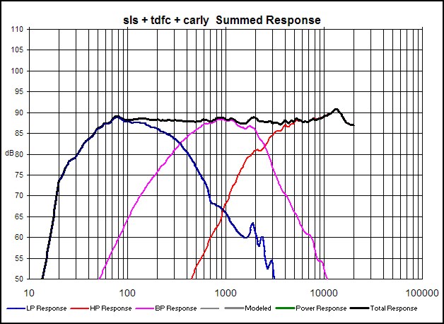

Hey Guys................
Its quite clear that there is a small problem around 2khz, on all drivers :bawling:
Fore simulation only
Try a "notch" on woofer first
Next, try 1.2-1.5ohm on midrange, instead of 1ohm
On midrange 14uF paralel, try a resistor to ground(-)
RC on tweeter
Fore perfection, maybe a "notch" on midrange
Maybe midrange series inductor(o.84mH) is too big ... a bit bigger series resistor(the last 1.2ohm) will turn it down a bit, bigger resistanse will make the inductor smaller and at the same time attenuate mids ... and maybe a resistor on the paralel 14uF
tweeter paralel inductor could be smaller with series resistor to ground
At this point it may be necessary to attenuate tweeter a bit more ... as it is a series resistor only it will change cap and inductor values a bit

Tinitus....Grant...........I studied the summed response chart after Tinitus' comments and see that nasty spike in the woofer at 2000 Hz..............I am gonna simulate some notch or contour filters this weekend to see if I can eliminate it...........This definately could be part of the culprit..........And as you pointed out Tinitus, I like your measured approach to Frankies ailments.............There is a good explanation of notch filters and contour networks in Dickasons Book.........It shows how to figure component parts based on the frequencies that need attention......I will study this and then experiment with my simulator....If I run into any trouble, I will inquire as to alternate methods of figuring out component values............Grant, I don't know for sure about the L pads, and due to this uncertainty, I am not sure whether they would adversely affect the impedance of the system or not.I will check out the links and study them...........And by the way......no, it was not a dumb comment............If you want to hear dumb, listen to this......You see that nasty spike in the woofer at 2000Hz?......I saw it before, but did not think that it would have any relevance to the crossover or sound..............I think I was mistaken.............I will keep you all posted............Omni
Good spirit, good teamwork🙂
Yeah, I guess we all noticed the problem, but didnt know either how significant it would be, and afraid to complicate things too much ... you might have lost your senses:bawling:
At least, now there is something to work with
Actually those abnormalities in the stopband is something I rate as exstremely important, but its only theoretical ... and what I think I might hear when I work with my speakers
But I remember a late mentor who claimed that the slopes should be under controll all the way down to -90db ... well, maybe this will prove it

I have some (very respectful! , of course! ) comments on your crossover and all the hard work you put into it, but (and the usual proviso...I could be wrong!) a couple of things don't seem quite right to me. I hope my comments are worthwhile to some extent.
I have just been looking at your SLS woofer 'raw trace' again and it has a 6dB peak from about 1600 to 1900Hz, so imho it will need a 2nd order parallel electrical and possibly a suitably configured Zobel to control it..
Whether 2nd-order(E) or a 'notch' or EVEN BOTH might be borne out only by simulations and listening/tweaking.
Anyway, I reckon get the woofer properly smoothed/rolled-off first! On second looks at your woofer network it doesn't seem to be Zobeled after all? It seems that you have a 'tweaking resistor' on your second order cap but no seperate Zobel as such?
I just reviewed your raw data SLS zma file and ( possibly quite rightly? ) it only goes to about 500Hz. * But *, shouldn't the zma plot 'track along' to the end of the frd plot for consistency in the program? Otherwise the FRD tools wouldn't know what the impedance is at say 2kHz where the woofer is still contributing to the response!
Onto the CA...I'm not sure why the 1 ohm resistor is there? To me it IS attenuating... so shouldn't it be added to the 1.2 ohm in that spot? A total 2.2 ohm attenuation might not need an Lpad here, just series Rs. I'd have to check that 'Lalena' site and possibly sim it. The raw CA15 Z plot looks like it could do with a Zobel as well.
Sreten and Tinitus would know this stuff!
The TDFC isn't Zobeled and imho doesn't need to be. I have looked at all 3 drivers overall 'raw-in-box' response plots, and the TDFC is sitting on about 90dB, the CA15's IN BOX response has that dreaded peak/dip...about 90dB at 700Hz down to about 82dB at about 1800?Hz which combined with the woofers peak at about the same frequency is partly (secondarily to 'xo wandering') causing you problems. The Peerless final response of an in-box 6dB rise at 1900
together with the CA15's dip of 8dB from 700 to 1800 is a problem but fixable! .....Yay, good news!!!!
The perceived ( by me ) 'wobbling xo-point' seems fairly straightforward too, well to me at least. This would certainly explain
Frankie's 'voice-change'! So mate, I think no 'dramas', just a couple of things to address and hopefully Frankie will sing beautifully!!!
Regarding the dreaded peak/dip in the CA15's 'in box' response, due to BStep/diffraction.... the filter I suggested many 'pages' ago,
umm, maybe its worth a try? It does seem very effective. More parts count though.

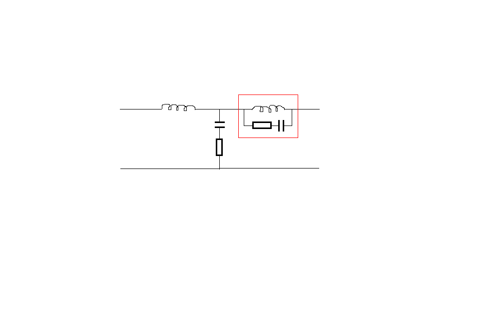

Again, this is how I have done my bass lowpass ... the part framed in red really makes wonders ... looks a bit like a bypassed 18db with adjustable attenuation on the paralel C and last inductor ... ofcourse it will have some effect on phase, and on my speakers its only positive

Grant..........A lot of the issues you brought up are definately thoughts that I have entertained during the simulating phase in Bagbys simulator...........You are correct: that is not a zobel on the woofer and it is indeed a tweaking resistor on the shunt cap as per Tinitus' suggestion to experiment with series resistors on parallel components..........What this did was smooth the rolloff characteristics of the woofer without adversely affecting the overall response..........It did wonders to make the rolloff more rounded and create a smoother scenario at the crossover point.........As you probably recall our trepidation pertaining to a zobel on the woofer based on the concern that impedance may be lowered too much, thus causing an excessive, and possibly damaging strain on the amplifier...........I will have to review my woofer zma raw data..........That 1 ohm resistor you mention, and its' placement was strange to me too.........However, after multitudes of simulations, placing resistors in differing locations, this was the topology that rendered the smoothest summed response.........I studied a lot of writings on crossover topology, and found that differing topologies with the same components can render differing responses......Bagby, in his correspondance to me, suggested that I be open to all different kinds of possibilities when working with the simulator, and that some amazing results can be achieved with some bizarre component combinations.............As to the placement of that 1 ohm resistor, my { uneducated } guess is this: It probably affects the midrange signal from that point on..........having an effect on the characteristics of the rest of the crossover, because it comes so early in the topology....This was the topology that provided the smoothest overall response, so I kept it there...........That pesky little dip..............Man, this is what we have been battling with from the start.............The amazing thing is this: I am encouraged by the fact that even though Frankies' sound isn't quite spot on yet, he does sound very good as he is, without any response shaping circuitry.............Had I had the foresight and knowledge earlier in the process, that I have subsequently gained, and put it into use designing Frankie, things might sound different..........However............I am not discouraged, by the fact that you guys are here, keeping me on my toes and providing insight on how to deal with it..........Van Gogh is known for his thick impasto painting techniques..............I bet there are plenty of mistakes buried underneath his heavy top layers..........I am going have to search for the filter you suggested, but if I can't find it can you tell me what page it is on? I am open to all the possibilities...........Tinitus, is that a parallel trap filter you show here, situated on the woofer leg, and how did you determine component values..........I have not gotten back on the simulator yet, but the weekend has just begun...I have got a little research left to do yet, but from there, it's on to the simulator.........I will report my findings, probably tonite.......................Omni
Tinitus..........I did some initial research on the notch filter in Dickasons' book and attempted his calculations, then inserted the results into my simulator, but got no tangible results............So I did a search on this furum and found a FEW threads addressing the subject, but again no actual methodology as to how to get a reference starting point for component values...........I will do a web search to try to find the information................In the meantime, I created a new thread here on the forums, and also included Frankies' response graph in the hope that more people will see the problem Frankie faces, and offer up their expertise..........Hopefully the graph will provide readers with some concrete data from which to draw............Another thing I did do with the simulator, was throw caution to the wind and started simulating with far out numbers, and got some movement on the graph, but it required me to change the series resistor on the shunt capacitor to 7 ohms.............However, the problem here was that this change really took the woofer impedance graph way out of whack...............Not like anything I have ever seen before...A bit scary................How would you think that I proceed?........The other changes you mentioned in an earlier post don't seem to be daunting, and I think they will be able to be accomplished without too much difficulty, judging that the other anomolies don't appear to be as radical as those spikes in the woofer stopband...........But I definately agree with you that the woofer problem must be addressed, and it seems to me that the wise thing to do here is to address it first, before making any other changes.......Do you agree?............................cheers and hopes...................Omni
